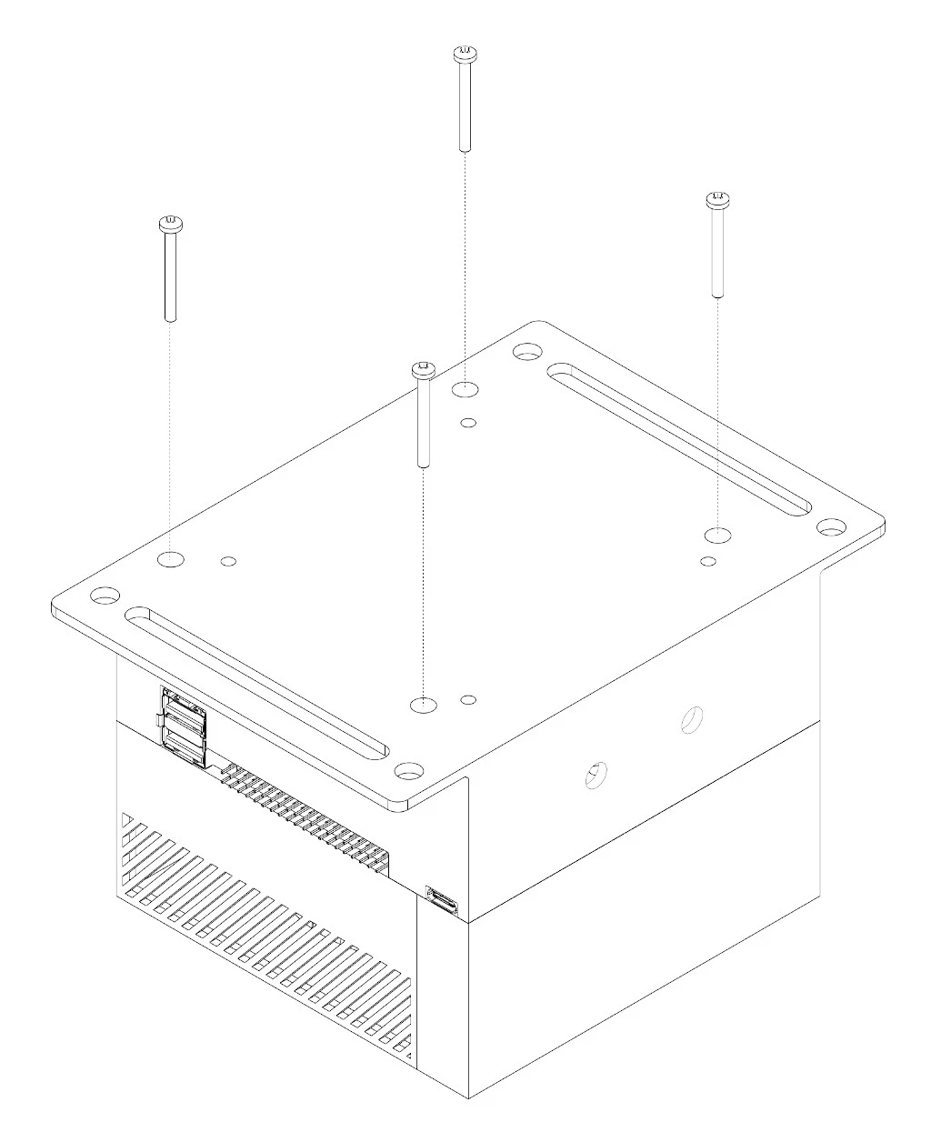

AGX Orin Developer Kit Enclosure
If you are using an AGX Orin Developer Kit, we recommend you use the Enclosure for the AGX Orin Developer Kit available for purchase on the StereoLabs store, to securely integrate our GMSL2 Capture Card while keeping the electronics safe. It also allows you to mount the Dev Kit on any surface using VESA 75x75, and gives the possibility to add WiFi antennas to boost your AGX Orin wireless transmissions.
Installing the AGX Orin Enclosure
