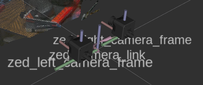

The ZED ROS 2 Wrapper internally uses the sl::generateVirtualStereoSerialNumber ZED SDK API function to create a unique serial number identifier for the custom stereo rig based on the serial numbers of the two connected cameras. This allows the node to correctly identify and utilize the stereo configuration during operation.
It is not required to pass information about the baseline distance between the two cameras to the launch file or to the node, as this information is automatically retrieved from the calibration file and used by the ZED ROS 2 Wrapper node to set up the TF frames accordingly.
