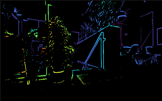

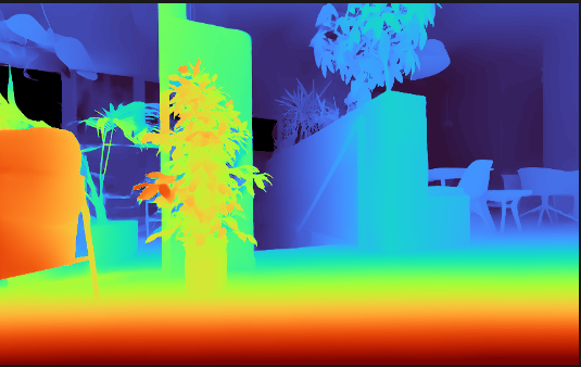

To filter out unreliable points from the depth map or point cloud, you can either implement your own filtering function using the retrieved confidence data, or simply set the sl::RuntimeParameters::confidence_threshold parameter. When you set this threshold, the ZED SDK automatically removes all points with a confidence value higher than the specified limit, streamlining the process and ensuring only reliable depth data is used.
Two different types of confidence thresholds are available:
  • confidence_threshold: Filters out depth points with low confidence, primarily removing unreliable measurements around object edges. This helps prevent objects that are close together from appearing “linked” in the depth map.
  • texture_confidence_threshold: Filters out depth points in regions with low image texture (uniform or featureless areas), where depth estimation is less reliable due to insufficient visual information.

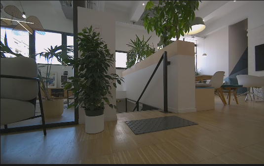

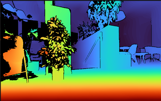

ImageOriginal Depth
RGB image of officeDepth map of office
confidence_threshold set to 50texture_confidence_threshold set to 50
Depth with confidence thresholdDepth with texture confidence threshold
