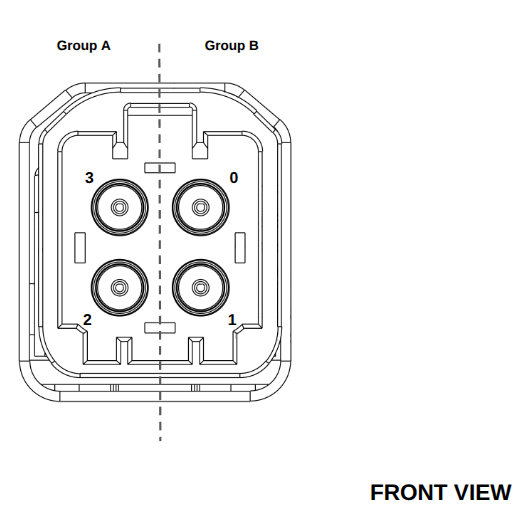

ZED Box Orin with 4-wire GMSL2 connectivity
The ZED Box Orin provides 4 GMSL2 ports organized in 2 Groups (A, B):
