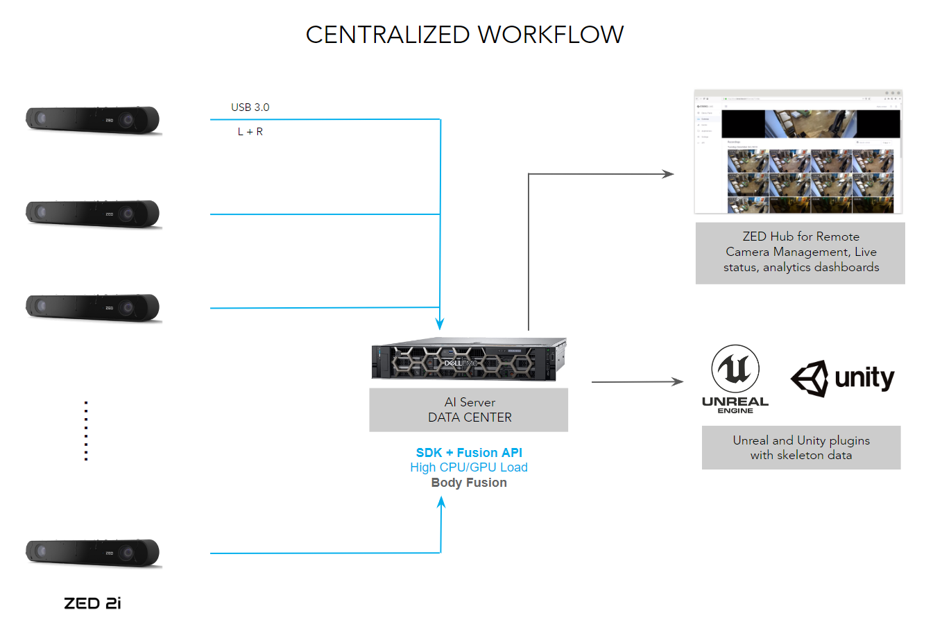

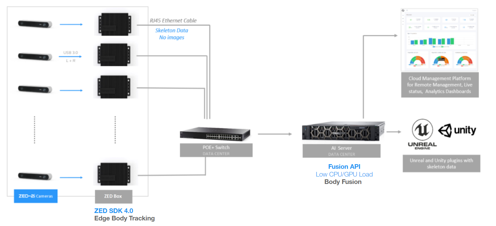

Workflow
To support most setups, the Fusion API can operate with two different workflows:
The Fusion module is lightweight (in computation resources requirements) compared to the requirements for camera publishers.

For a local workflow when all the cameras all connected to the host machine, the code samples provided above are sufficient. However, an extra step is required when the cameras are connected on different machines on the local network.
Setting up a network workflow
Each camera must run a streaming app that will compute all the required data and send it to the fusion server over the local network. This task can be performed with the following code :
Body Tracking Fusion Sender
The most important part is the call of the startPublishing method. This sets this SDK instance as a “Fusion data provider”. By default, the data will be streamed on the port 30000 but it can be changed with the CommunicationParameters data structure. This can be useful if multiple cameras are connected to the same PC. In this case, each instance must use a different port.
