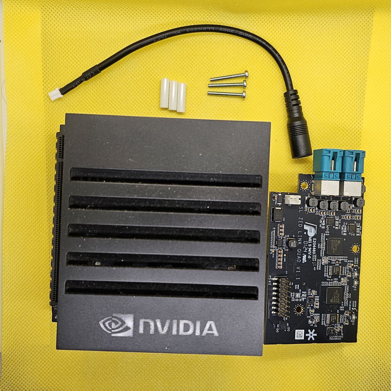

  • 1x NVIDIA® Jetson™ Xavier AGX Developer Kit.
  • 1x ZED Link Quad GMSL2 capture card
  • 2x 1-to-4 GMSL2 Fakra Male to Female cable (included in the box)
  • 1x NVIDIA® Power supplier to power the Development Kit (included with the devkit)
  • 9V-19V (min 6W) power input (Barrel Jack 5.5 mm outer diameter, 2.5 mm inner diameter) to power the GMSL2 capture card (not included)

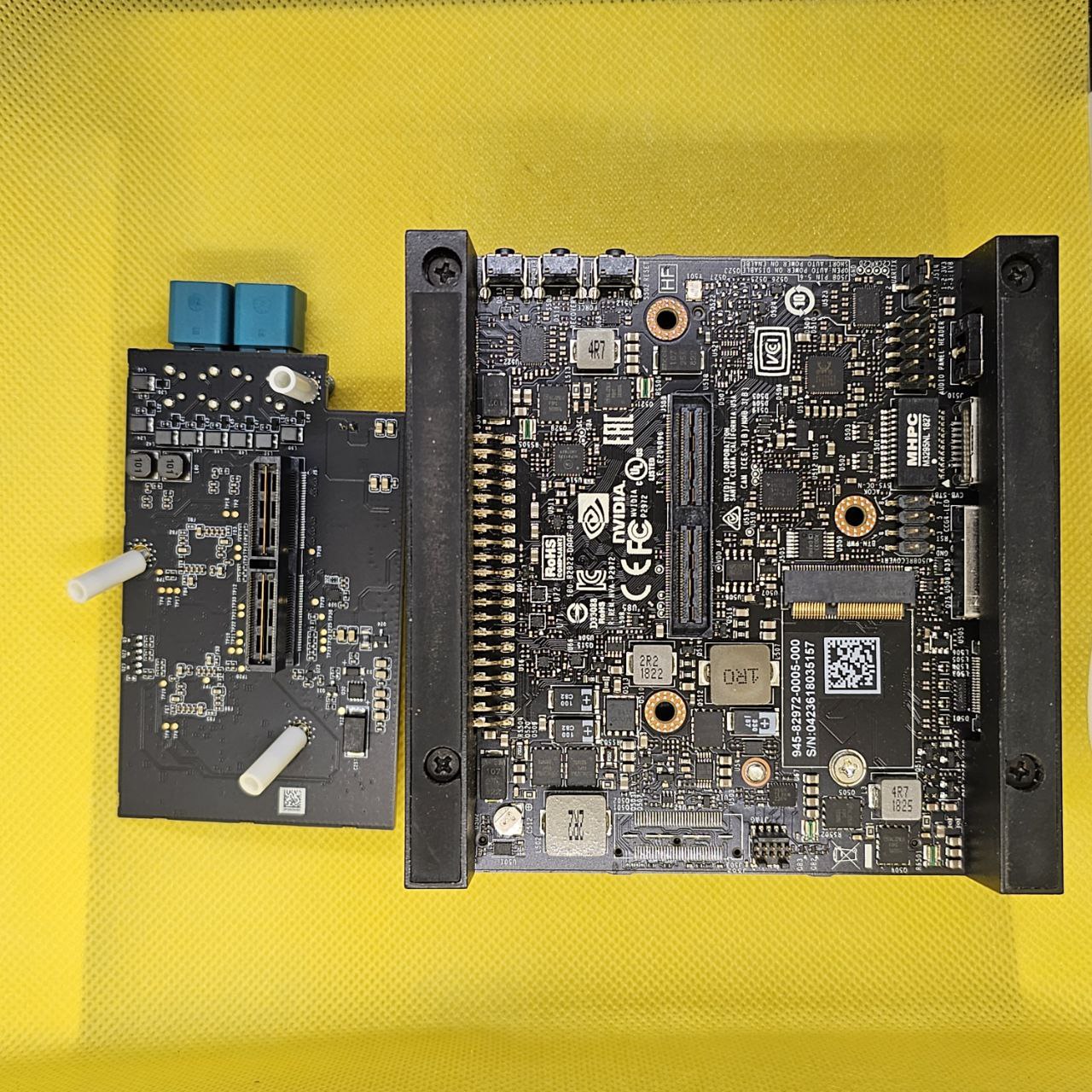

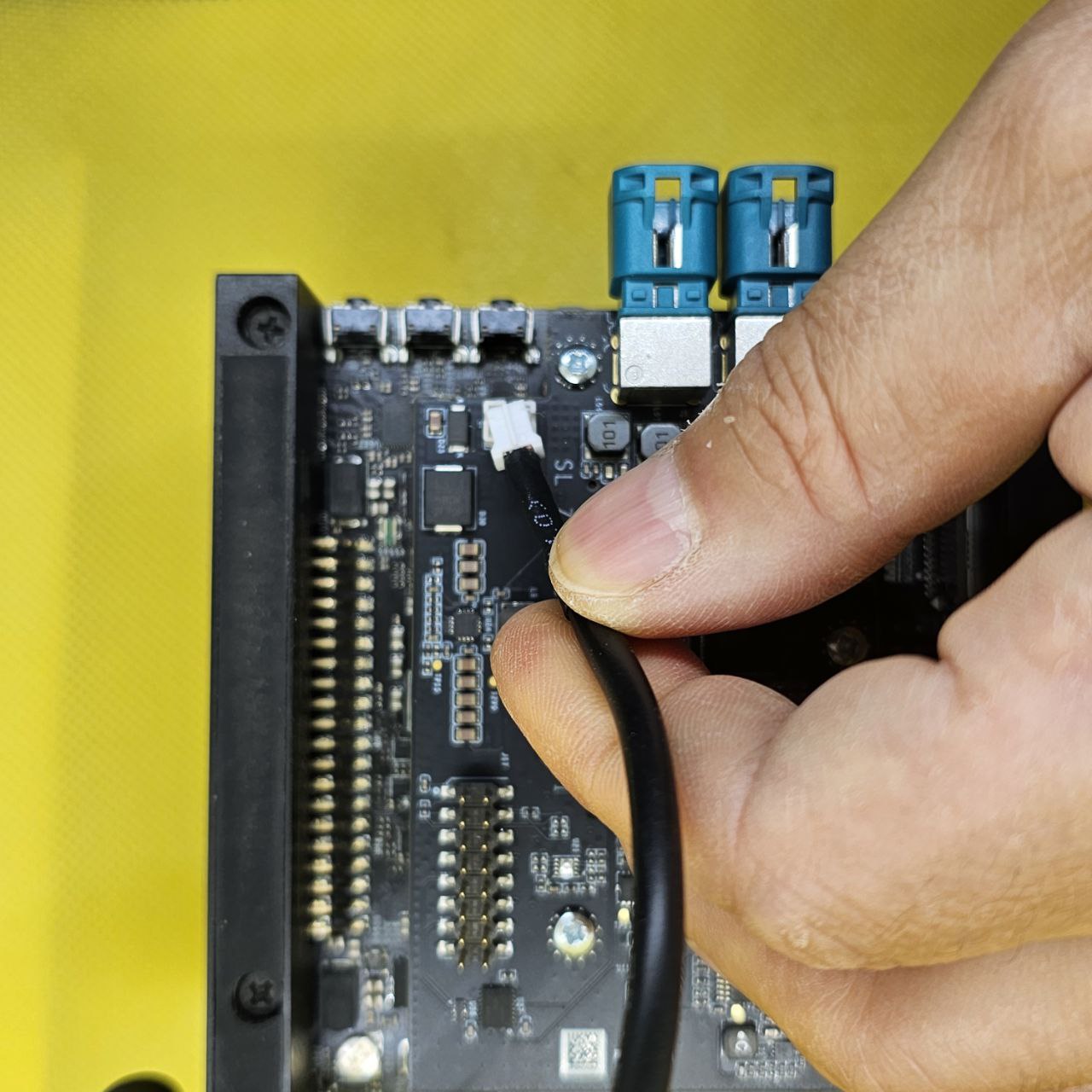

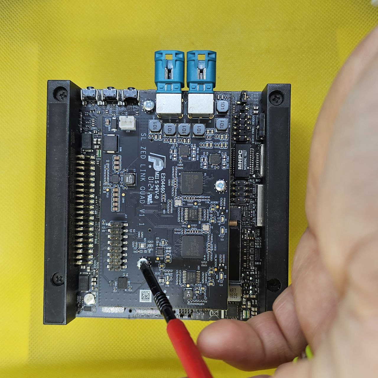

Plug in the capture card in the ‘Camera connector’ slot and fix it by using the three provided screws:

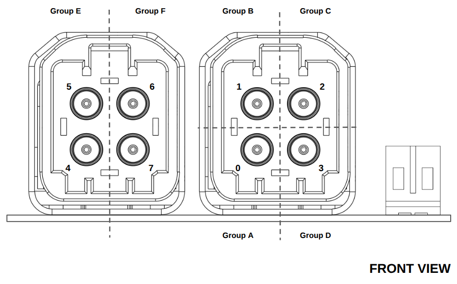

Multi-camera configurations
  • Group A: port #0
  • Group B: port #1
  • Group C: port #2
  • Group D: port #3
  • Group E: ports #4 and #5
  • Group F: ports #6 and #7
per Group
Max Resolution/FPS
per Group
MonocularZED X One GS
ZED X One S
Up to 2 camerasHD1200@60fps
HD1080@60fps
SVGA@120fps
MonocularZED X One 4k1 camera
only to port #4, #6
4k@15fps
HD1080@60fps
SVGA@60fps
StereoZED X
ZED X Mini
1 CameraHD1200@60fps
HD1080@60fps
SVGA@120fps
StereoZED X
ZED X Mini
Up to 2 CamerasHD1200@30fps
HD1080@30fps
SVGA@60fps
MixedZED X One GS/ZED X One S
ZED X/ZED X Mini
1 ZED X One GS/S + 1 ZED X/MiniHD1200@60fps
HD1080@60fps
SVGA@120fps

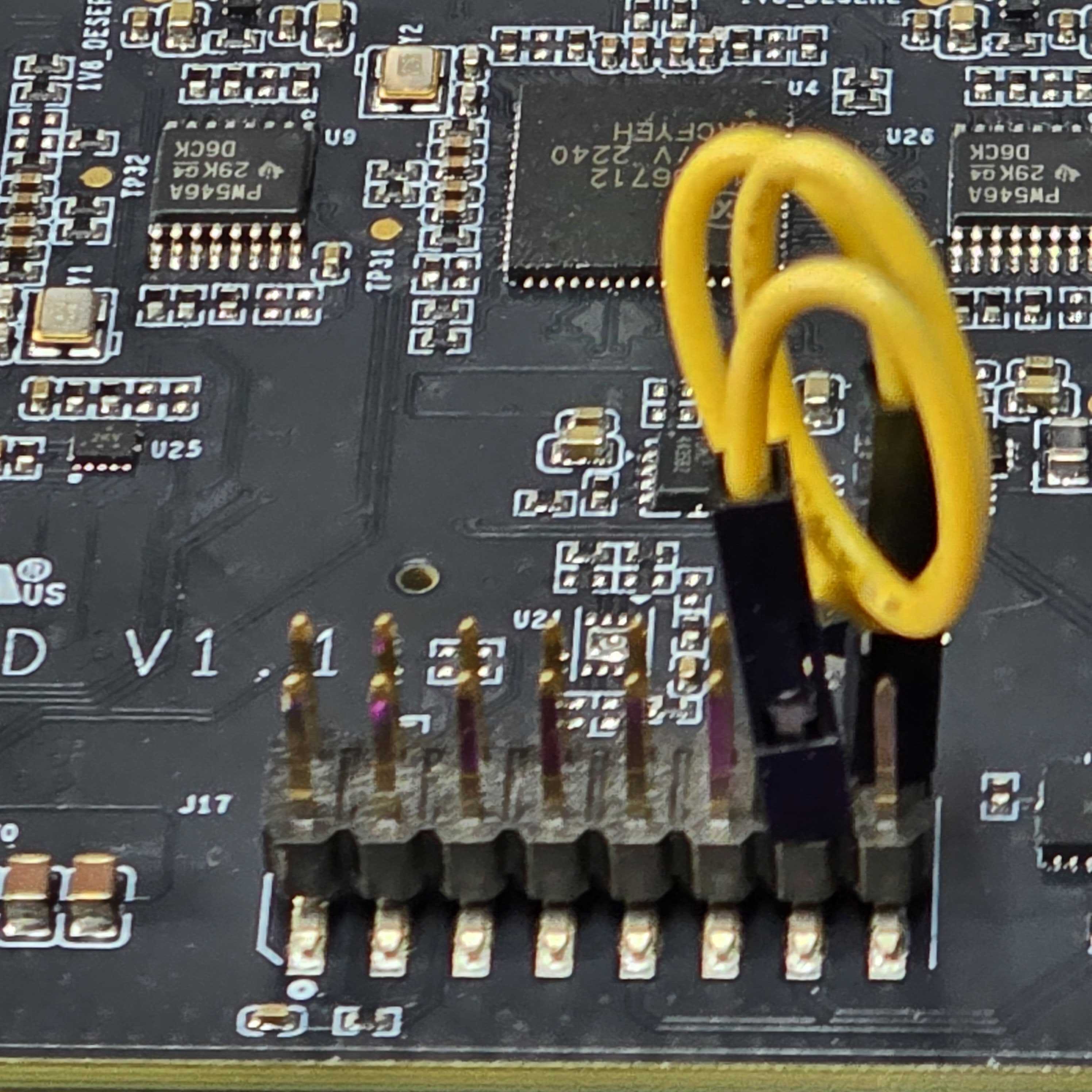

  • Connect the pin #13 to the pin #16 of the synchronization connector.
    It’s not required to connect the GND pins together as they are already connected internally on the board.
