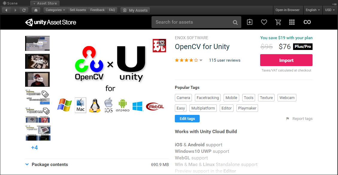

The fastest way to use OpenCV within Unity is to use Enox Software’s OpenCV for Unity package on the Asset Store. You can use the free trial version for the tutorial, but you won’t be able to build a standalone app.
Download and import the OpenCV for Unity package. You won’t actually touch these assets during the tutorial - they are required for the marker detection scripts in the ZED Unity plugin to work. These scripts are excluded from compilation when the OpenCV for Unity package isn’t imported.

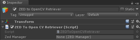

  • Create an empty GameObject, rename it “ZED to OpenCV Retriever” and add a ZEDToOpenCVRetriever component to it.

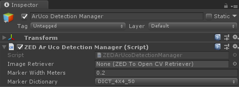

  • Create another empty GameObject, name it “ArUco Detection Manager” and add a ZEDArUcoDetectionManager component to it.

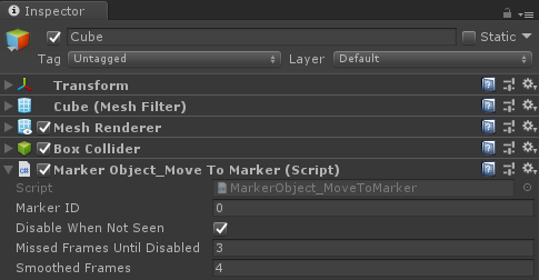

  • Create a cube object and add a MarkerObject_MoveToMarker component to it.
The Marker ID value in MarkerObject_MoveToMarker. It’s 0 by default - this tells it to detect ArUco marker of index 0, which corresponds to the one you are displaying (aruco_4x4_0). If you use a different marker, you will need to change this value.

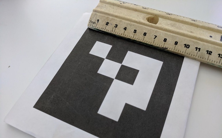

OpenCV does not use the ZED’s depth features to determine the 3D position of a marker. It compares the known size of the marker to its size in a given image frame. Therefore, we need to tell it how big the marker is for it to calculate the position accurately.

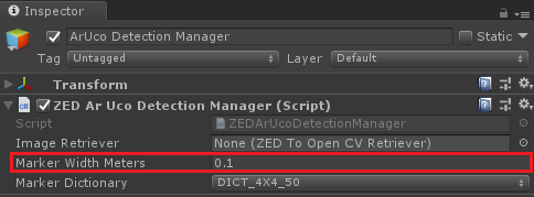

  • Get a ruler with centimeters on it and measure the width of the marker.
  • Select the ArUco Detection Manager object you made earlier.
  • In the Marker Width Meters field, put that measurement in meters (1cm = 0.01m)
If displaying the marker on a screen, be careful not to zoom in/out after you measure the marker. This will cause OpenCV to think it’s closer or further from the camera than it really is.

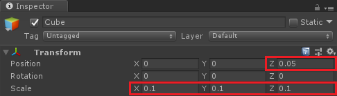

  • Create a Cube object as a child of Marker Cube
  • Set the X, Y and Z values of the Cube’s Scale to match the width value you put in ArUco Detection Manager
  • Set the Z value of the Cube’s Position to be one half of that width value
We adjust the Z position because objects are oriented such that the Z axis is pointing outward from the face of the marker.
