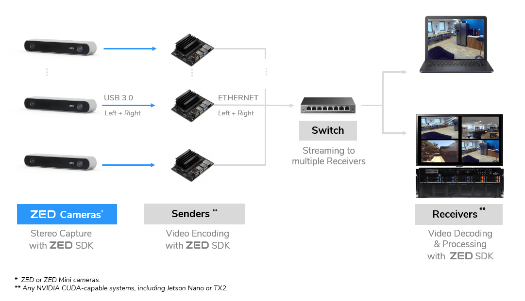

Multi-Camera Stream from Different Hosts
It is also possible to stream video from several cameras connected to edge computers or gateways. Below is an example workflow. image
In this configuration, the Senders are responsible for encoding and streaming an attached ZED’s video via the local network. On the other side, the Receivers read the stream and process the images using the ZED SDK. Therefore, the Receivers also require an NVIDIA® GPU for NVENC decoding and SDK use.
Both the Senders and the Receivers must be connected to the same local network. For improved bandwidth, connect the Senders and Receivers via Gigabit Ethernet instead of Wi-Fi. All ZED 2, ZED and ZED Mini cameras support Streaming with the ZED SDK.
