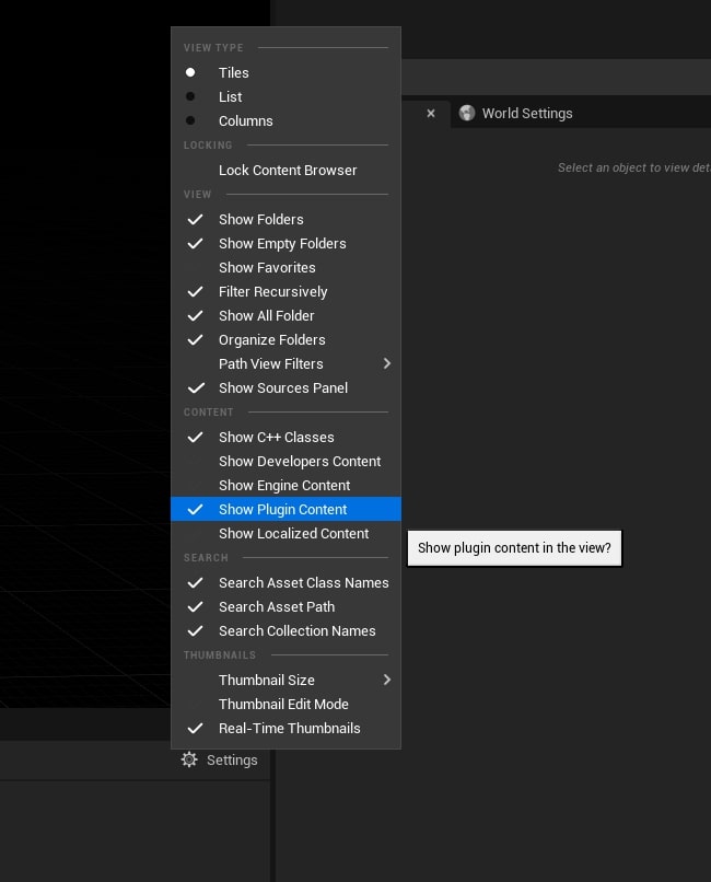

Now we’ve got to add a Blueprint from the ZED plugin. But by default, Content from plugins is hidden. To fix this, click on View Options at the bottom right of the Content Browser and enable Show Plugin Content.

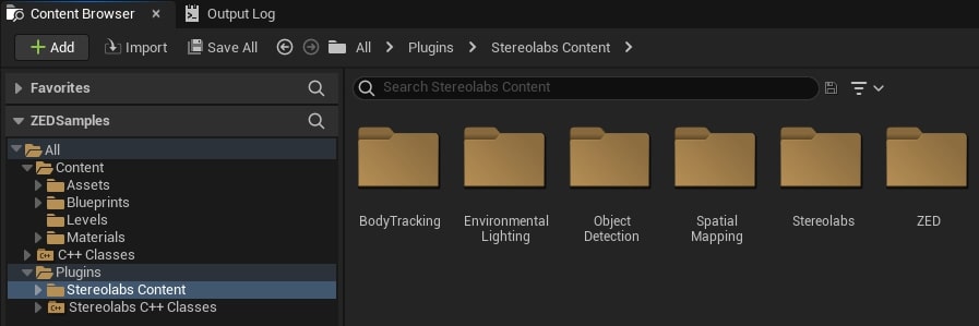

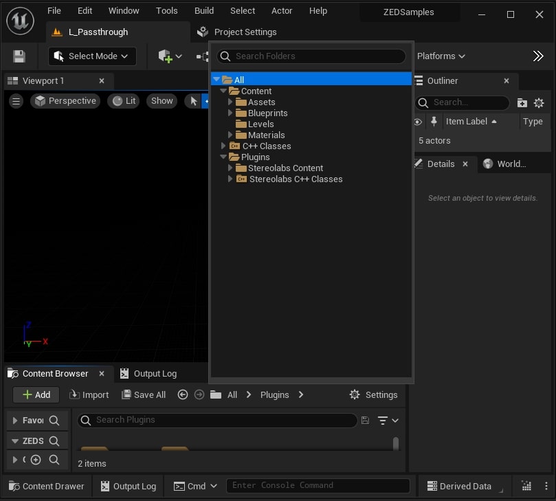

Now click on the folder icon beside Content and click on StereoLabs Content to switch to the plugin’s content folder.
In the Content Browser, go to Plugins -> Stereolab Content -> ZED -> Blueprints and drag a BP_ZED_Initializer into the scene. This is the object that sets up your camera and handles communication with your app.

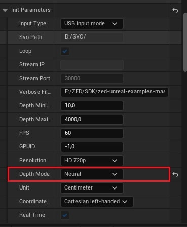

  • In the Init Parameters section, set Depth Mode to NEURAL. This mode is mandatory in order to have accurate background subtraction.
The NEURAL depth mode is AI-based, therefore the AI model has to be downloaded and optimized when using this mode for the first time. If it has not been optimized yet, the plugin will start the optimization itself. It can take some time so we recommend using the ZED Diagnostic tool to optimize it beforehand.

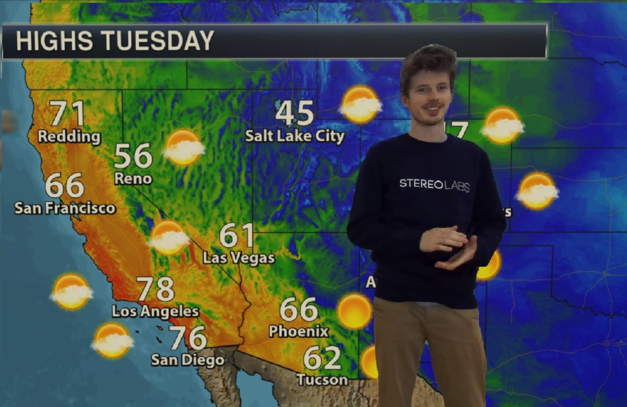

  • Adding a virtual object closer to the camera than the background. That’s what is done for the Weather forecast demo. A plane with a weather map place on it is added in the scene, just behind the person.
