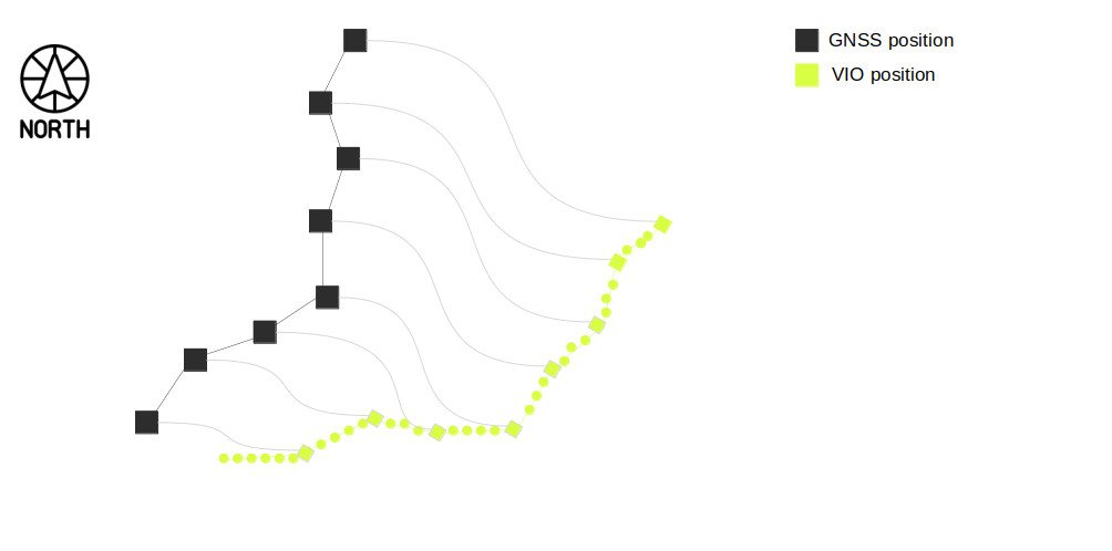

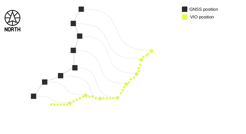

The differences between the VIO and GNSS trajectories of the same moving agent are illustrated in the following figure. It is important to note that these trajectories have different origins, highlighting the need for alignment between the VIO and GNSS systems. Please also note that synchronized GNSS / VIO data pairs are linked by a thin gray line.

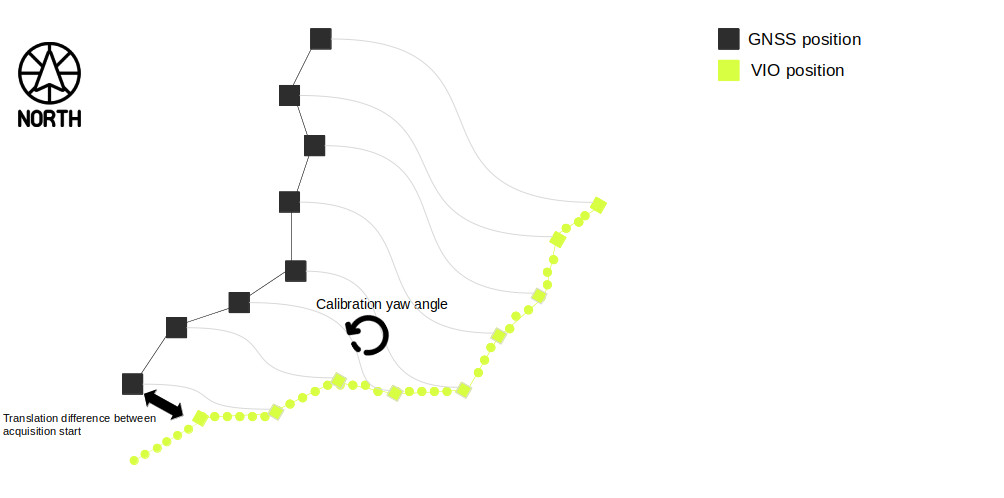

The VIO path sent for fusion is consistently aligned with gravity. As illustrated in the following figure, aligning the VIO and GNSS systems requires determining 4 parameters:
- The yaw rotation (1 parameter) between the GNSS coordinate system and the VIO coordinate system.
- The translation (3 parameters: X-Y-Z) difference between the start of VIO acquisition and the start of GNSS acquisition.

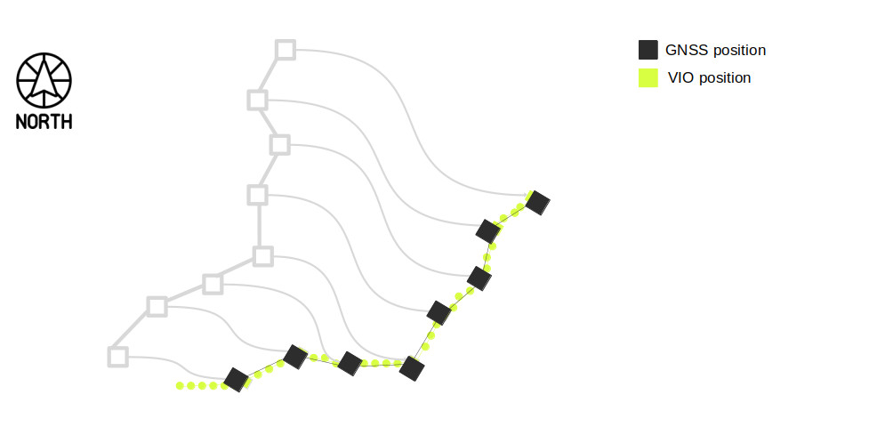

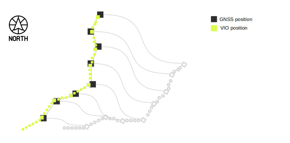

Once calibrated our fusion module is able to project the GNSS into VIO or vice versa. The left figure illustrates GNSS projected on VIO and the right figure illustrates VIO projected on GNSS.

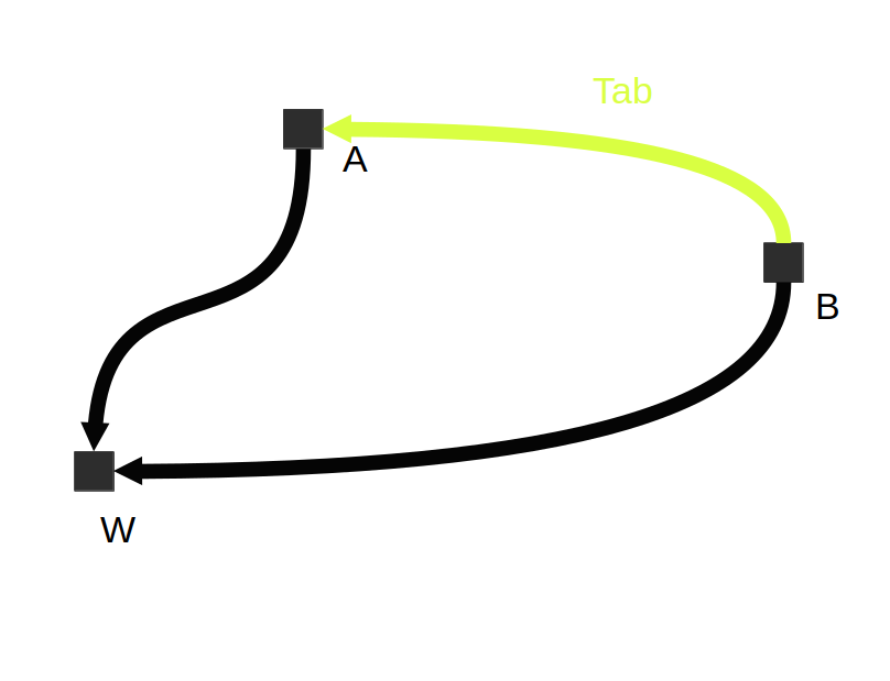

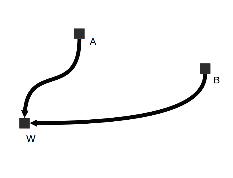

In all our schematics, the transformations are expressed in a coordinate basis mean. Let’s explain this. Let’s suppose that you have two coordinate systems A and B. Each coordinate system could be related to each other thanks to another coordinate system named W following the schematics below:
The transformation matrix that allows a coordinate system change between B and A could be defined as Tab = inverse(A) x B:

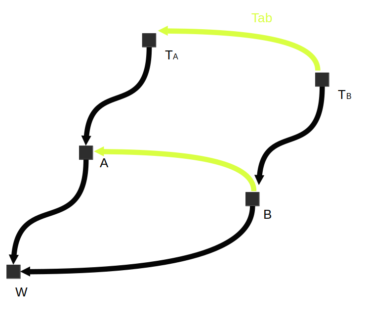

Let’s now consider a transformation expressed in coordinate system A, noted Ta, and the same transformation expressed in coordinate system B, noted Tb, following the schematics below. The link between these transformations could be noted as:
and

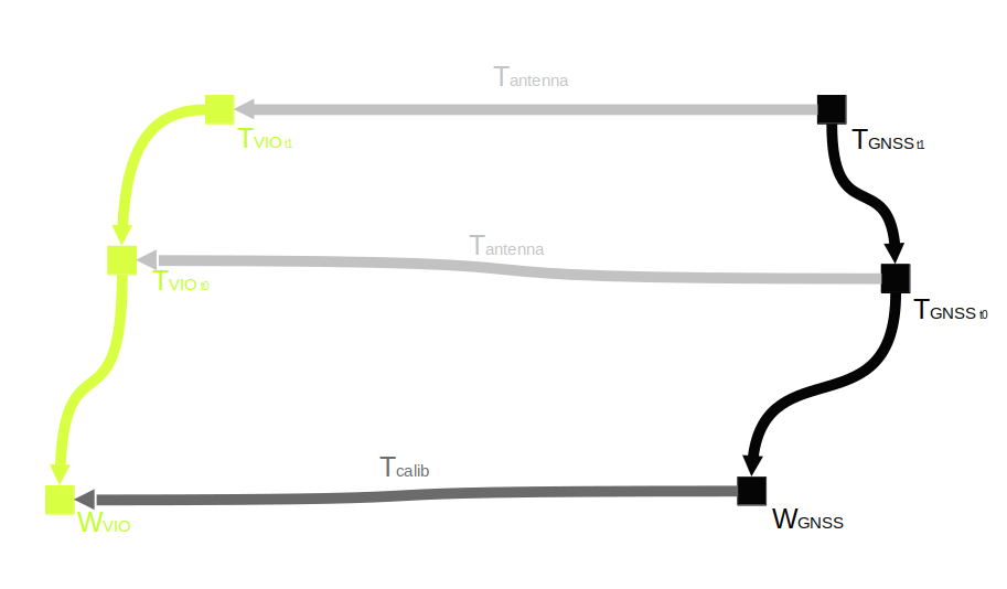

Following our definitions above, we could define the VIO and GNSS coordinate systems and establish the link between them. This is expressed in the schematics below. The Tcalib transformation is what is estimated by GNSS / VIO calibration. It could be retrieved thanks to getGeoTrackingCalibration method.
On the other hand, the Tantenna transformation is provided thanks to the gnss_antenna_position parameter. If it is not specified, it will be set to identity.
With the help of the schematic above we could define the link between GNSS and VIO:
These formula are helpful for understanding what it is done under the hood.
However, in practice please use Camera2Geo and Geo2Camera functions that project VIO or GNSS into the requested coordinate system.
