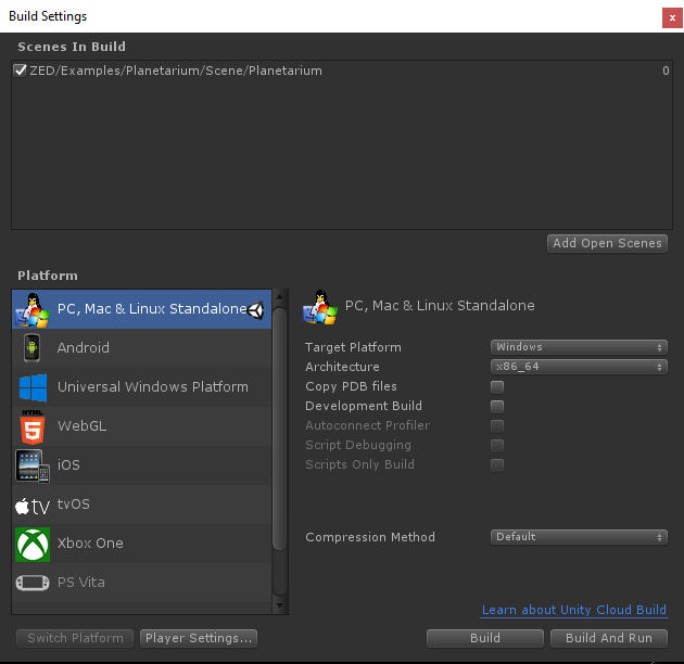

Build Settings
To build an application with the ZED SDK, you need to make sure the target platform is set to x86_64 in Unity build settings.
  • Click on File > Build Settings
  • Set Target Platform to Windows and Architecture to x86_64.
  • If there are no scenes listed under “Scenes In Build”, click Add Open Scenes.
  • Click Build And Run to generate the executable and automatically launch it.

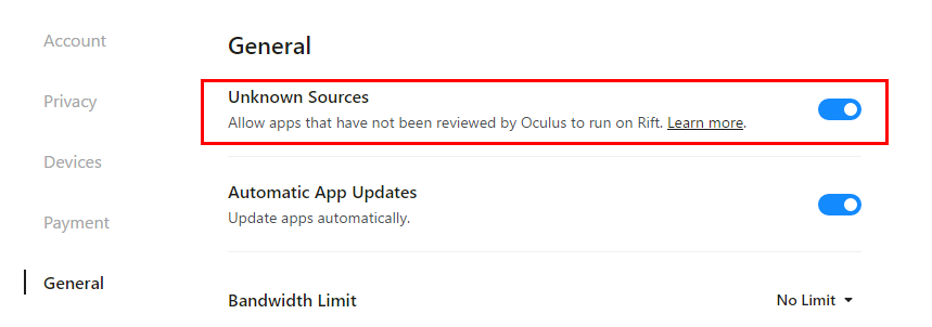

Oculus Rift
To run your application on Oculus Rift, you must also allow apps from unknown sources to run:
  • Launch the Oculus App
  • Go to Settings > General and allow Unknown Sources.
