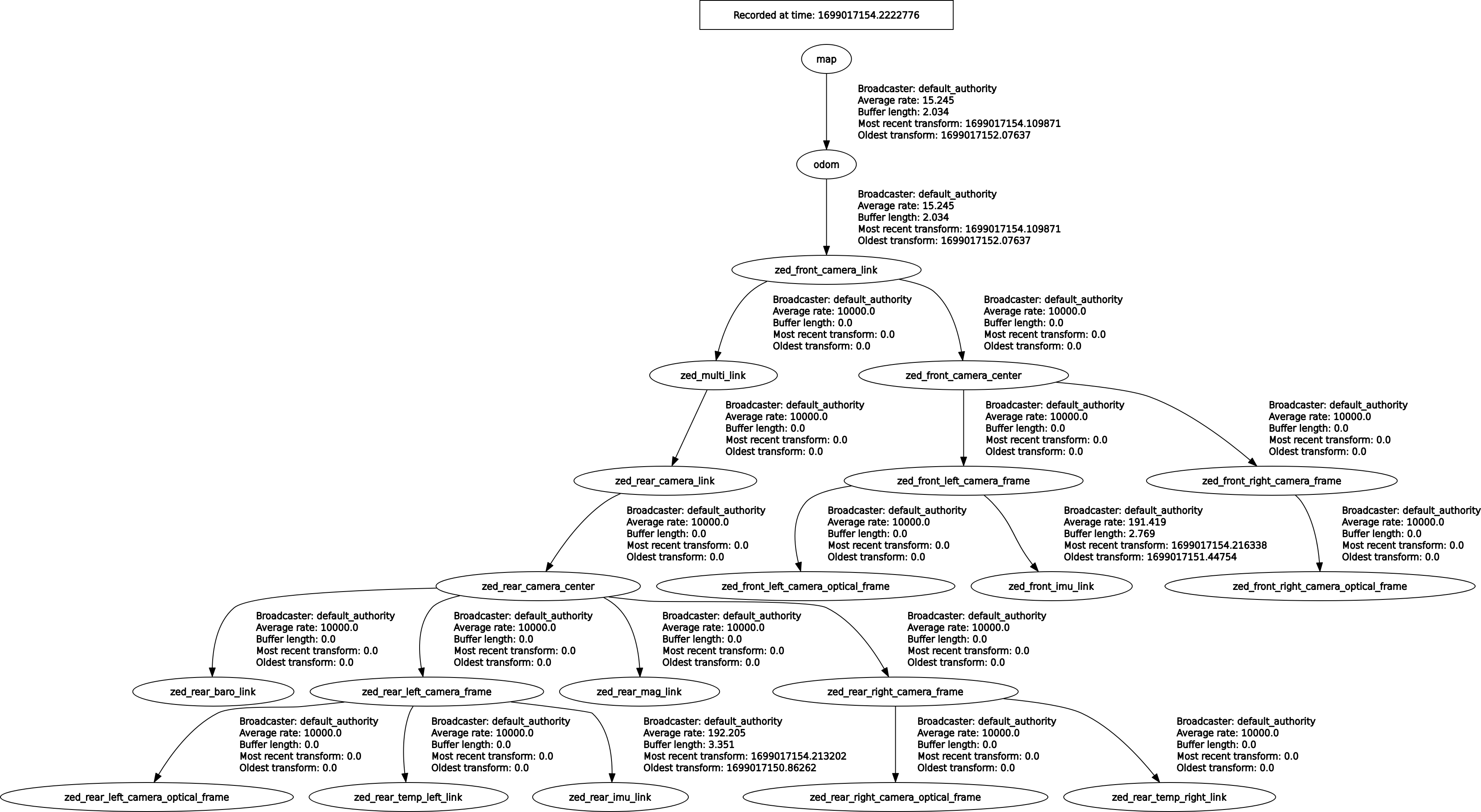

Important: the first joint has parent link and child link inverted with respect to all the other joints. This is required because
the first camera is the reference for visual odometry processing and in ROS a joint cannot have tro parents.
The following image display the TF tree generated for the dual camera configuration of this tutorial:
