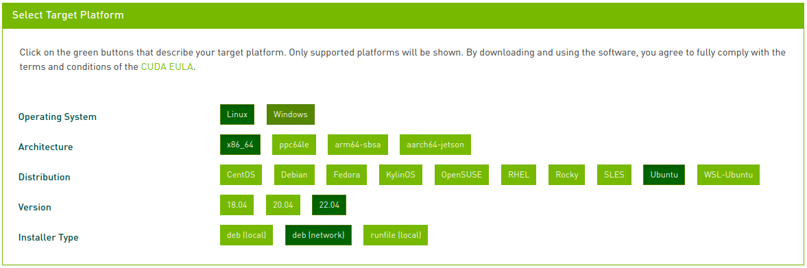

  • Download and install CUDA from the CUDA Toolkit archive.
  • On the CUDA download page, select the following options. We recommend downloading a deb (network) version:
    • Linux
    • x86_64
    • Ubuntu
    • 22.04 or 20.04
    • deb (network)
