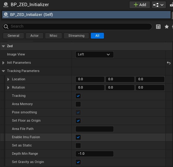

Pay special attention to some parameters :
  • Input Type : will the SDK compute data from a ZED camera, a SVO file, or a stream input.
  • Resolution, FPS, Depth Mode : Main parameters of the ZED camera. See the API Reference for more details. Default values HD 1080p, 30 fps and Depth Mode Ultra will work the best in most cases.
  • Loop and Real Time : If you’re using a SVO file, you will want to tick these two to true in most cases. It enables SVO looping and syncing the SDK processing time with the SVO timestamps.
  • Tracking : In the tracking parameters, you can enable or disable Tracking. If enabled, the virtual ZEDCamera component will use input from the ZED camera’s odometry to move in the virtual scene.
  • Enable IMU Fusion : If this option is enabled, the ZED SDK will use the internal IMU data of the ZED Camera, along with visual odometry, to find its orientation and position in the real world. This results in more accurate tracking, so you will want to keep this on most of the time.
  • Area Memory : Enable the use of the Area Memory feature of the ZED Camera. It is not mandatory, but should produce more accurate positional tracking data, especially over time, if the environment does not change too much.
  • Depth Occlusion : If enabled, the virtual objects will be hidden by the render of the real scene, using the depth of each pixel of the camera.
  • Show Zed Image : If enabled, the ZED Camera/SVO video stream will be rendered in fullscreen in the level viewport at runtime. You may want to leave it on in some cases (MR applications mostly) but in this tutorial, we want the virtual scene to occupy the screen.

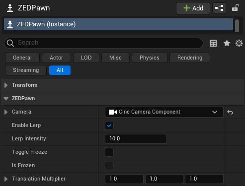

The ZEDPawn holds the ZEDCamera actor and has a Cine Camera component. image
  • Camera : Edit the Cine Camera component settings : all the intrinsic camera parameters such as the focal length or the aperture, and all the post processing options and other parameters.
  • Enable Lerp : Enable or disable smoothing of the camera movements, to manage jittering vs latency.
  • Lerp Intensity : Intensity of the smoothing. The alpha of the linear interpolation that smooths movements is the duration since the previous frame multiplied by this value, and clamped between 0 and 1.
  • Toggle Freeze : Tick this to freeze the virtual camera in place, allowing you to reposition the real one.
  • Translation Multiplier : The factors that will be applied on the real camera’s translations to calculate the virtual camera’s ones, on each axis.

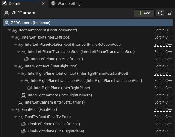

  • Firstly, the rendering cameras and planes where the plugin apply the textures created via the SDK data. image

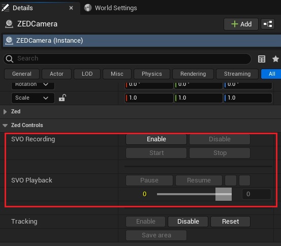

  • Secondly, the potential recording or playback of a SVO file. image

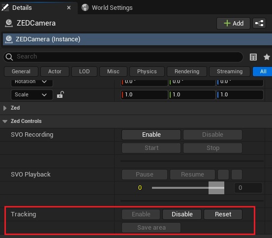

  • Thirdly, the activation and deactivation of the tracking of the camera at runtime. image

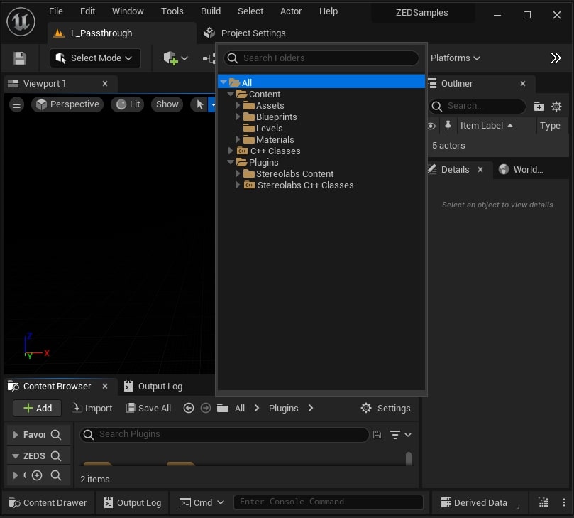

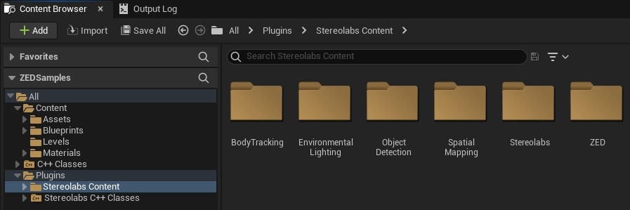

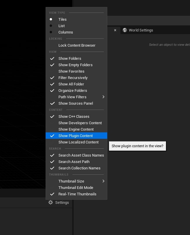

We’ve got to add a Blueprint from the ZED plugin. But by default, Content from plugins is hidden. To fix this, click on View Options at the bottom right of the Content Browser and enable Show Plugin Content.
Now click on the folder icon beside Content and click on StereoLabs Content to switch to the plugin’s content folder.
In the Content Browser, go to Plugins -> Stereolab Content -> ZED -> Blueprints and drag a BP_ZED_Initializer into the scene. This is the object that sets up your camera and handles communication with your app.
  • Select the BP_ZED_Initializer blueprint, and in the ZED section, uncheck the Show Zed Image parameter. This parameter has to be disabled so we can see the 3D scene and not the zed’s image in fullscreen.
  • Check that the Tracking is enabled in the Tracking Parameters of the BP_ZED_Initializer, along with Enable IMU Fusion.
  • Check that Set as Static is disabled, since your camera will move.
  • You can enable Set Floor as Origin to spawn the camera above the world’s origin, at a height matching the height of the real camera. If not, it will spawn at the world’s origin.
