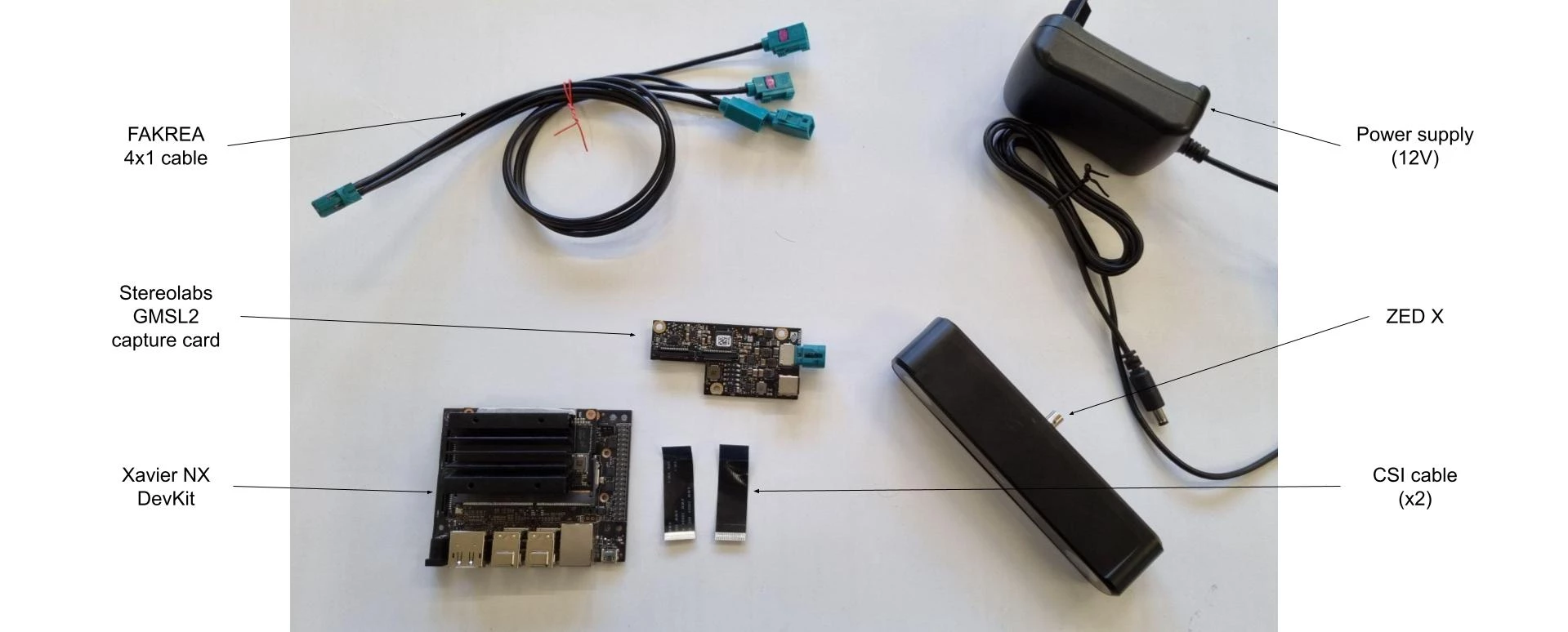

- 1x NVIDIA® Jetson™ Xavier NX Developer Kit.
- 1x ZED Link Duo GMSL2 capture card
- 1x 1-to-4 GMSL2 Fakra Male to Female cable (included in the box)
- 1x NVIDIA® Power supplier to power the Development Kit (included with the devkit)
- 2x FPC Camera Cable 15-pin 1.0mm (not included)*
- 9V-19V (min 2W) power input (Barrel Jack 5.5 mm outer diameter, 2.5 mm inner diameter) to power the GMSL2 capture card (not included)

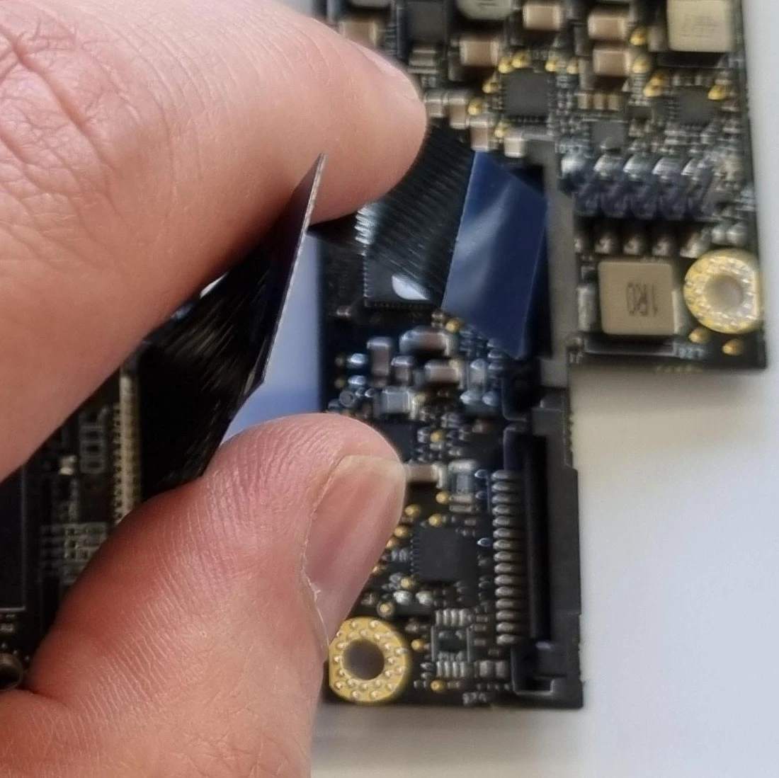

15-pin CSI cable must not be mistaken for a DSI cable where the active pin connection is on the same side. On CSI, the 15 pins are on the opposite side when looking at the flat cable. The cable can be purchased at UCTRONICS.
MIPI cables carry high-speed video signals, and longer cables can introduce noise or signal degradation. For optimal performance, use cables no longer than 15 cm.
Connect the CSI cable at each MIPI 15-pin port of the carrier board. Make sure the correct side is plugged in for each port.
Both MIPI cables must be connected to have access to 2x ZED GMSL2 cameras on the capture card.

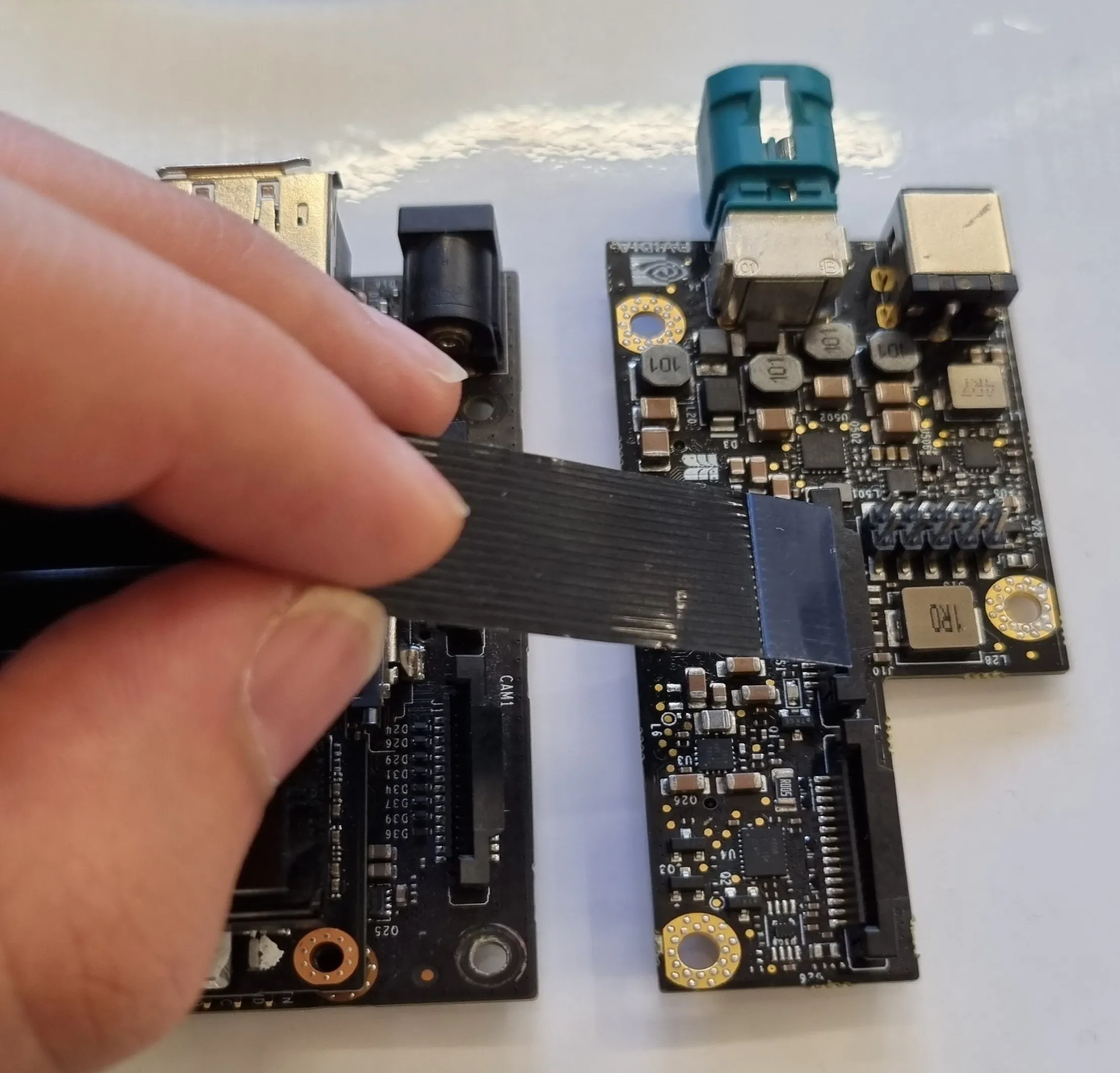

Cabling the Carrier Board

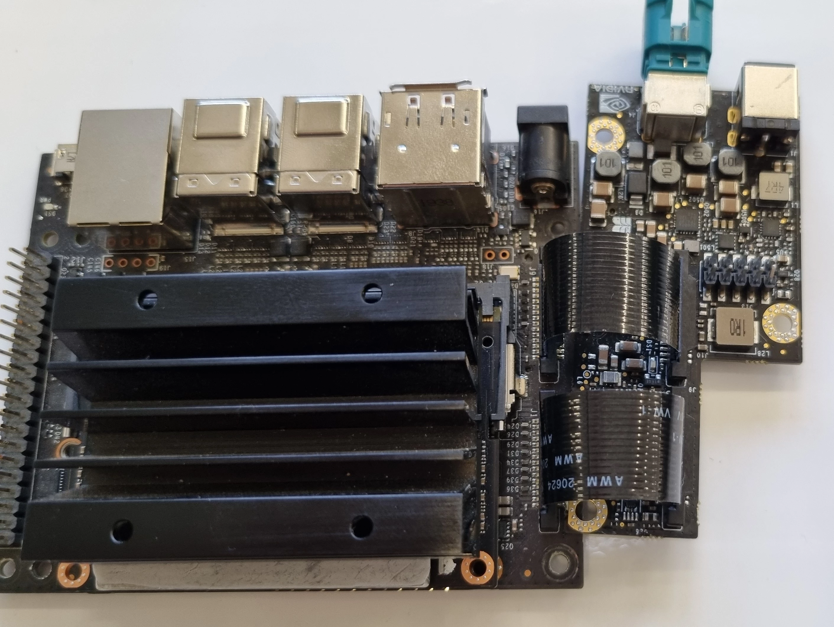

Connect the CSI cable to the capture card.
Make sure that J9/CAM0 is connected to the centered MIPI port of the GMSL2 capture card.
J1/CAM1 must be connected to the MIPI port close to the edge.
Once connected, the setup should look like as in the following picture:

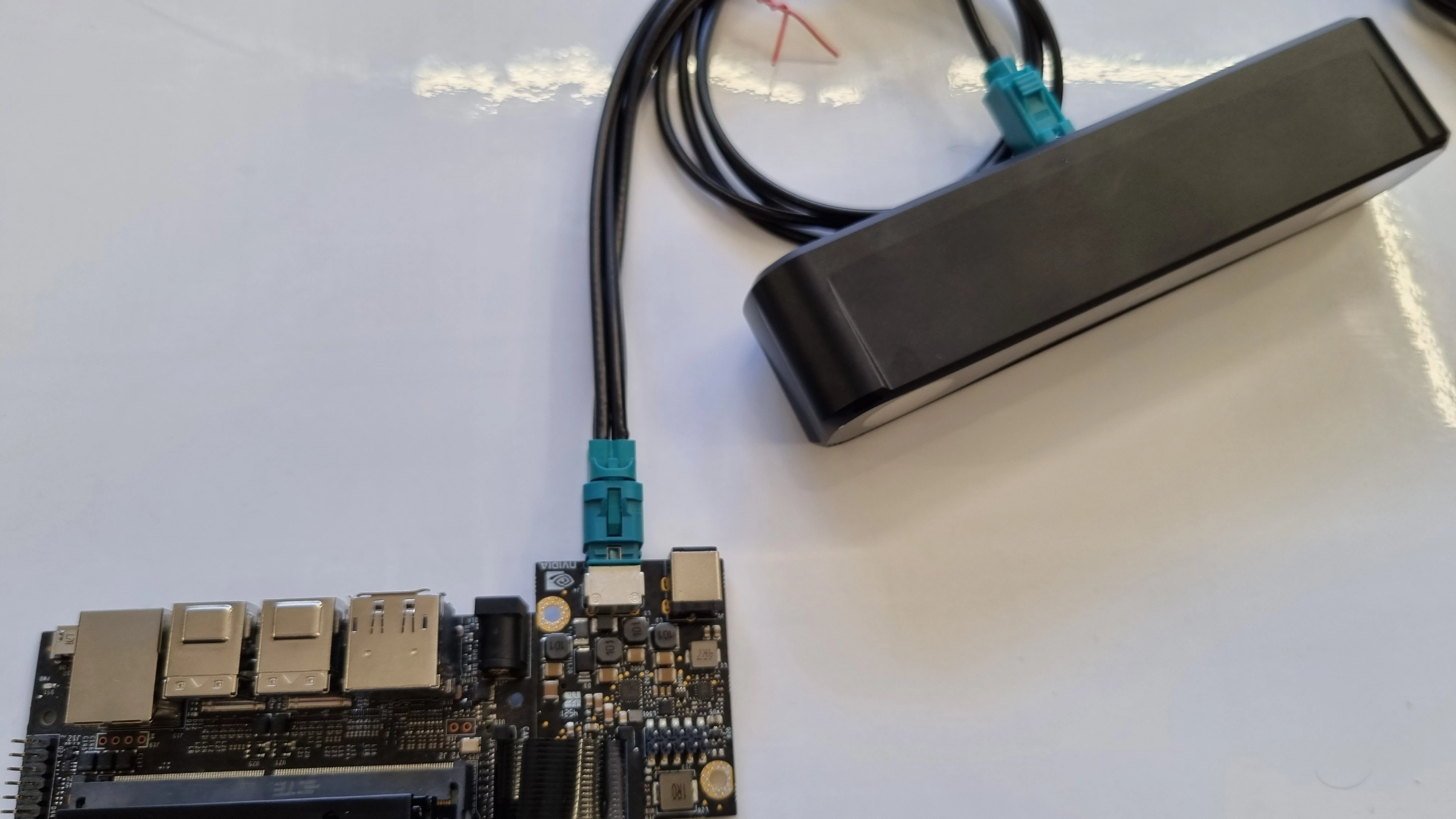

Connect the camera
Connect the GMSL2 Fakra cable female end to your ZED X. When you hear a click, the cable is securely connected to the camera.
GMSL2 cameras must be ideally plugged before booting up. If it is not the case, you can restart the zed_x_daemon that will be installed by the driver in the next section.
