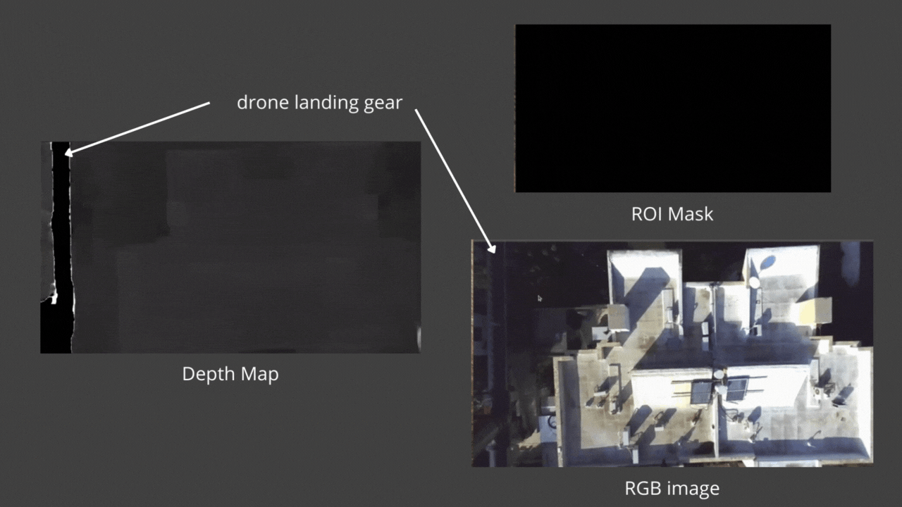

When mounting a ZED on a robot it happens very often that parts of the robot itself are statically visible in the camera’s field of view. This fact affects the depth extraction and performance of the positional tracking algorithms because part of the image will be stable even if the camera is moving.
The region of interest can be used to ignore these non-useful parts of the frame in the ZED SDK pipeline thus improving the overall performance of the ZED SDK algorithms run by the ZED ROS 2 Wrapper.
