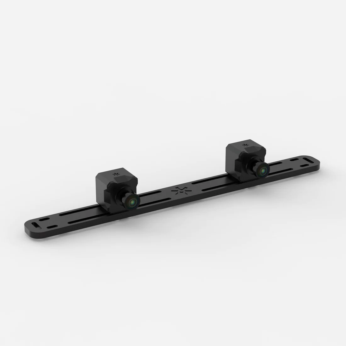

The two ZED X One cameras should be rigidly mounted parallel to each other at a fixed distance (baseline). It is critical that the cameras don’t move in rotation or translation relative to each other over time. Any minimum movement will require a new calibration. The mechanical stability should be adapted depending on usage conditions, especially vibration or shocks that could impact cameras’ alignments and significantly decrease the accuracy of the depth processing.
In the StereoLabs store you can find a Dual Camera Mount for ZED X One to mount two ZED X One cameras at a fixed distance and test the stereo setup.

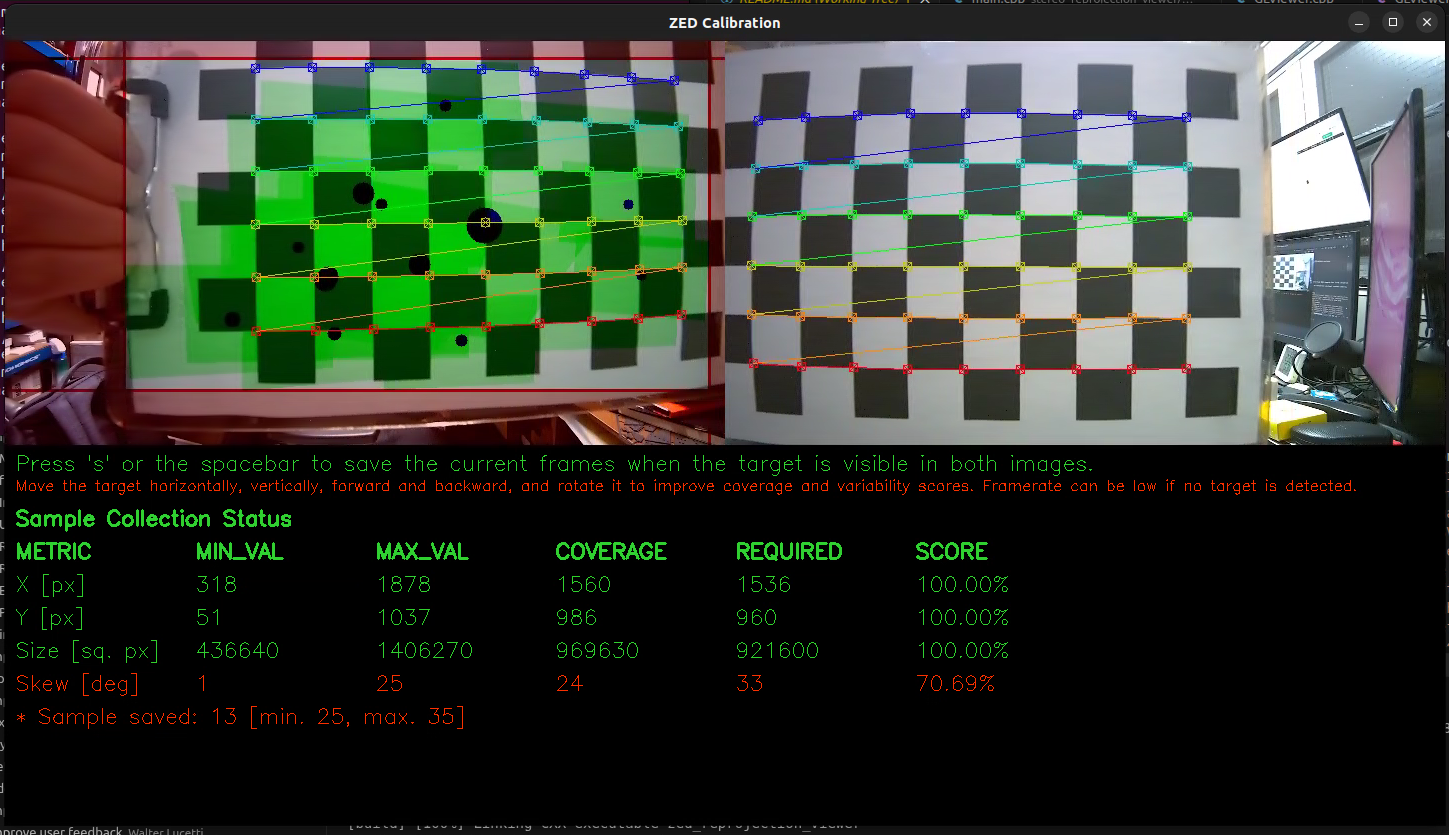

The Data Acquisition phase consists of moving the checkerboard in front of the camera(s) to capture diverse views. The tool provides real-time feedback on the quality of the captured data regarding XY coverage, distance variation, and skewness.
When the checkerboard is placed in a position that you want to capture, press the Spacebar or the S key to capture the images.
- If the checkerboard is detected in both images, and the captured data are different enough from the previously captured images, the data is accepted, and the quality indicators are updated.
- If the data is not accepted, a message is displayed in the GUI output indicating the reason (e.g., checkerboard not detected, not enough variation, etc.).
The blue dots that appear on the left image indicate the center of each checkerboard that has been detected and accepted so far. The size of the dots indicates the relative size of the checkerboard in the image (bigger dots mean closer to the camera).
In order to collect good calibration data, ensure that:
- The checkerboard is always fully visible in both left and right images. Corners detected in both images are highlighted with colored visual markers.
- The checkerboard moves over a wide area of the image frame. “Green” polygons appear on the left image to indicate the covered areas. When one of the 4 zones of the left image becomes fully green, the coverage requirement is met for that part of the image.
- Red areas on the side of the left frame indicate zones that are not yet covered by the checkerboard. Try to make them as small as possible.
- The checkerboard is moved closer and farther from the camera to ensure depth variation. At least one image covering almost the full left frame is required.
- The checkerboard is tilted and rotated to provide different angles.
The “X”, “Y”, “Size”, and “Skew” percentages indicate the quality of the collected data for each criterion.
For X and Y, the minimum and maximum values correspond to the minimum and maximum position of the corner of the checkerboard closest to the image border. The COVERAGE indicates the size of the horizontal and vertical area covered by the checkerboard corners in the left image. The higher the coverage, the more the image is covered.
For Size, the minimum and maximum values correspond to the smallest and largest size of the checkerboard in the left image. The COVERAGE indicates the range of sizes of the checkerboard in the collected samples. A higher coverage means that the checkerboard was captured at a wider range of distances from the camera.
For Skew, the minimum and maximum values correspond to the minimum and maximum skewness angle of the checkerboard in the left image. The COVERAGE indicates the range of skew angles of the checkerboard in the collected samples. A higher coverage means that the checkerboard was captured at a wider range of angles. A value of 0° means the checkerboard is perfectly fronto-parallel to the camera, a theoretical maximum of 90° means the checkerboard is seen edge-on. Normally, the maximum achievable skew is around 40°.
If you cannot reach 100% for one of the metrics, be sure that it’s as high as possible, and move the checkerboard in different positions to maximize the coverage by acquiring the maximum number of samples.
Here are some tips to improve each metric:
- To raise the “X” and “Y” metrics move the checkerboard to the edges and corners of the left image while keeping it fully visible in the right frame.
- To raise the “Size” metric, move the checkerboard closer and farther from the camera. You must acquire at least one image where the checkerboard is covering almost the full left image and one where it’s smaller and corners are barely detected [see the image below].
- To raise the “Skew” metric, rotate the checkerboard in different angles. It’s easier to obtain different skew values if the checkerboard is closer to the camera and rotated around the vertical and horizontal axes simultaneously.
The “Calibrate” process will automatically start when either of these conditions is met:
- All metrics reach 100% and the minimum number of samples is collected.
- The maximum number of samples is reached (even if not all metrics reach 100%).
For each metric, the GUI shows the following information in a table:
- MIN_VAL: Minimum value stored in all the samples collected so far.
- MAX_VAL: Maximum value stored in all the samples collected so far.
- COVERAGE: The difference between the MIN_VAL and MAX_VAL, representing the range of variation in the collected samples.
- REQUIRED: The minimum required value for the COVERAGE to consider the metric as satisfied.
- SCORE: The percentage score for the metric, calculated as (COVERAGE / REQUIRED) * 100%.
You can follow the steps of the calibration process in the terminal output:
- The left camera is calibrated first, followed by the right camera to obtain the intrinsic parameters.
- Finally, the stereo calibration is performed to compute the extrinsic parameters between the two cameras.

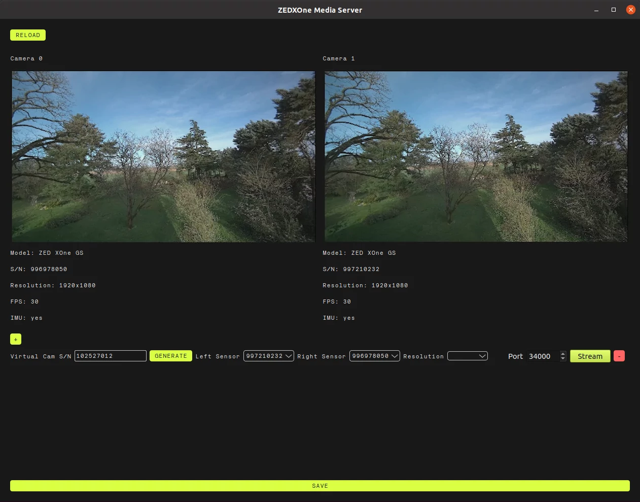

Use the ZED Media Server tool (Obsolete - For ZED SDK < v5.1)
The first step is to configure a virtual Stereo camera from 2 ZED X One. Open the ZED Media Server tool to setup this system.
At the time of writing this documentation, some ZED SDK Tools (e.g, ZED Depth Viewer, ZEDfu) do not support the new virtual stereo API. In this case, you need to use the ZED Media Server tool to create a virtual stereo camera from the two ZED X One cameras to use them with the custom stereo rig.
The GUI of ZED Media Server allows setting up which cameras should be the left and the right, using the cameras’ serial numbers. Please make sure that the system is correctly set up, especially that the left and right cameras are not swapped.
Set the desired resolution, then click the bottom SAVE button once the system is set up. This will store the configuration of the cameras serial numbers and their location in the virtual stereo system. The virtual camera serial number SN on the left will be the one used in the ZED SDK to reference this virtual stereo camera.
Click the Stream button to start streaming the images.
The GUI can be closed, a service (zed_media_server_cli) will automatically start in the background to stream data from the virtual stereo camera.

Please note that at this point the stereo camera images are available but require a calibration procedure to be usable. The calibration provides the ZED X Ones’ relative position to each other (known as extrinsic parameters) and can also refine or compute the ZED X Ones’ lens parameters such as focal, optical center, distortion (known as intrinsic parameters). These calibration parameters are used by the ZED SDK to compute depth information.
