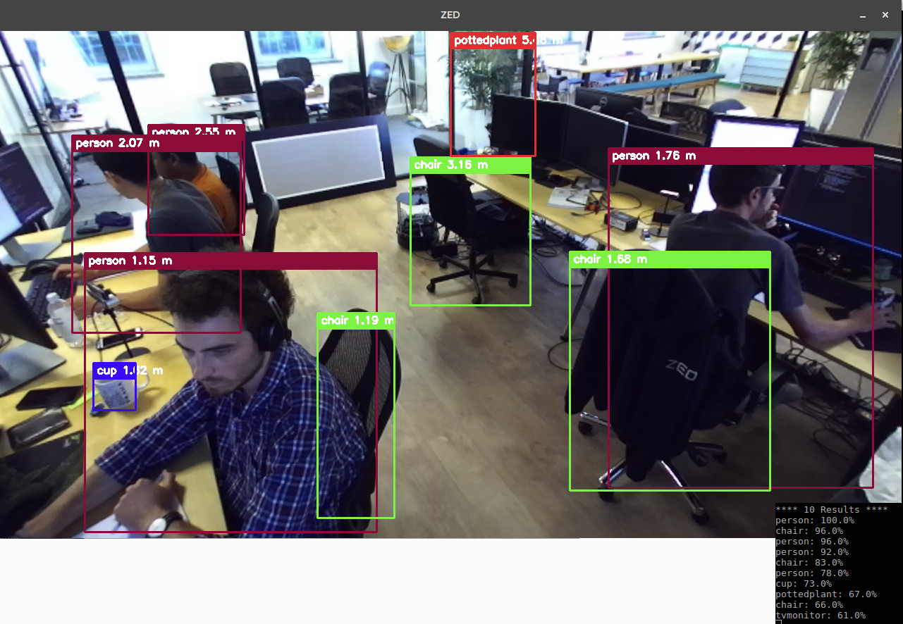

This package lets you use YOLO models, the deep learning framework for object detection, with the ZED stereo camera in Python or C++.
It enables the use of ZED 3D cameras with YOLO object detection, adding 3D localization and tracking to the most recent YOLO models.
These samples are designed to run state-of-the-art object detection models using the highly optimized TensorRT framework. Images are captured using the ZED SDK, and the 2D box detections are then used by the ZED SDK to extract 3D information (localization, 3D bounding boxes) and perform tracking.
The samples use a TensorRT-optimized ONNX model. They are currently compatible with YOLOv5, YOLOv6, YOLOv7, YOLOv9, YOLOv10, YOLOv11, and YOLOv12. If another architecture or future model uses the same output format as one of the supported models, it should also be compatible. The default model trained on the COCO dataset (80 classes) provided by the framework maintainers can be used.
