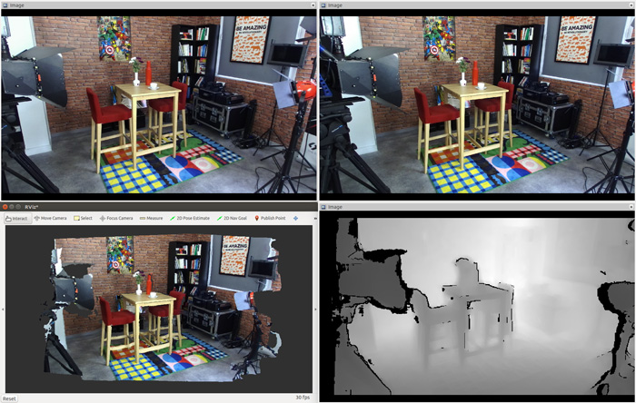

Displaying ZED data
Using RVIZ
RVIZ is a useful visualization tool in ROS. Using RVIZ, you can visualize the ZED left and right images, depth, point cloud, and 3D trajectory.
Launch the ZED wrapper along with RVIZ using the following commands available if you installed the zed-ros-examples repository:

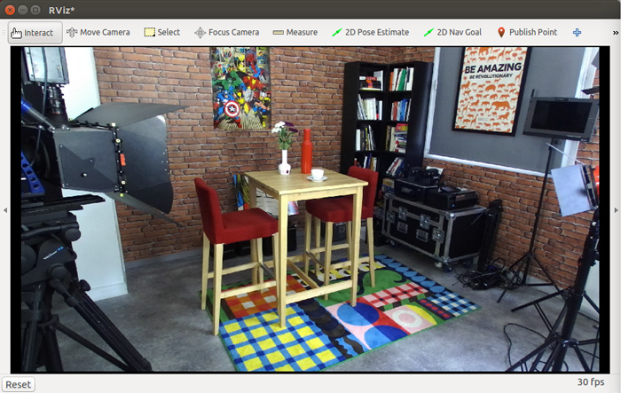

Displaying Images
The ZED node publishes both original and stereo rectified (aligned) left and right images. In RVIZ, use the image preview mode and select one of the available image topics. Following the list of the main image topics:
  • rgb/image_rect_color: Color rectified image (left sensor by default)
  • rgb/camera_info: Color camera calibration data
  • rgb_raw/image_raw_color: Color unrectified image (left sensor by default)
  • rgb_raw/camera_info: Unrectified color camera calibration data
  • right/image_rect_color: Right camera rectified image
  • right/camera_info: Right sensor calibration data
  • right_raw/image_raw_color: Right camera unrectified image
  • right_raw/camera_info: Unrectified right sensor calibration data
  • confidence/confidence_image: Confidence map as image
The Confidence Map is also available as a 32bit floating point image subscribing to the confidence/confidence_map topic.

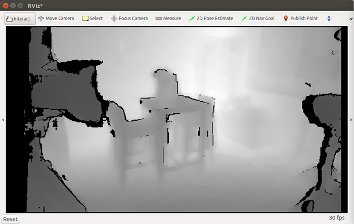

Displaying Depth
The depth map can be displayed in RVIZ with the following topic:
  • depth/depth_registered: 32-bit depth values in meters. RVIZ will normalize the depth map on 8-bit and display it as a grayscale depth image.
An OpenNI compatibility mode is available in the launch/zed_camera.launch file. Set openni_depth_mode to 1 to get depth in millimeters and in 16-bit precision, and restart the ZED node.
Depth

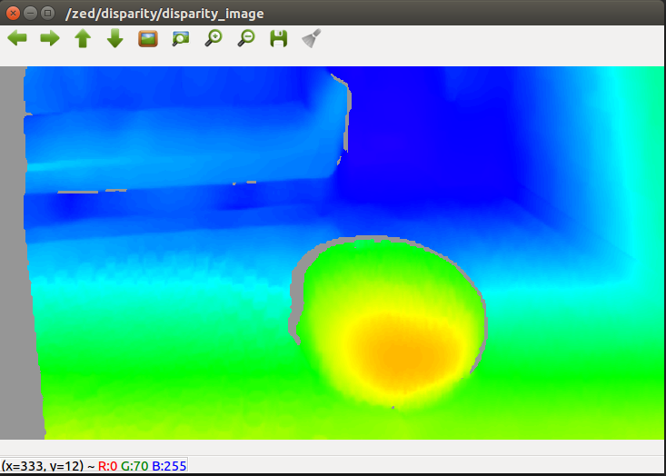

Displaying Disparity
The Disparity Image is available by subscribing to the disparity/disparity_image topics.
Launch the Disparity Viewer to visualize it:
$rosrun image_view disparity_view image:=disparity/disparity_image
Disparity

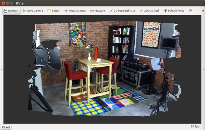

Displaying the Point cloud
A 3D colored point cloud can be displayed in RVIZ with the zed/zed_node/point_cloud/cloud_registered topic.
Add it in RVIZ with point_cloud -> cloud -> PointCloud2. Note that displaying point clouds slows down RVIZ, so open a new instance if you want to display other topics.
Point Cloud

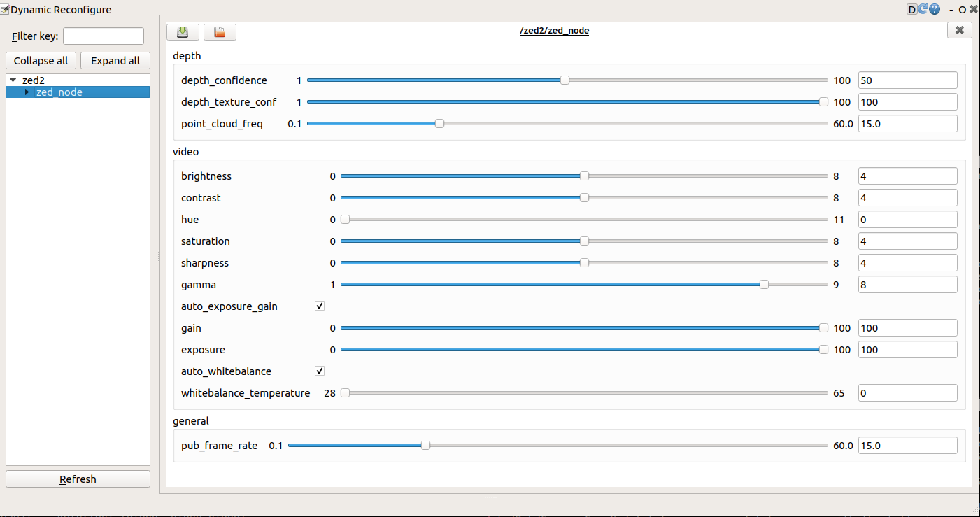

Dynamic reconfigure
You can dynamically change many configuration parameters during the execution of the ZED node.
You can set the parameters using the command dynparam set, e.g.:
$rosrun dynamic_reconfigure dynparam set depth_confidence 80
or you can use the GUI provided by the rqt stack:
$rosrun rqt_reconfigure rqt_reconfigure
The full list of available dynamic parameters is available here
RQT Reconfigure
