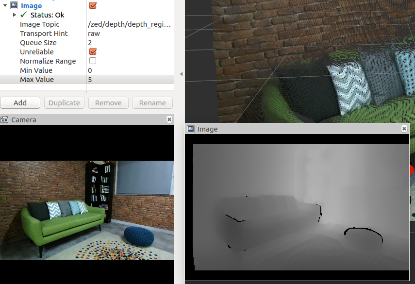

Depth image
To visualize a depth image, you can use the simple Image plugin since the depth data are published on topics of type sensor_msgs/Image (see above). It differs from a “normal” image in that the data is encoded in 32-bit (floating point) not 8-bit.
The parameters are the same as for Image, with three additions:
Normalize range: Since a floating point image is not directly rendered, it is converted to an 8-bit grayscale image. Enabling this field means the normalization range is automatically calculatedMin value: IfNormalize rangeis unchecked, you can manually set the minimum depth range in metersMax value: IfNormalize rangeis unchecked, you can manually set the maximum depth range in meters
Manually setting the normalization range is useful if you know the maximum value measured for the depth and you want to keep the image scale static.

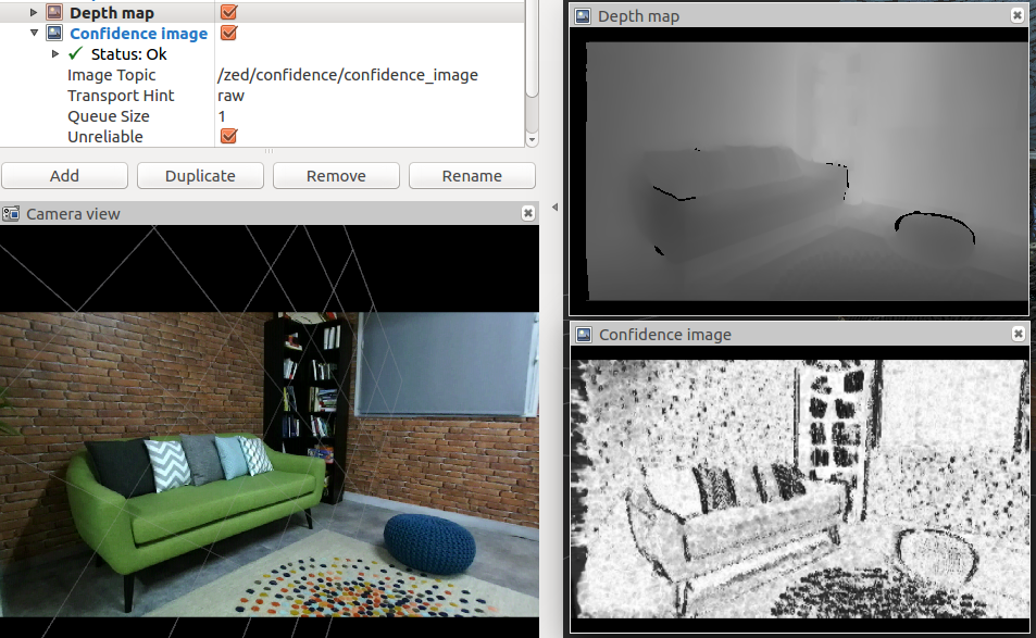

Confidence
To visualize the Confidence Map as an image, you can use the Image plugin subscribing to the topic /zed/zed_node/confidence/confidence_image.
The lighter a pixel, the more reliable its corresponding depth value is.

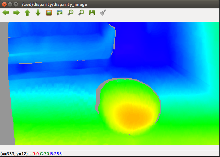

Disparity
A plugin for RVIZ to visualize a disparity message on the topic of type stereo_msgs/Disparity is not available, but you can use the disparity_view node available in the image_view package.
Launch the Disparity Viewer to visualize the disparity image that is published on the topic /zed/zed_node/disparity/disparity_image:
