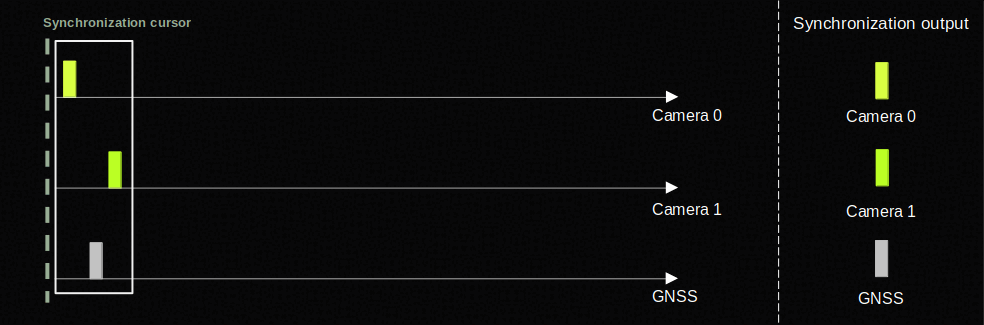

To understand how data synchronization works, let’s consider a toy example with two ZED cameras and an external GNSS. In the following example, each data is represented by a color bar aligned on its timestamp.

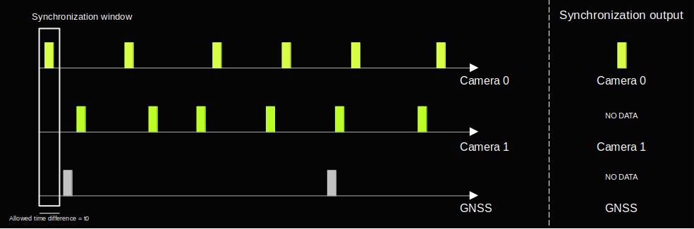

The first step of data synchronization involves matching data with closely related timestamps. In other words, data could be synchronized if they have a small timestamp difference. Allowed time difference between synchronized data could be viewed as a synchronization window. Small allowed timestamp differences will lead to small synchronization windows whereas big allowed timestamp differences will lead to big synchronization windows. The following schematic illustrates how the size of synchronization windows will influence the synchronization output.
The synchronization window size is chosen once and remains fixed for the rest of the data synchronization. Data are considered synchronized when they fall in the same synchronization window. Once the data are synchronized, they are removed from the synchronization pipeline and returned to fusion. The synchronization cursor is then advanced to synchronize the next set of data.

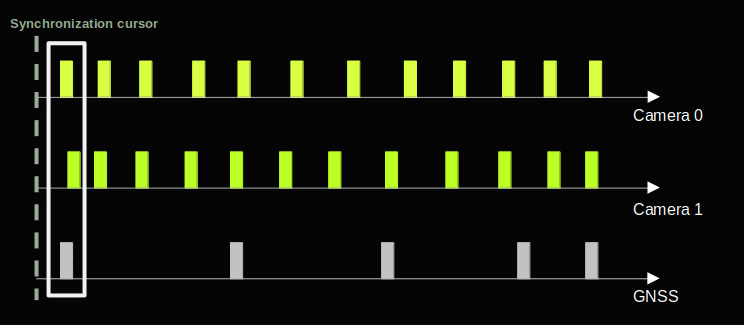

In the current version, the synchronization window size is determined by the camera’s declared FPS. For instance, if the camera is set at 30 FPS, the synchronization window size will be 33 milliseconds. Similarly, if the camera is set at 60 FPS, the synchronization window size will be 16 milliseconds, and so on. You can adjust the camera’s desired FPS using the camera_fps attribute within the InitParameters.
The diagram below illustrates the synchronization process once the window size has been correctly set.
