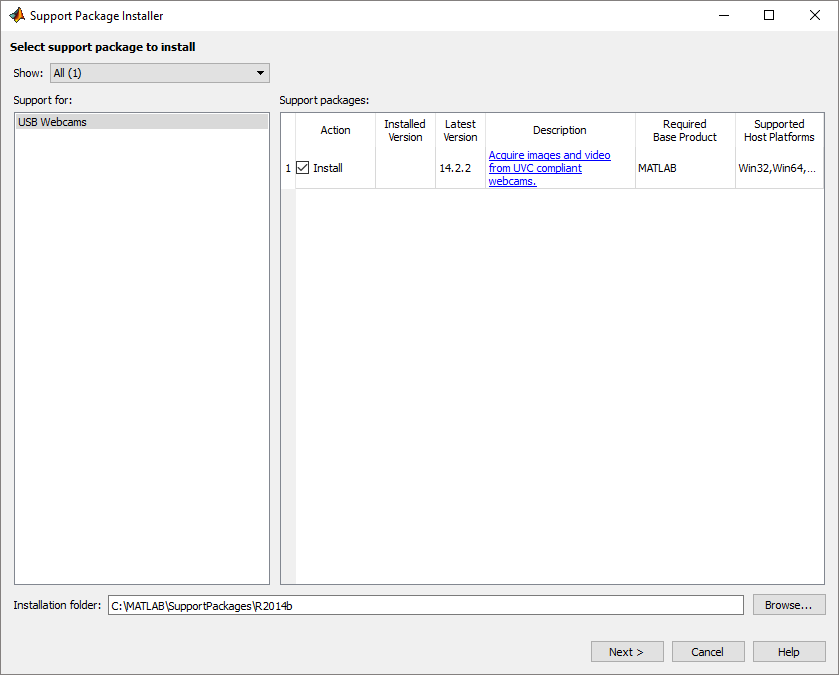

If you encounter the error, click on the link in the error log. A dialog window should appear that prompts you to install a package to support video acquisition with USB cameras:
Click Next and Log In. Matlab will ask for your MathWorks account credentials. Go through the MathWorks auxiliary software license agreement. Click Next and Install. Package installation can take around 10-15 seconds.

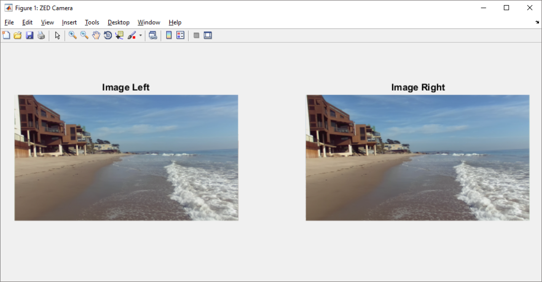

As a result, you should see the left and right images in the same window.

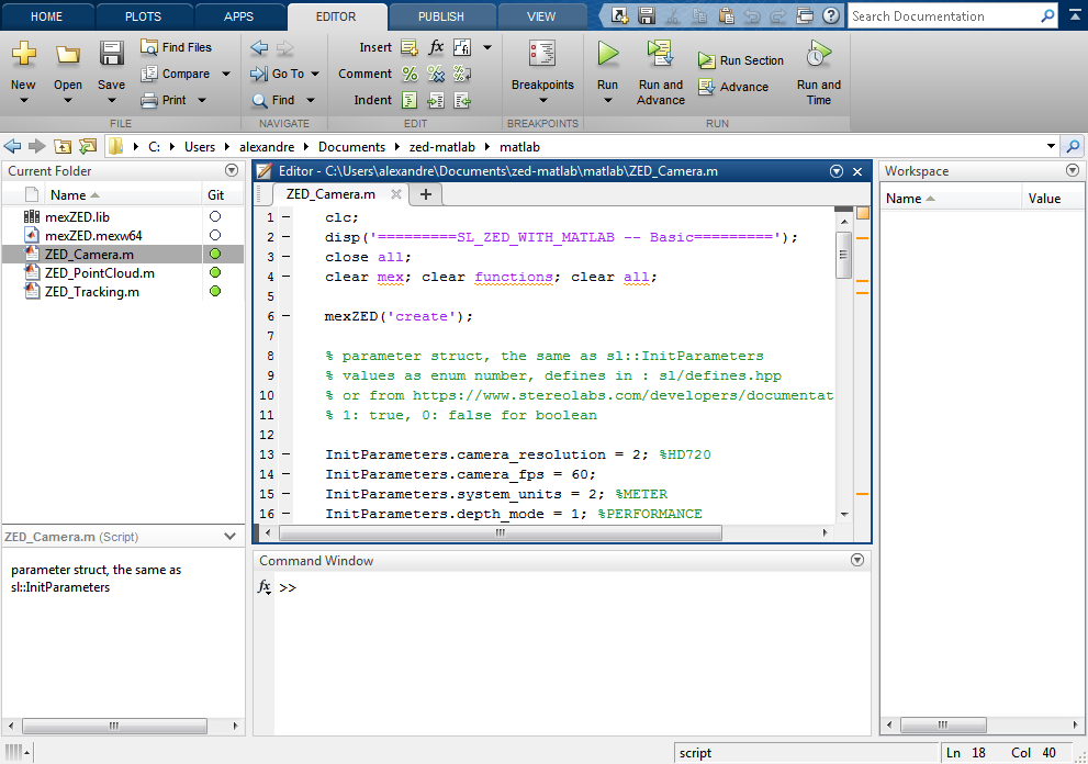

  • matlab: Contains Matlab examples ZED_Camera.m, ZED_Tracking.m and ZED_PointCloud.m that demonstrate the use of the ZED SDK features in Matlab.
  • src: Contains all the files needed to build the Mex file wrapping the SDK functions. In this directory, you will find a mex subfolder with a ‘mexZED.cpp’ file which contains the ZED SDK functions and the interface with Matlab. This file is referred to as a MEX file, it re-implements the majority of the ZED SDK functions in Matlab. It is provided as a basic container and can be complemented with your own functions.
    • Since Matlab does not handle image representations the same way the ZED SDK does, additional conversion functions are required. They are located in the different ‘.hpp’ files in the include directory.
In the ‘ZED_Camera.m’ file, the ZED SDK functions can be called using mexZED(’..’). Check the ‘mexZED.cpp’ to see the list of available functions.

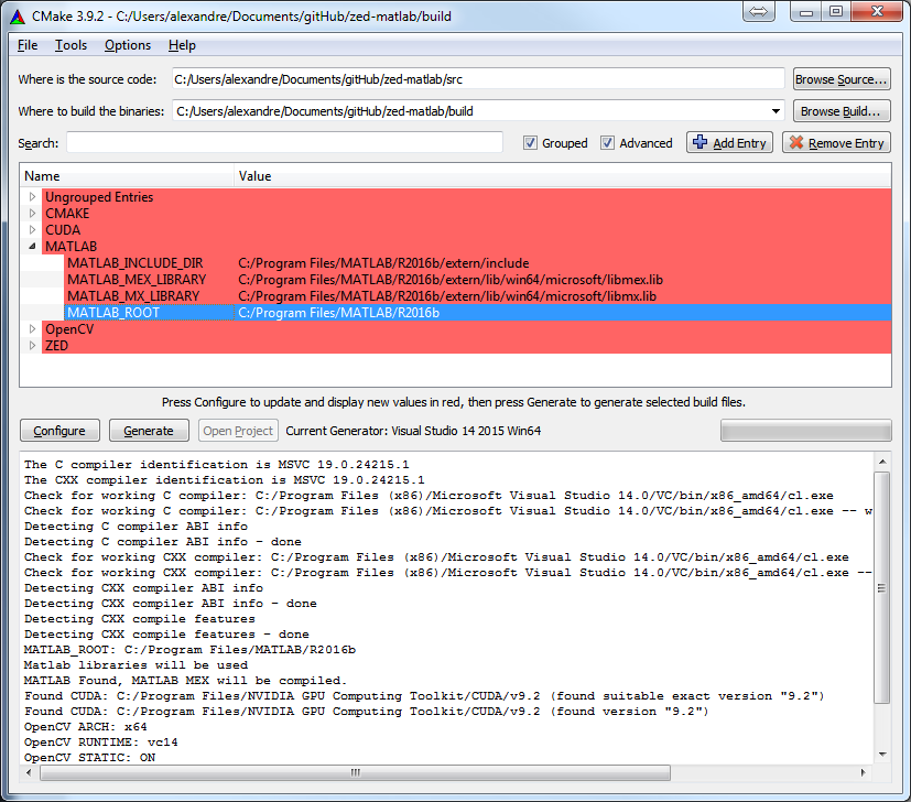

In CMake GUI:
  • Set ‘where is the source code’ as ‘zed-matlab\src’
  • Set ‘Where to build the binaries’ as ‘zed-matlab\build’
  • Make sure to specify an x64 version of Visual Studio
  • Click ‘Configure’
    • You may encounter an error saying ‘MATLAB not found…nothing will be built.’ It means that the ‘MATLAB_ROOT’ variable isn’t containing a valid path to your Matlab installation. To solve it, you can create a MATLAB_ROOT environment variable, reboot, and click on ‘Configure’, or edit the MATLAB_ROOT variable if it is already displayed in the CMake GUI e.i.‘MATLAB_ROOT=C:/Program Files/MATLAB/R2016b’ image
  • Click on ‘Generate’

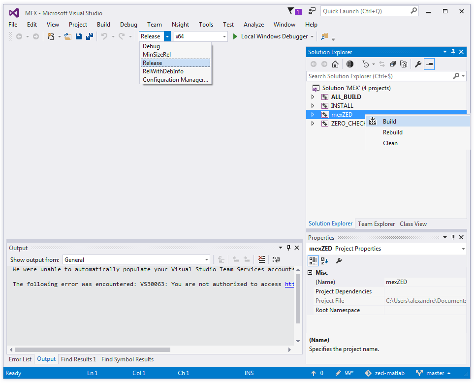

  • Click on ‘Open Project’
  • Set the Solution Configuration to Release
  • Build mexZED
  • Build INSTALL image

Run the Examples
Open Matlab, move to the zed-matlab\matlab directory and launch the samples.
ZED_Camera.m shows to open the ZED, capture video and depth and display a depth histogram.
ZED_Tracking.m shows how to open the ZED, capture images and positional tracking data and draw the 3D position of the camera over time.
ZED_PointCloud.m shows how to open the ZED, capture images and 3D point cloud. The point cloud is displayed as a mesh.
