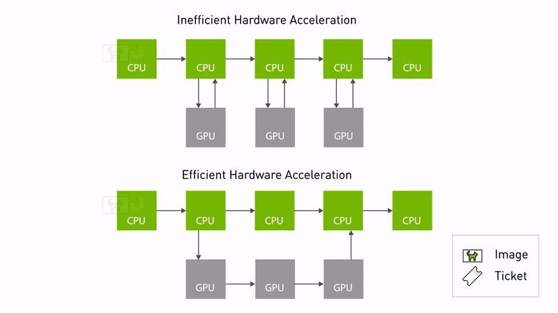

When building the ZED ROS 2 Wrapper packages, the build system automatically checks for the presence of the NVIDIA® Isaac™ ROS packages, in particular the isaac_ros_nitros package. If detected, the ZED Camera ROS 2 components are built with NITROS support enabled. NITROS (NVIDIA® Isaac™ Transport for ROS) is a technology that accelerates ROS data streaming by leveraging GPU memory, allowing high-performance data transfer without routing through the CPU.

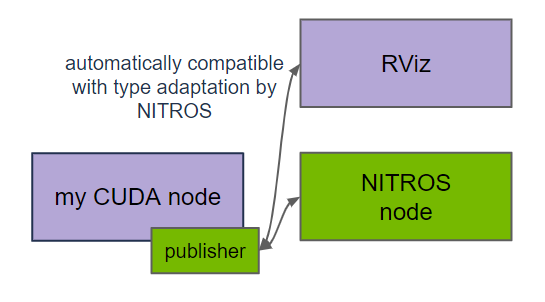

The ZED ROS 2 Wrapper can leverage NITROS thanks to its strong integration with CUDA processing using the isaac_ros_managed_nitros package.
In particular, the ZED ROS 2 Wrapper uses Managed NITROS publishers to publish images and depth maps directly from the GPU memory, avoiding unnecessary data copies and CPU overhead. This results in significantly improved performance for applications that require high throughput and low latency, such as real-time object detection, mapping, and navigation.
The Managed NITROS publisher and its counterpart, the Managed NITROS subscriber, enable efficient, GPU-accelerated data transfer between the ZED camera node and other Isaac™ ROS nodes. Thanks to ROS 2 Type Adaptation, these components maintain compatibility with standard (non-Isaac™) ROS 2 nodes by automatically converting data to standard ROS 2 message types when needed—for example, to visualize images in rviz2. This seamless integration ensures high performance while preserving interoperability within the ROS 2 ecosystem.
