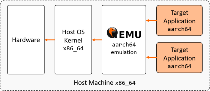

Setting Up ARM Emulation on x86
We will use QEMU and Docker to set up our emulated environment. QEMU is an open-source machine emulator and virtualizer. It lets you build ARM CUDA binaries on an x86 machine without a cross-compiler.

As expected, the instructions are not recognized, because the emulation support is not installed yet. Installing the following packages enables support for aarch64 containers on your x86 workstation:
$sudo apt-get install qemu-user-static binfmt-support # Install the QEMU packages
$docker run --rm --privileged multiarch/qemu-user-static --reset -p yes # Register the QEMU interpreters with binfmt
$docker run --platform=linux/arm64/v8 --rm -t arm64v8/ubuntu uname -m # Test the emulation environment
$#aarch64
The installation was successful and the emulation is working. At this point, you can run aarch64 programs on the x86_64 host. However, it is not yet possible to build and run CUDA-accelerated applications under QEMU. To add this capability, you need to use a Linux for Tegra (L4T) base image from the NVIDIA® registry (see the next section for details).

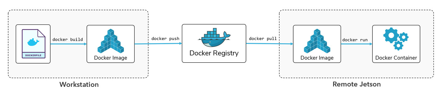

We recommend the workflow above for building and deploying your applications with Docker on NVIDIA® Jetson™. Your source code and Dockerfiles live on your local device (the host machine). The image is built from the Dockerfile on the host and pushed to a Docker registry that makes it accessible from a remote device (the target machine). On the target machine, the image is pulled from the registry and run in a container.

Pull your image from the registry on the target machine, then run it in a container:
$docker pull {user}/{custom_image}:{custom_tag}
$docker run --privileged --runtime nvidia --rm {user}/{custom_image}:{custom_tag}
If the image has not been pulled previously, docker run will pull it from the registry automatically.
