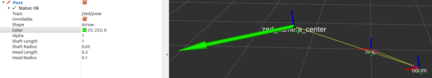

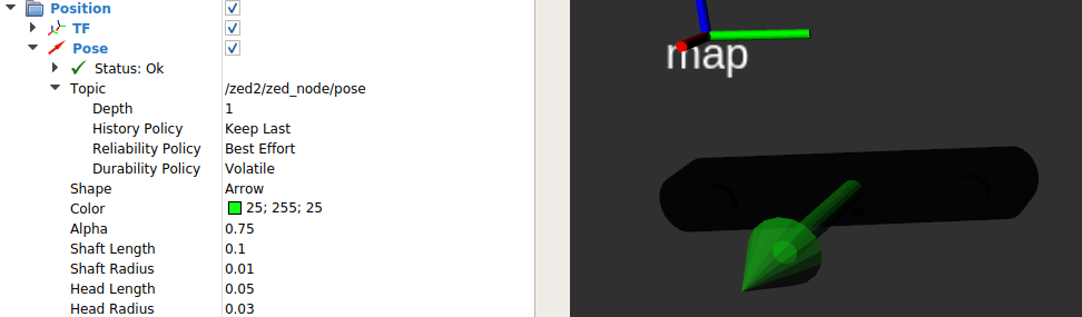

Camera pose
The Pose plugin provides a visualization of the position and orientation of the camera (geometry_msgs/PoseStamped) in the Map frame.
The Topic to be subscribed to is ~/pose.
Key parameters:
  • Topic: Selects the odometry topic /zed/zed_node/odom
  • Unreliable: Check this to reduce the latency of the messages
  • Position tolerance and Angle tolerance: set both to 0 to be sure to visualize all positional data
  • Keep: Set to the number of messages to visualize at a time
  • Shape: You can visualize odometry information as an arrow pointing in the direction of the X axis, or as a three Axes frame. Both shapes can be resized to your preference

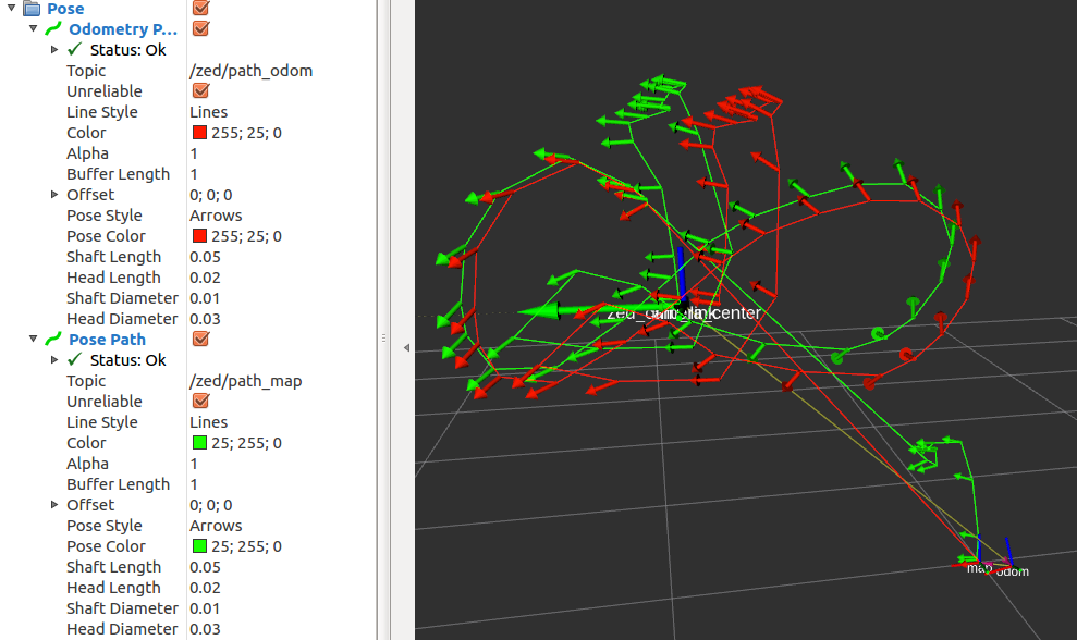

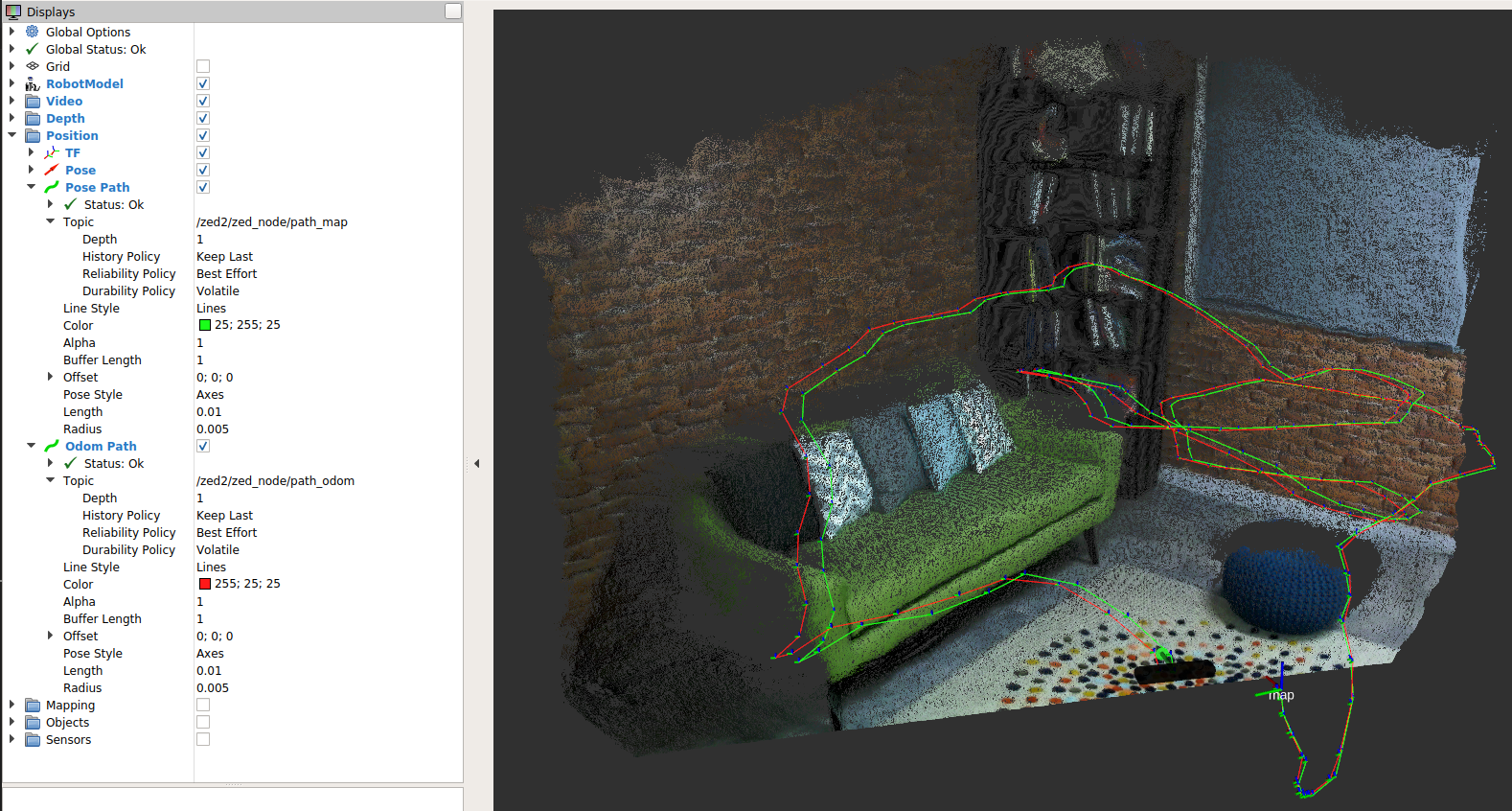

Camera path
The ZED wrapper provides two different paths for the camera position and orientation:
  • ~/path_map: The history of the camera pose in Map frame
  • ~/path_odom: The history of the odometry of the camera in Map frame
Above you can see both the Pose (green) and the Odometry (red) paths.
The odometry pose is calculated with a pure “visual odometry” algorithm as the sum of the movement from one step to the next. It is therefore affected by drift.
The camera pose is instead continuously fixed using the StereoLabs tracking algorithm that combines visual information, space memory information and if using a “ZED-M” or a “ZED2”, inertial information.
The parameters to be configured are analogous to the parameters seen above for the Pose plugin.
