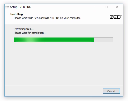

Install the ZED SDK #
Run the installer.

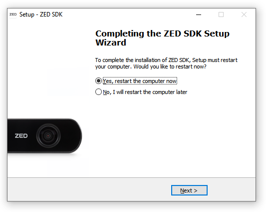

Restart your computer #
At the end of the installation, a system restart is required to update the Windows environment variables.
📌 Note: Skipping this step could lead to
library not founderrors. Make sure to restart your computer, especially if it is the first time the SDK is installed on your machine.
