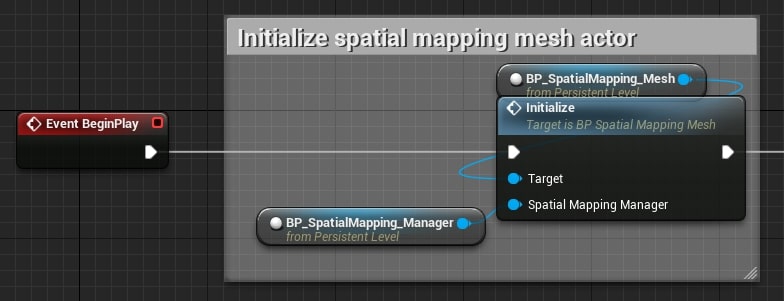

  • Go to ZED/Blueprints/SpatialMapping and add BP_SpatialMapping_Manager and BP_SpatialMapping_Mesh to the scene.
  • Now we need to initialize the scanning mesh actor. Open the level blueprint and initialize the mesh.

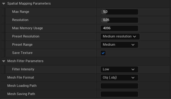

  • Click on the BP_SpatialMapping_Manager actor in the world outliner to see the settings. We recommend using the following set of parameters for mapping:
    • Resolution = Medium (Small variations in the geometry will disappear, useful for big objects)
    • Range = Medium (Medium depth range. LONG will take into account objects that are far, useful for outdoor purposes.)
    • Filtering = Low (Clean the mesh by closing small holes and removing isolated faces.)
For more details on Spatial Mapping parameters, see this section.

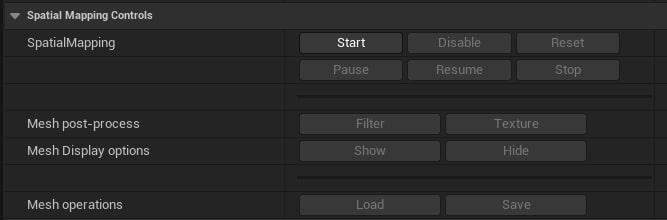

  • Play the level.
  • Click on the BP_SpatialMapping_Manager in the world outliner. You should see the spatial mapping controls.
  • Click on Start to initialize the spatial mapping and start mapping the area.
  • Move your camera around. The mesh should become visible.
  • Once you’ve mapped enough of the room, click on Stop.
  • Click Filter to filter (clean up) the mesh. This process may take some time depending of your settings.
  • If you want to save your mesh, click Save.
  • When finished, click on Disable to disable spatial mapping.
