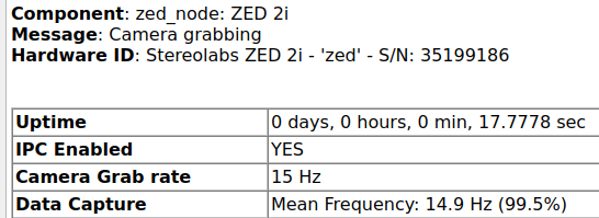

The recommended approach to find the best value for this parameter is to start with a value equal to the general.grab_frame_rate parameter and then decrease it at runtime while monitoring the Diagnostic feedback. Optimal values are obtained when the “Data Capture - Mean Frequency” average value is higher than 99.5% of the general.grab_frame_rate parameter:
