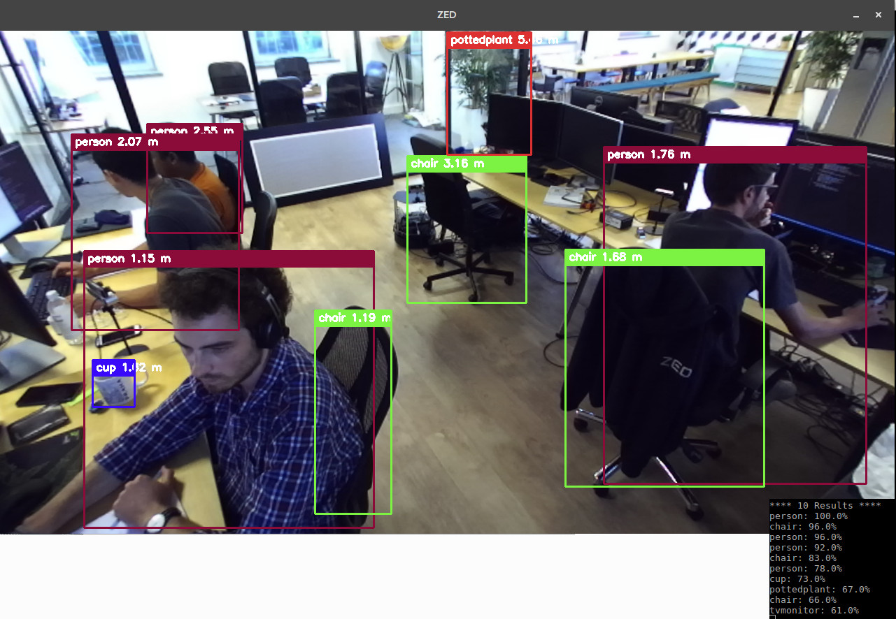

These samples are designed to run state-of-the-art object detection models using the highly optimized TensorRT framework. Images are captured with the ZED SDK to detect 2D bounding boxes using YOLO, and the ZED SDK then extracts 3D information (localization, 3D bounding boxes) and performs tracking.

  1. [Recommended] Use the OBJECT_DETECTION_MODEL::CUSTOM_YOLOLIKE_BOX_OBJECTS mode in the ZED SDK API to natively load a YOLO ONNX model. The inference code is fully optimized and internally uses TensorRT. The output is directly available as 2D and 3D tracked objects. This is the easiest and most optimized solution for supported models. ONNX to TensorRT engine generation (optimized model) is automatically handled by the ZED SDK.

This sample demonstrates how to detect custom objects using the official PyTorch implementation of YOLOv8 from a ZED camera and ingest them into the ZED SDK to extract 3D information and track each object.

  • The camera point cloud is displayed in a 3D OpenGL view
  • 3D bounding boxes around detected objects are drawn
  • Objects classes and confidences can be changed
