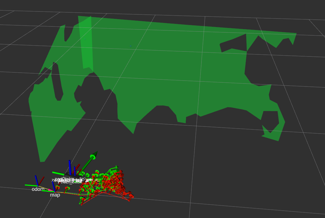

When a message on the topic /clicked_point is received, the node searches for the first plane hitten by a virtual ray starting from the camera optical center and virtually passing through the received 3D point.
If a plane is found, its position and orientation are calculated, the 3D mesh is extracted and all the useful plane information is published as a custom zed_interfaces/PlaneStamped message on the topic /<camera_model>/<node_name>/plane.
A second message of type visualization_msgs/Marker with information useful for visualization is published on the topic /<camera_model>/<node_name>/plane_marker in order to display the plane using a Marker display plugin in Rviz.

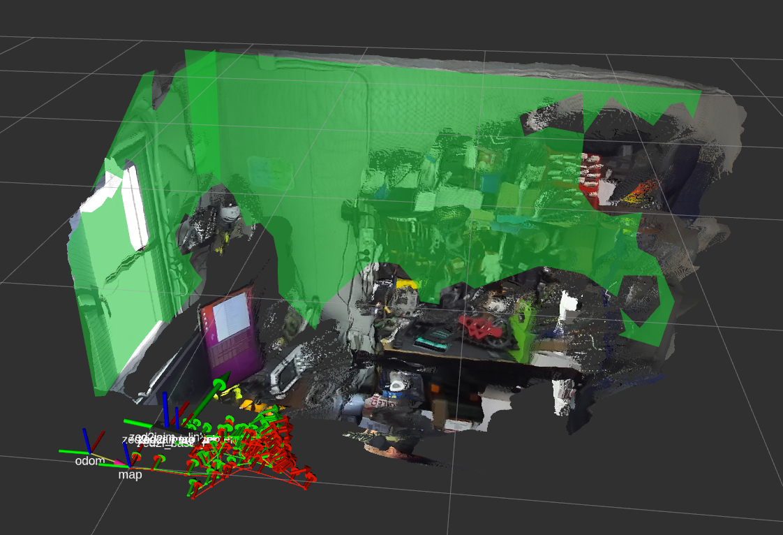

The Rviz GUI allows one to easily start a plane detection task and displays the results of the detection.
Start a plane detection
To publish a /clicked_point point message and start a plane detection the Publish Point button must be enabled and a point of the 3D view or the camera view must be clicked.

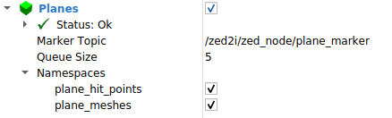

Configure Rviz to display the results
The Marker plugin allows you to visualize the information of the detected planes.
Key parameters:
Marker Topic: The topic that contains the information relative to the detected planes: e.g./zed2i/zed_node/plane_markerQueue Size: The size of the message queue. Use at least a value of2to not lose messages.Namespaces: The list of available information:plane_hit_points: Select to display a sphere where the click has been received.plane_meshes: Select to display all the meshes of the detected planes.
