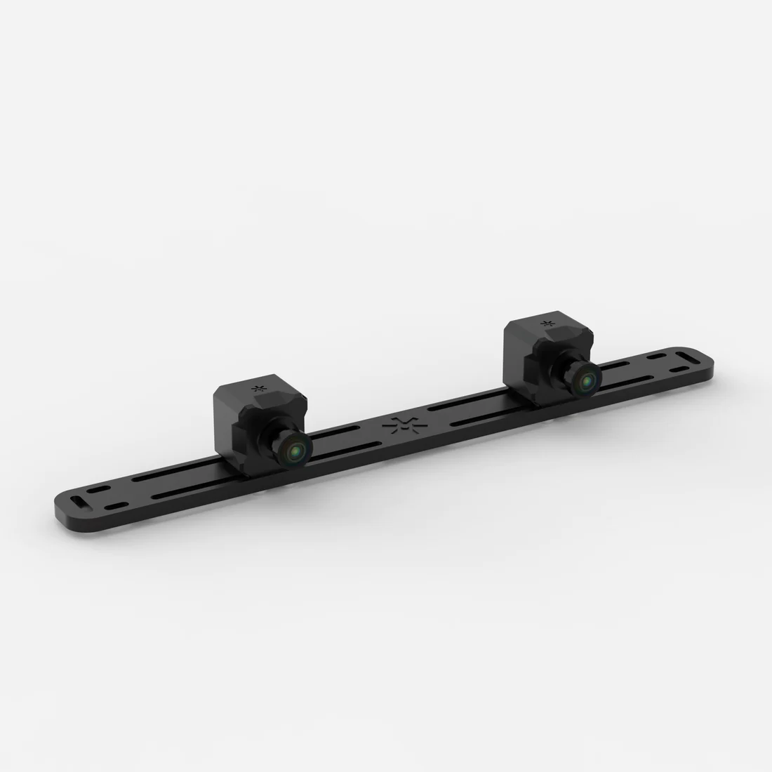

Stereo Camera
The ZED X One can be used in a stereo camera system with a modular baseline. This mode requires to put 2 ZED X Ones side by side at a fixed distance, rigidly mounted. The distance between the cameras will impact the 3D depth range.
Cameras with a small baseline will be able to see accurately very close, while cameras with a larger baseline will have a longer range but the minimum working distance will increase. The lens option will also impact the effective depth range. More information on setting up a stereo rig can be found here.
In a stereo camera configuration, the system will require a calibration procedure once the system is mechanically set up. The calibration will compute the relative position between the 2 ZED X Ones to be later used for depth computation. More information on this step here.
Once the system is calibrated, the ZED X Ones can be used as a standard input in the ZED SDK, and all its features will be available seamlessly.
