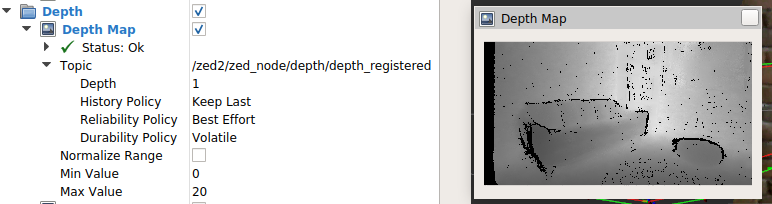

Depth image
To visualize a depth image, you can use the simple Image plugin since the depth data are published on topics of type sensor_msgs/Image. It differs from a “normal” image in that the data is encoded in 32-bit (floating point) not 8-bit.
The parameters are the same as for Image (see the Video tutorial) with three additions:
Normalize range: Since a floating point image is not directly rendered, it is converted to an 8-bit grayscale image. Enabling this field means the normalization range is automatically calculatedMin value: IfNormalize rangeis unchecked, you can manually set the minimum depth range in metersMax value: IfNormalize rangeis unchecked, you can manually set the maximum depth range in meters
Manually setting the normalization range is useful if you know the maximum value measured for the depth and you want to keep the image scale static.

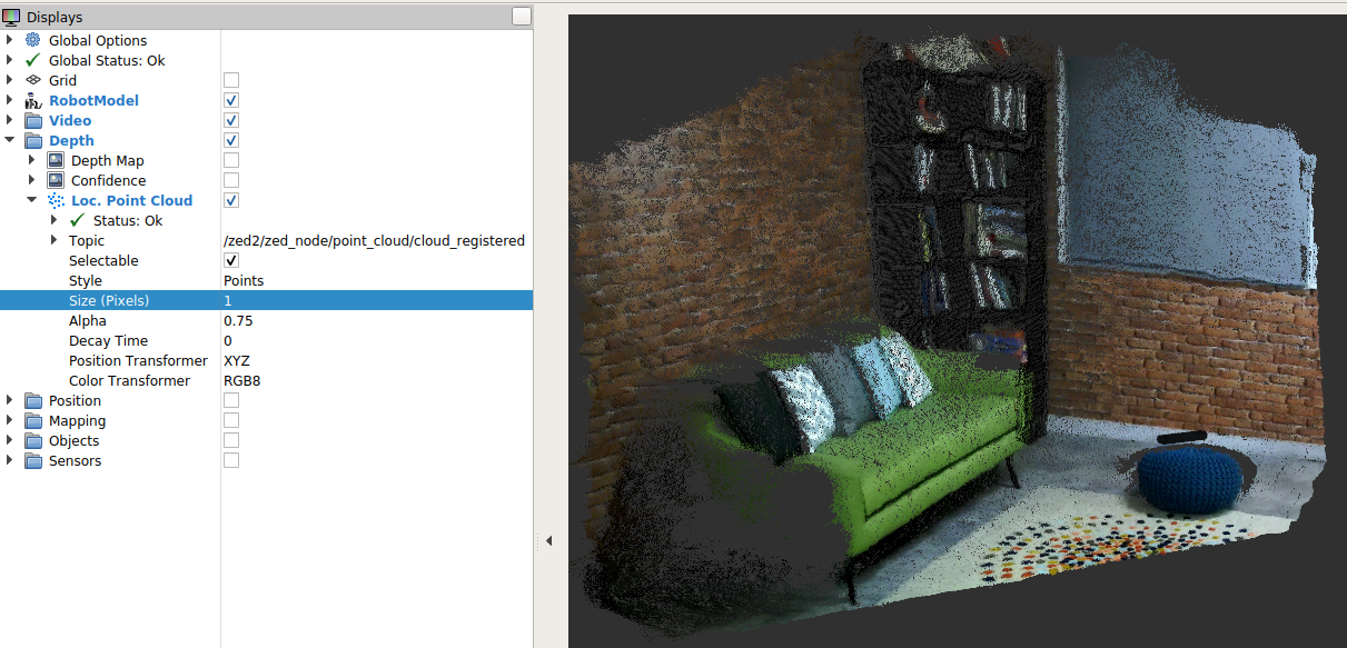

Pointcloud
To directly visualize a topic of type sensor_msgs/Pointcloud2 you can use the Pointcloud2 plugin.
Key parameters:
Topic: Selects the topic to visualize from the list of available point cloud messagesDepth: The depth of the incoming message queueHistory policy: Set the QoS history policy.Keep Lastis suggested for performance and compatibilityReliability Policy: Set the QoS reliability policy.Best Effortis suggested for performances,Reliableis used for compatibilityDurability Policy: Set the QoS durability policy.Volatileis suggested for compatibilityStyle: The style used to render each point. UsePointsandSize=1to maximize FPSColor transformer: Selects how points are colored. UseRGB8to match the color image pixels to the corresponding depth pixels. UseAxis colorto use a color proportional to the value of theAxisvalue (e.g.Zto use a color scale proportional to the distance from the floor orXto use a color proportional to the distance from the camera)
if mapping is enabled (see mapping/mapping_enabled parameter), the Pointcloud2 plugin is used also to visualize the fused point cloud result of the mapping elaboration, subscribing to the topic /zed/zed_node/point_cloud/fused_cloud_registered.

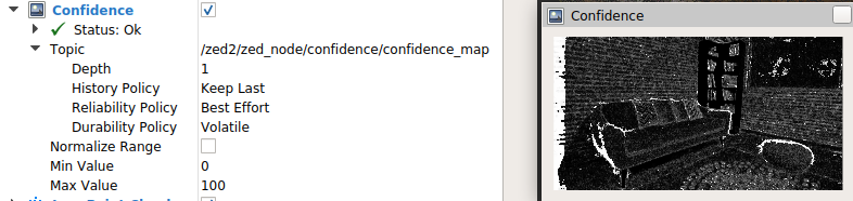

Confidence
To visualize the Confidence Map as an image, you can use the Image plugin subscribing to the topic ~/confidence/confidence_image.
The lighter a pixel, the more reliable its corresponding depth value is.
