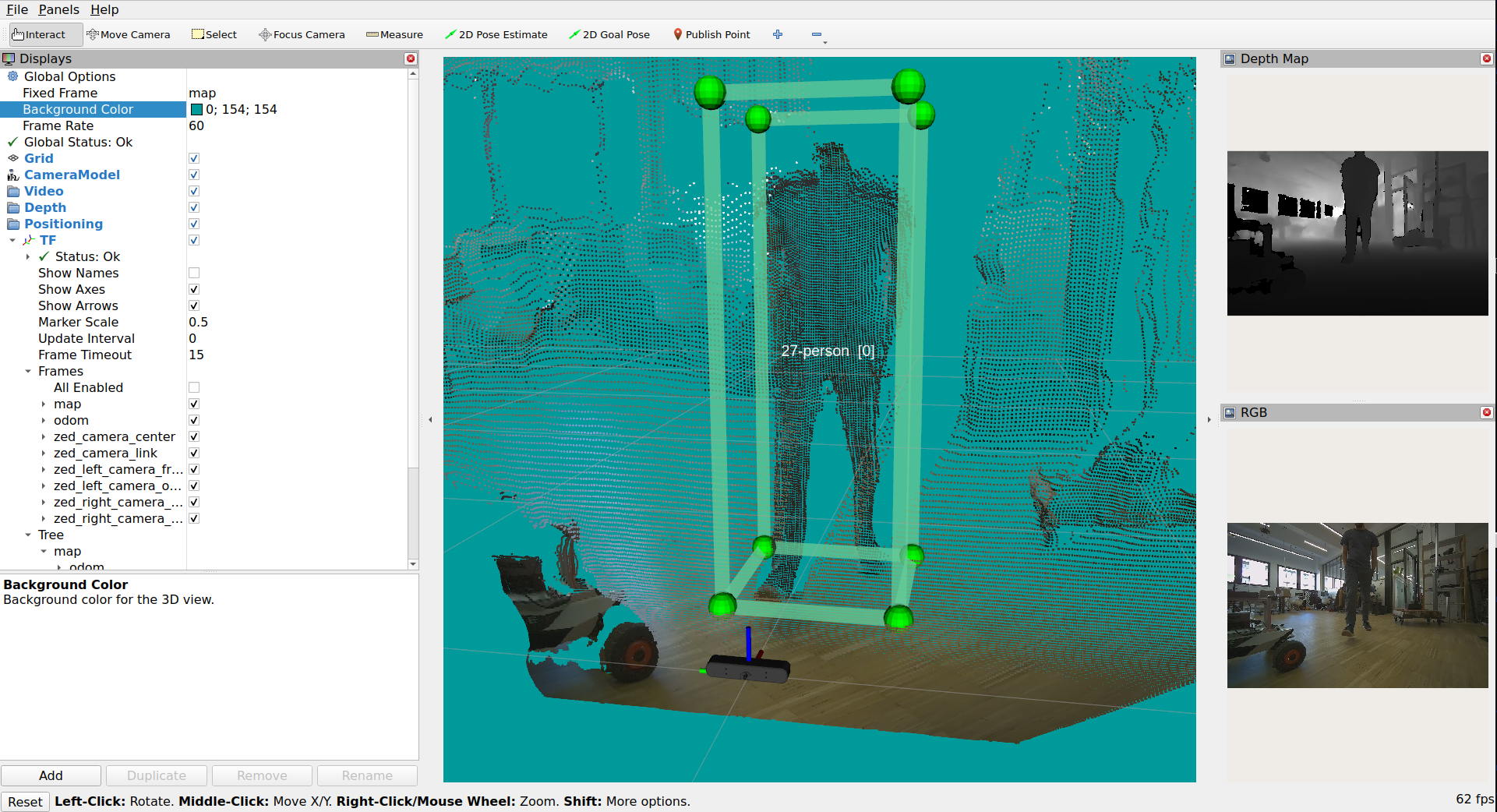

Object Detection and Tracking results
The results of the Object Detection and Tracking processing are published using a custom message of type zed_interfaces/ObjectsStamped defined in the package zed_interfaces.

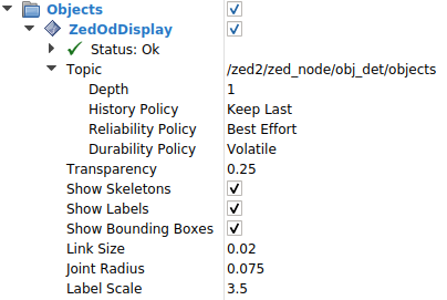

To visualize the results of the Object Detection processing in RViz 2, the ZedOdDisplay plugin is required. The plugin is available in the zed-ros2-examples GitHub repository and can be installed following the online instructions.
The source code of the plugin is a valid example of how to process the data of the topics of type zed_interfaces/ObjectsStamped.
Parameters:
  • Topic: Selects the object detection topic to visualize from the list of available images in the combo box.
  • Depth: The depth of the incoming message queue.
  • History policy: Set the QoS history policy. Keep Last is suggested for performance and compatibility.
  • Reliability Policy: Set the QoS reliability policy. Best Effort is suggested for performance and compatibility.
  • Durability Policy: Set the QoS durability policy. Volatile is suggested for compatibility.
  • Transparency: the transparency level of the structures composing the detected objects.
  • Show skeleton: Not used.
  • Show Labels: enable/disable the visualization of the object label.
  • Show Bounding Boxes: enable/disable the visualization of the bounding boxes of the detected objects.
  • Link Size: the size of the bounding boxes’ corner lines.
  • Joint Radius: the radius of the spheres placed on the corners of the bounding boxes.
  • Label Scale: the scale of the label of the object.
The format of the label of the detected objects is:
<tracking_id>-<label> [<label_id>]
Where:
  • tracking_id is the tracking ID of the detected object, associated by the ZED SDK to the detected object. The tracking ID is unique for each detected object and it is used to identify the object in the tracking process.
  • label is the label of the detected object, corresponding to the value of the parameter label in the configuration file.
  • label_id is the ID of the label of the detected object, corresponding to the value of the parameter model_class_id in the configuration file.
