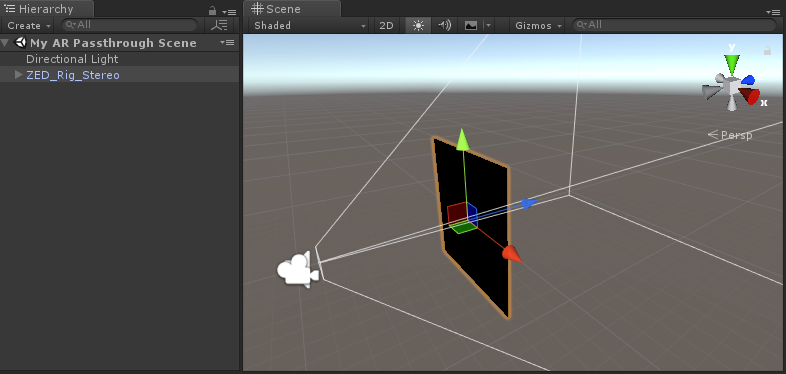

Add the Stereo Rig
  • Follow the steps described in the Build Your First AR/MR App tutorial.
  • In your Hierarchy, delete the ZED_Rig_Mono prefab you added in the last tutorial.
  • In the Project window, go to the ZED -> Prefabs folder. Click and drag the ZED_Rig_Stereo prefab into the Hierarchy window.
