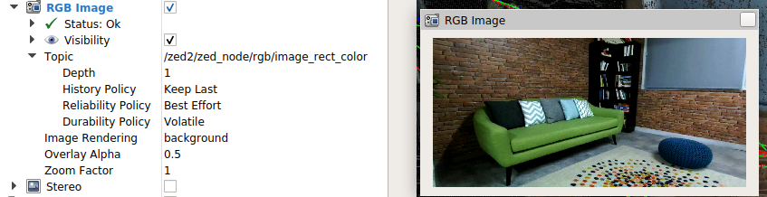

Camera
The Camera plugin allows you to visualize an image from a topic of type sensor_msgs/Image. It acts as if the source of the image is placed on its virtual frame and renders all virtual objects in front of it.
Key parameters:
  • Topic: Selects the image topic to visualize from the list of available images in the combo box
  • Depth: The depth of the incoming message queue
  • History policy: Set the QoS history policy. Keep Last is suggested for performance and compatibility
  • Reliability Policy: Set the QoS reliability policy. Best Effort is suggested for performance, Reliable is used for compatibility
  • Durability Policy: Set the QoS durability policy. Volatile is suggested for compatibility
By expanding Visibility, you can select/deselect what will be visible in the camera view. Only active plugins can be selected.

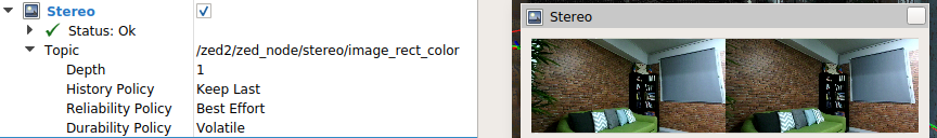

The Image plugin allows you to visualize an image from a topic of type sensor_msgs/Image.
Key parameters:
