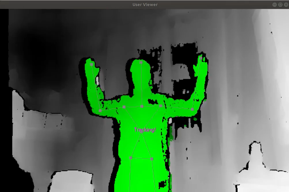

NiTE 2 integration
The ZED OpenNI2 driver is compatible with the NiTE v2.2 framework. To execute the precompiled example available with NiTE simply copy the ZED driver file (libzeddriver.so [Linux] or libzeddriver.dll [Windows])in the folder Samples/Bin/OpenNI2/Drivers under the root of the NiTE installation folder. NiTE will automatically load the new driver searching for a connected ZED camera when starting.
