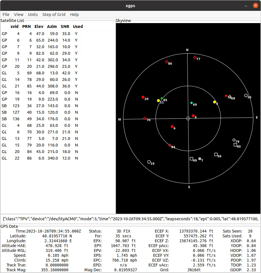

You can test that gpsd is working properly with the tool installed with gpsd:
$# GNSS and satellite data in graphical interface
$xgps
xgps screenshot
