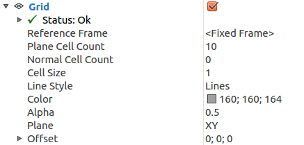

Grid
This plugin displays a grid, typically representing the floor plane, to provide spatial reference within the 3D scene. The grid helps orient objects and frames in RViz 2, making it easier to interpret positions and relationships in the environment.
Key parameters:
  • Reference frame: The frame used as a reference for the grid coordinates (normally: <fixed_frame>)
  • Plane cell count: The size of the grid in cells
  • Normal cell count: The number of cells in the direction normal to the grid plane (normally: 0)
  • Cell size: Dimensions in meters of each grid cell
  • Plane: The two axes that identify the grid plane

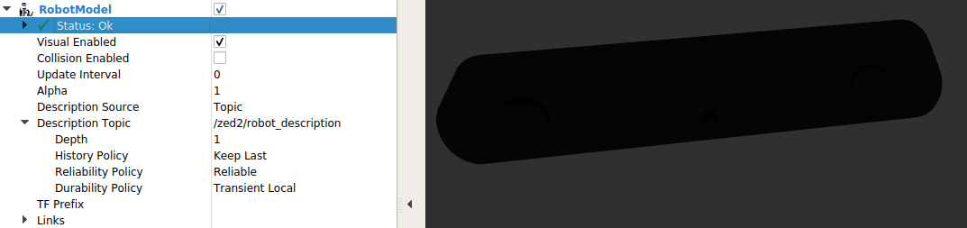

Robot model
This plugin enables visualization of the robot’s 3D model as defined by its URDF (Unified Robot Description Format) file. It provides a graphical representation of the robot’s structure, including its links and joints, allowing you to inspect the robot’s configuration and verify that the model is correctly loaded in RViz 2.
Key parameters:
  • Visual enabled: Enable/disable the 3D visualization of the model
  • Description Source: You can choose between File and Topic. At the moment of writing this guide the Topic option is not working as expected, so File is the right option
  • Description File: the URDF file that contains the Robot Description zed.urdf or zedm.urdf.
By expanding the Links item, you can see the whole model tree, with all the joints and the links available and the relative position and orientation in the space relative to the fixed frame.

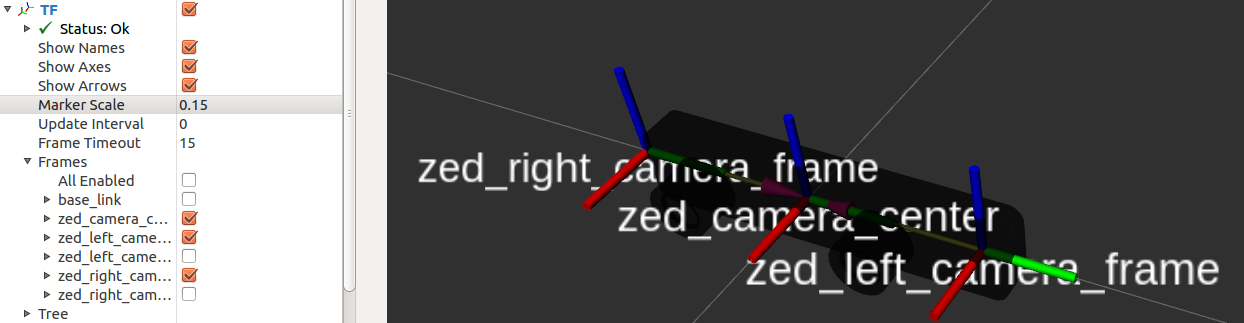

TF
The TF plugin provides a visual representation of the entire transform (TF) tree, displaying the position and orientation of all coordinate frames in your system. This helps you understand the spatial relationships between different parts of your robot and environment, making it easier to debug frame alignment and connectivity issues.
Key parameters:
  • Show names: Enable/disable the 3D visualization of link names
  • Show axes: Enable/disable the 3D visualization of the axes of the frames
  • Show arrows: Enable/disable the 3D visualization of the arrows that connect the various frames
  • Marker Scale: Used to rescale all the TF objects to let them be more visible and less chaotic
  • Update interval: The update time in seconds. Leave at 0 to see each update
A key feature of the TF plugin is the ability to selectively enable or disable the visualization of individual frames. This flexibility lets you focus on specific parts of the transform tree relevant to your current task, reducing visual clutter and making it easier to analyze relationships between frames.
