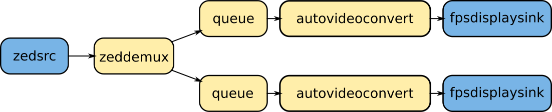

Split the stereo couple and display single streams
Following a simple pipeline to display on the screen the Left and Right color streams in two different windows:
Split the RGB/Depth synchronized stream and display single streams
The same pipeline of the previous example can be used to display left camera stream and Depth stream in separate windows by simply selecting the stream-type 4 and using the default properties of zeddemux
