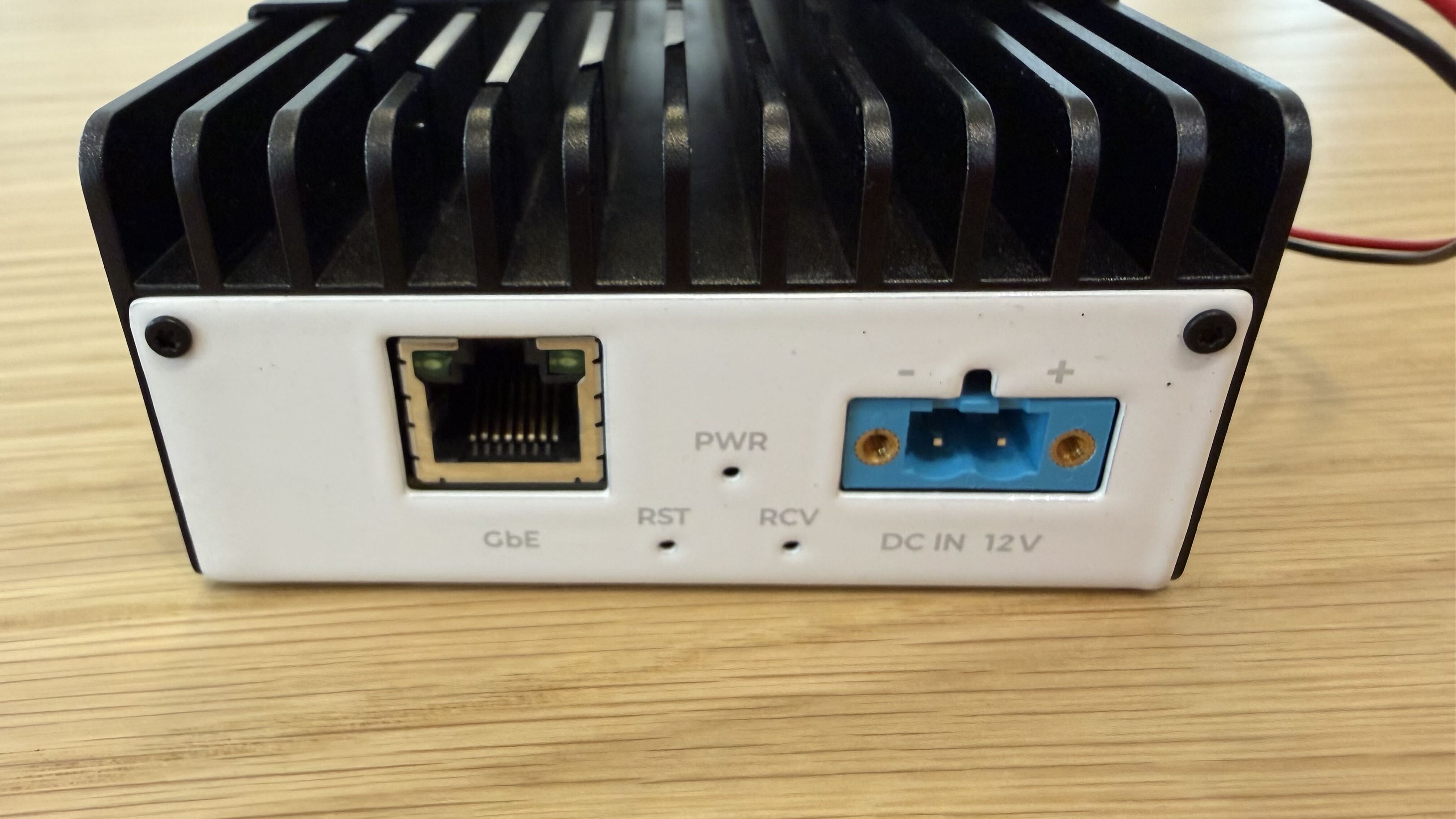

2. Check the Power LED Status
Locate the power LED on the front panel and determine its status:
🟢 LED is ON
  • This indicates a software issue requiring a hard reset of the device.
  • The ZED Box software may have been corrupted due to an improper shutdown.
  • Important: Always shut down the device properly by software before removing power to avoid software corruption.
⚫ LED is OFF
  • If you have already tried the power cable procedure, this suggests a hardware failure.
  • Contact StereoLabs Support for further assistance.

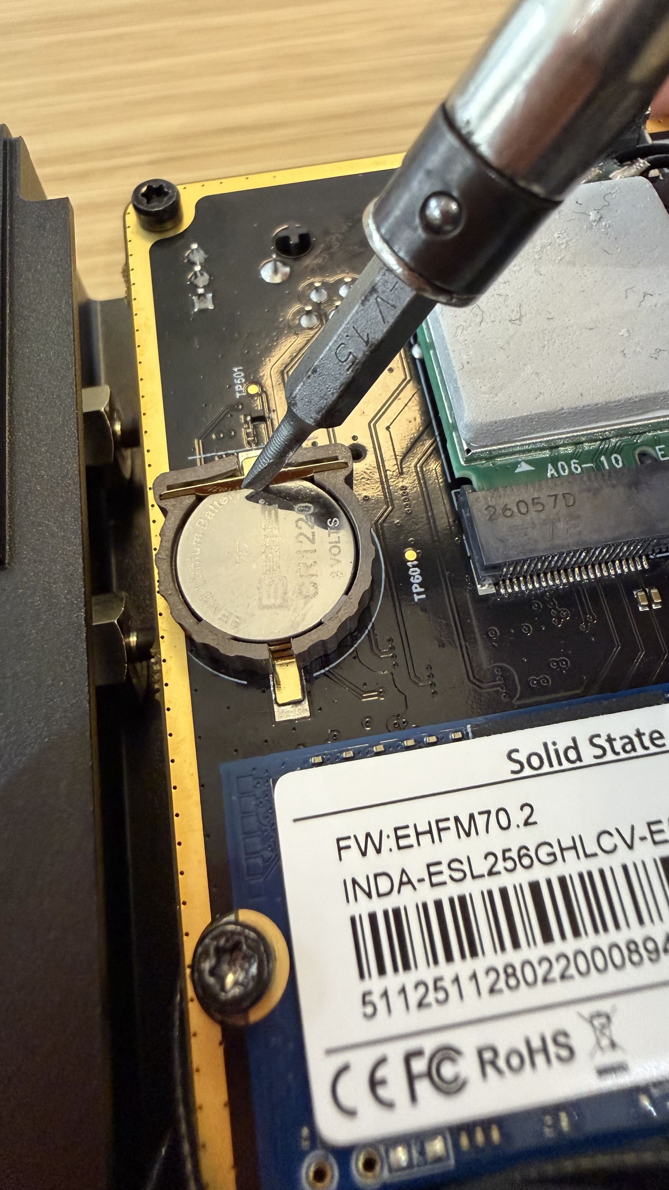

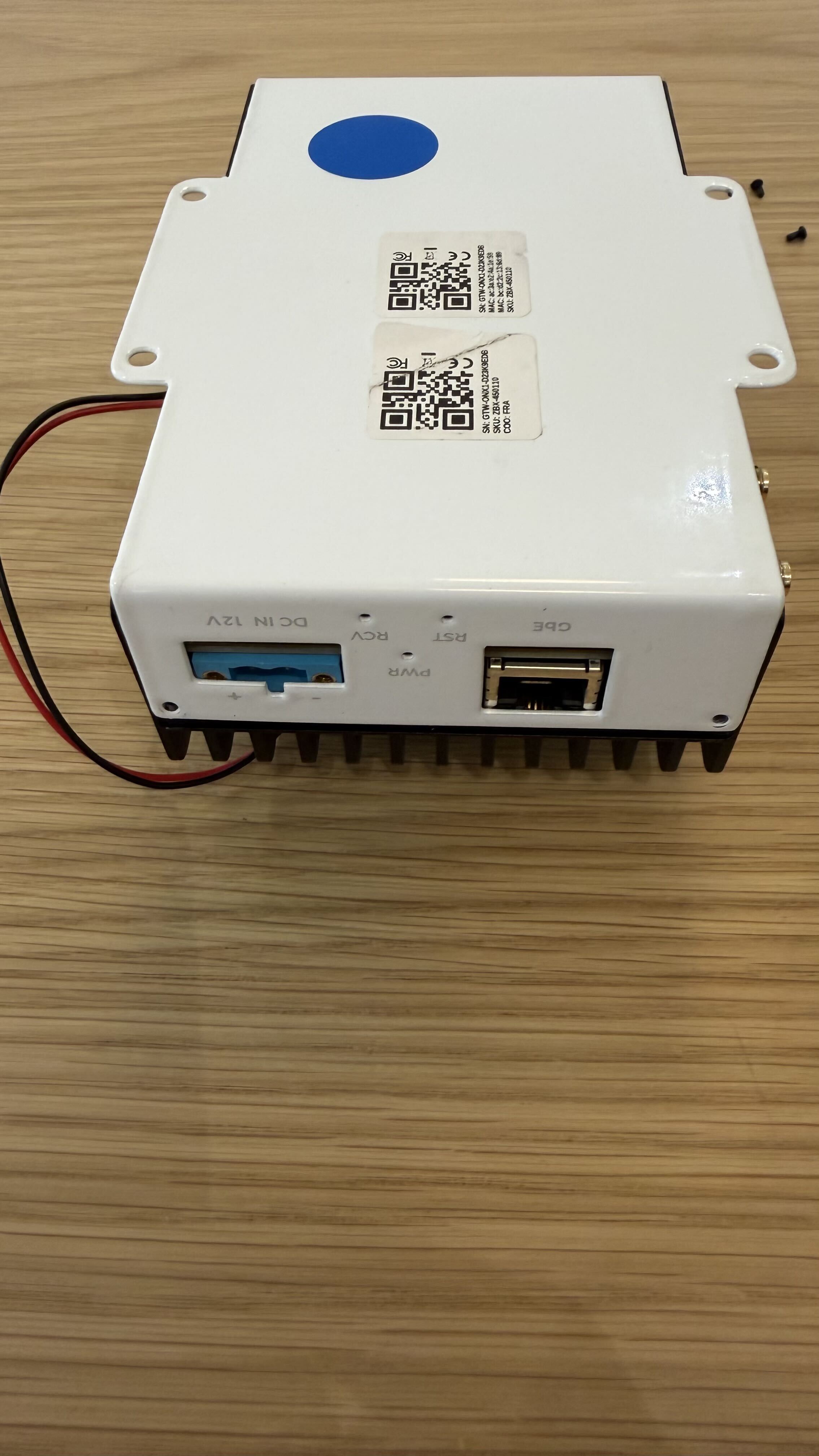

ZED Box Mini not keeping date and time when powered off
If the ZED Box Mini or the Mini Carrier Board loses the date and time when you boot it after a few days without power, and no internet connection is available, the Real Time Clock (RTC) battery is discharged and must be replaced.
The ZED Box Mini requires the enclosure to be opened (steps 3, 4, 5, and 8). On the Mini Carrier Board the battery holder is directly accessible on the bottom side of the board, so these steps do not apply.
  1. Get a new CR1220 3V lithium coin cell battery to replace the discharged one.
  2. Shut down the device, then disconnect the power supply, the Ethernet cable, and all the USB and GMSL2 peripherals.

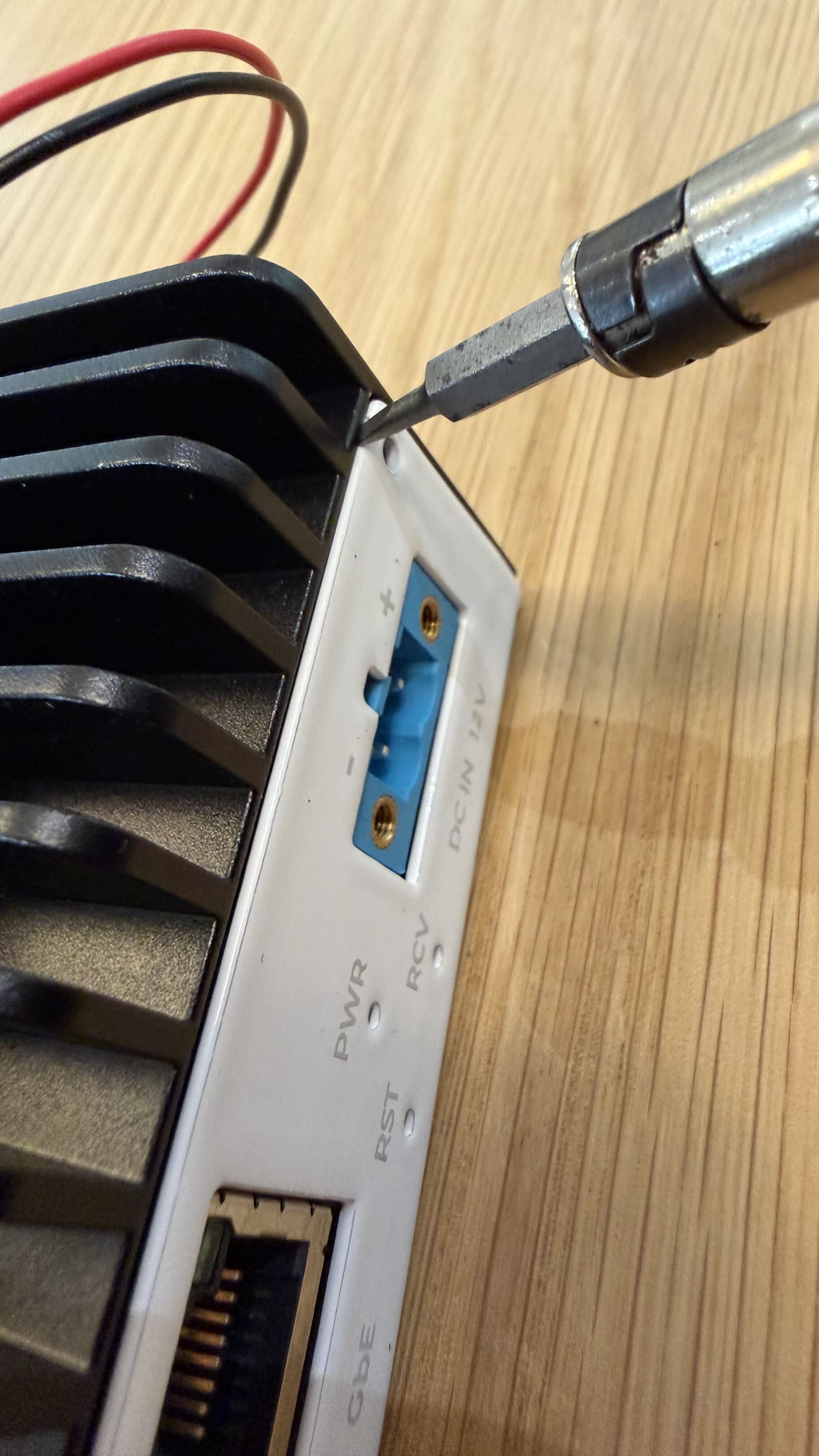

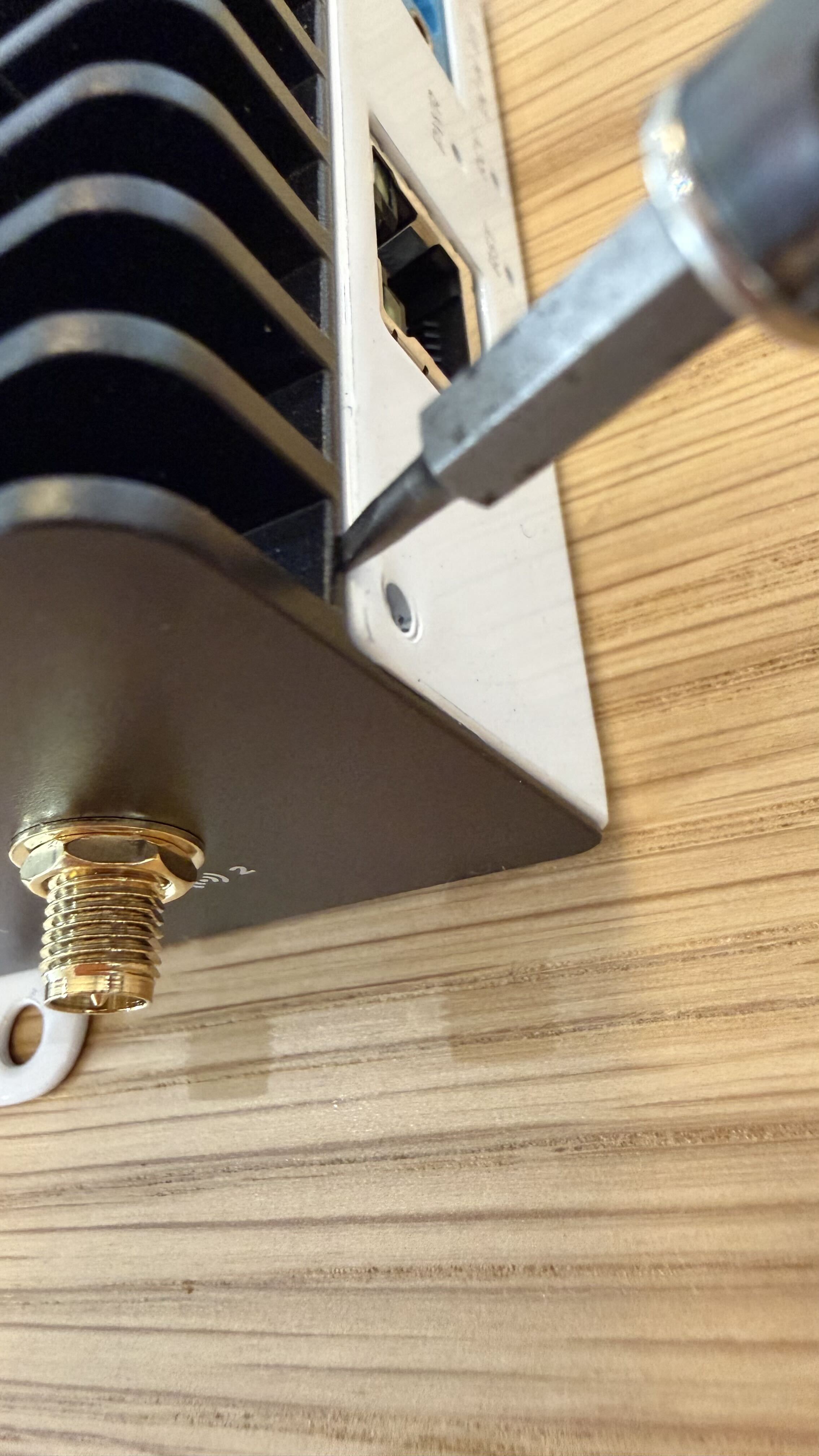

  3. Prepare a screwdriver with a Torx T-6 bit and a small flat-blade tool.

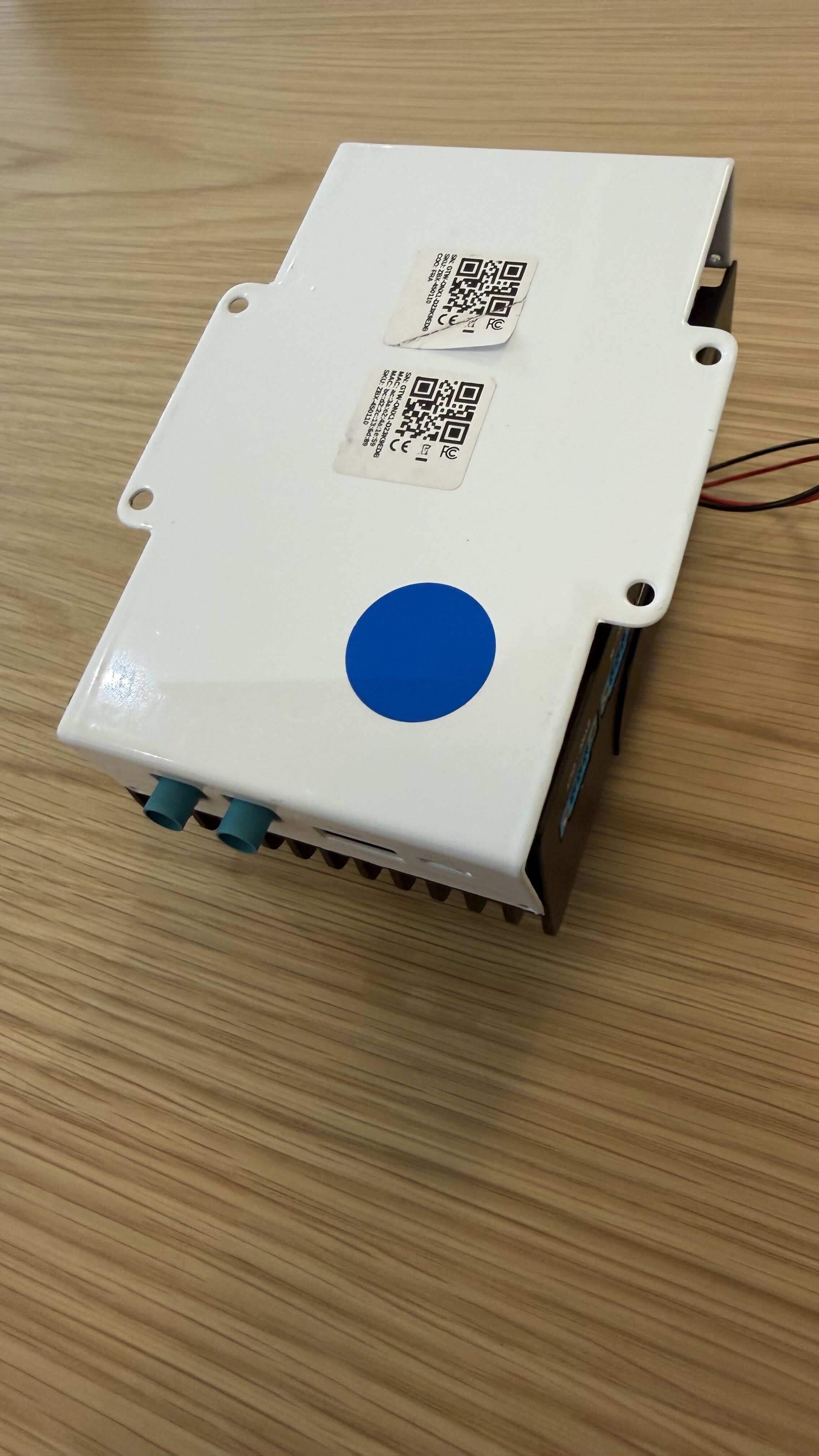

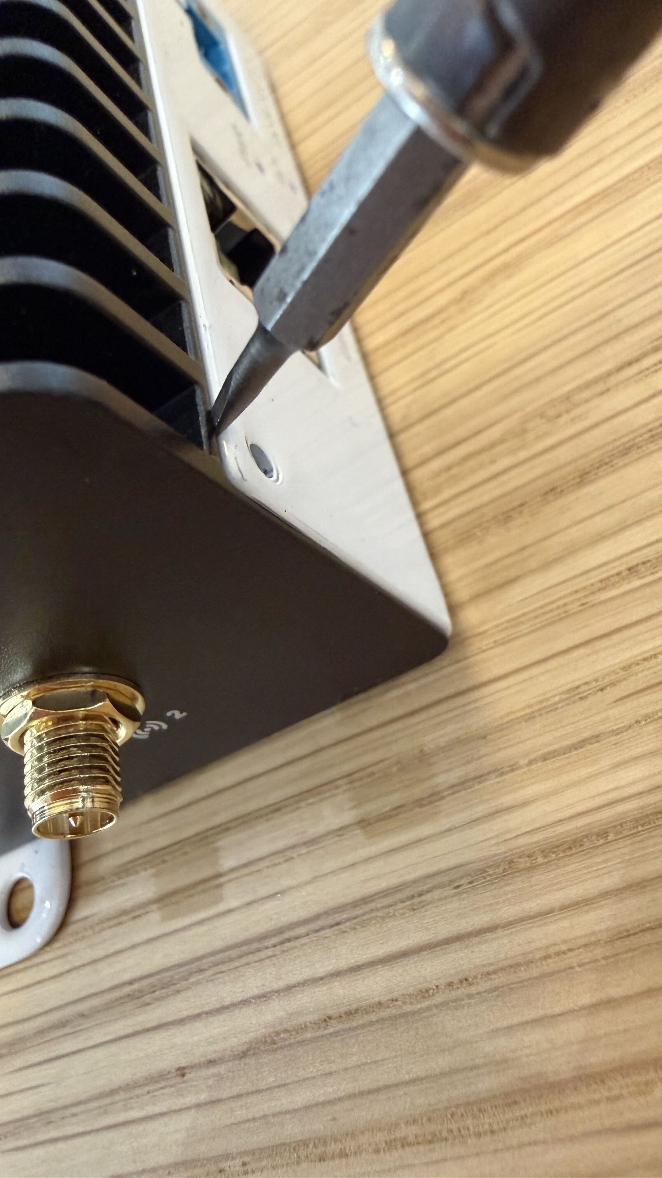

  4. Remove the four screws located at the corners of the front and rear panels using the Torx T-6 bit, then use the flat-blade tool to gently pry the white cover away from the black heatsink to release it.

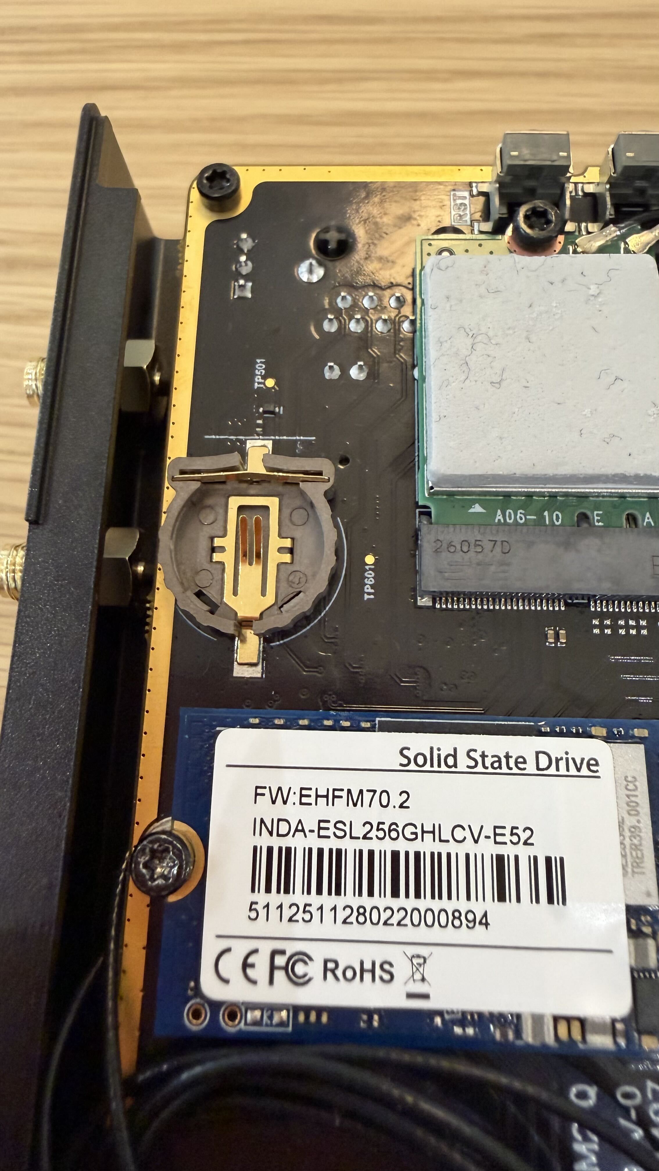

  5. Turn the device upside down and lift the white cover off to expose the bottom side of the carrier board.
  6. Pry the discharged battery out of its holder using the flat-blade tool.
  7. Insert the new battery in the holder, with the marked positive (+) face upward.
  8. Refit the white cover and drive the four screws back in place using the Torx T-6 bit.
  9. Power on the device and set the correct date and time. You can use the date command, for example sudo date --set="2026-01-31 14:30:00", or connect the device to the internet to retrieve the current time from a time server, if automatic time synchronization is enabled.
