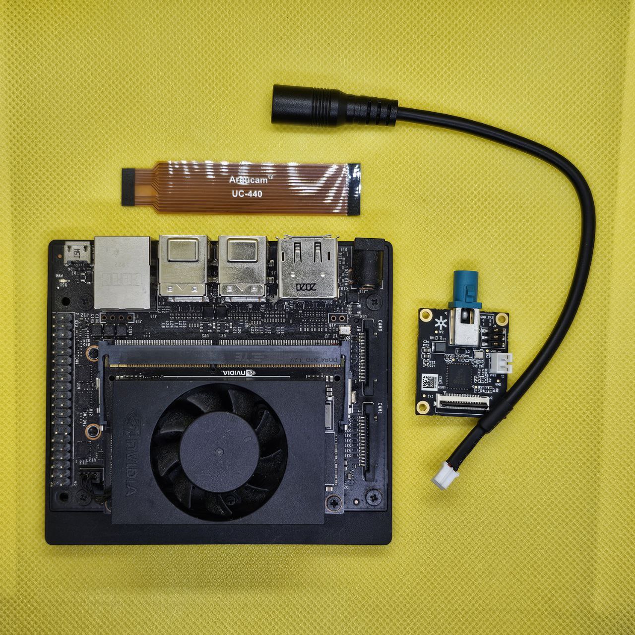

  • 1x NVIDIA® Jetson™ Xavier NX Developer Kit.
  • 1x ZED Link Mono GMSL2 capture card
  • 1x NVIDIA® Power supplier to power the Development Kit (included with the devkit)
  • 1x FPC Camera Cable 22-pin 0.5mm Pitch to 15-pin 1.0mm Pitch (not included)*
  • 9V-14V (min 2W) power input (Barrel Jack 5.5 mm outer diameter, 2.5 mm inner diameter) to power the GMSL2 capture card (not included)
* You can find the FPC Camera Cable 22 pin 0.5 pitch to 15-pin 1mm pitch at UCTRONICS.
MIPI cables carry high-speed video signals, and longer cables can introduce noise or signal degradation. For optimal performance, use cables no longer than 15 cm.
ZED Link Mono Xavier NX material

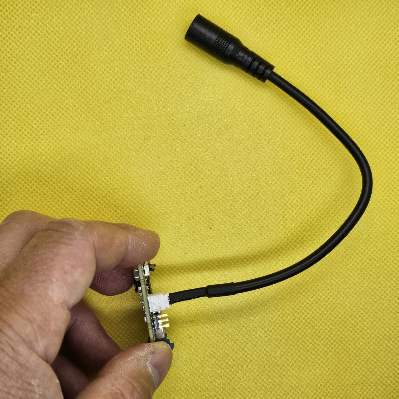

ZED Link Mono power connection

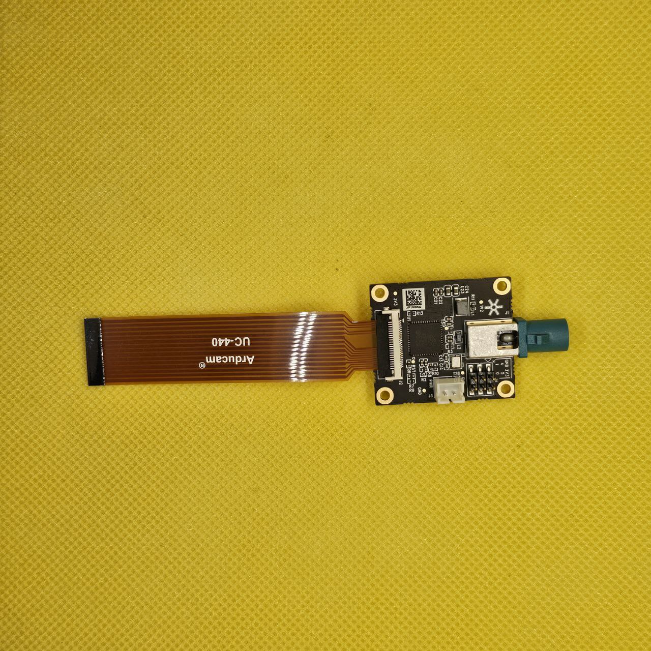

Connect the CSI cables at the MIPI 22-pin port of the capture card. Make sure the correct side is plugged in.
ZED Link Mono Xavier NX MIPI connection

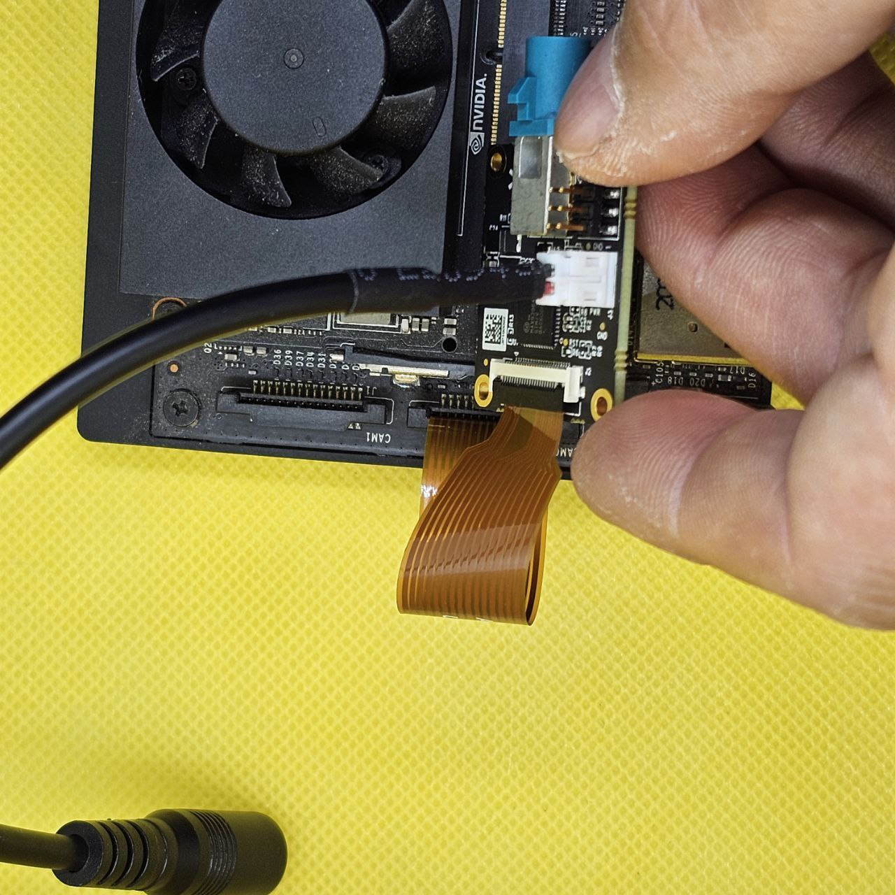

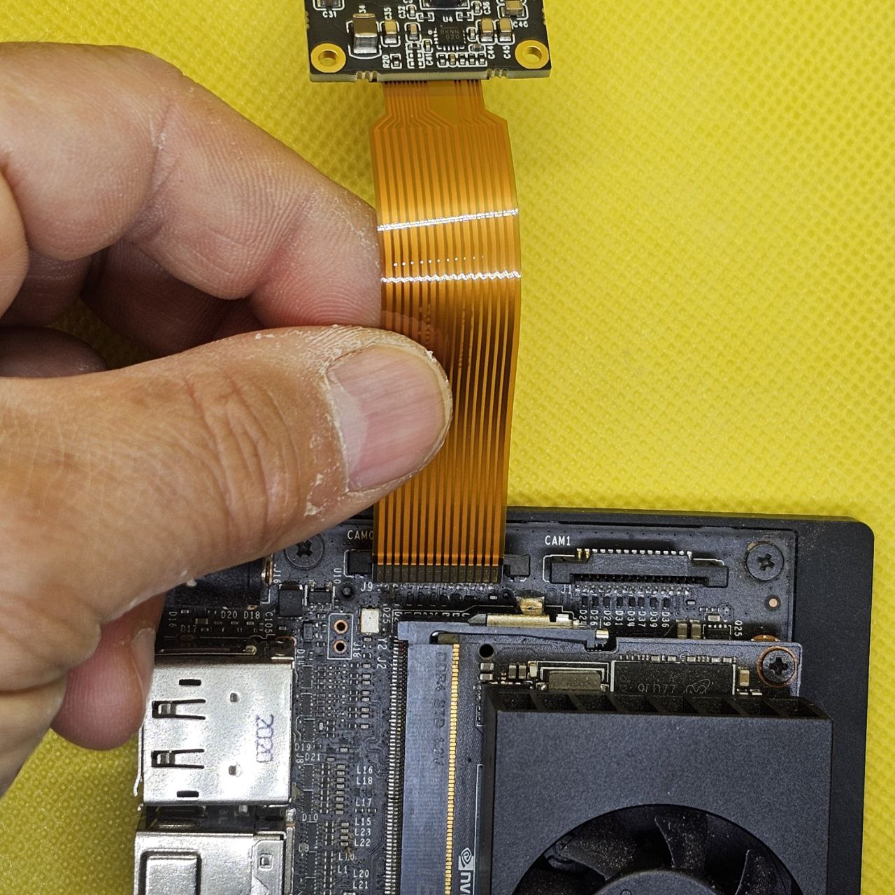

Cabling the Carrier Board
ZED Link Mono Xavier NX MIPI carrier connection
ZED Link Mono Xavier NX MIPI carrier both connections

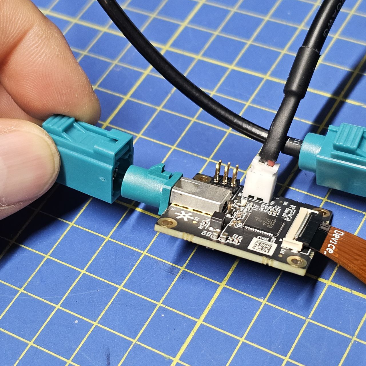

With the capture card still powered off, connect the female end of the cable to the capture card’s GMSL2 input. Again, a click informs you that the cable is secured.
ZED Link Mono FAKRA connection
GMSL2 cameras must be ideally plugged before booting up. If it is not the case, you can restart the zed_x_daemon that will be installed by the driver in the next section.
Once the cables are connected, plug the power for the GMSL2 capture card (9V-14V) so that cameras will be powered through the FAKRA cable (PoC).
Power adapter connection
