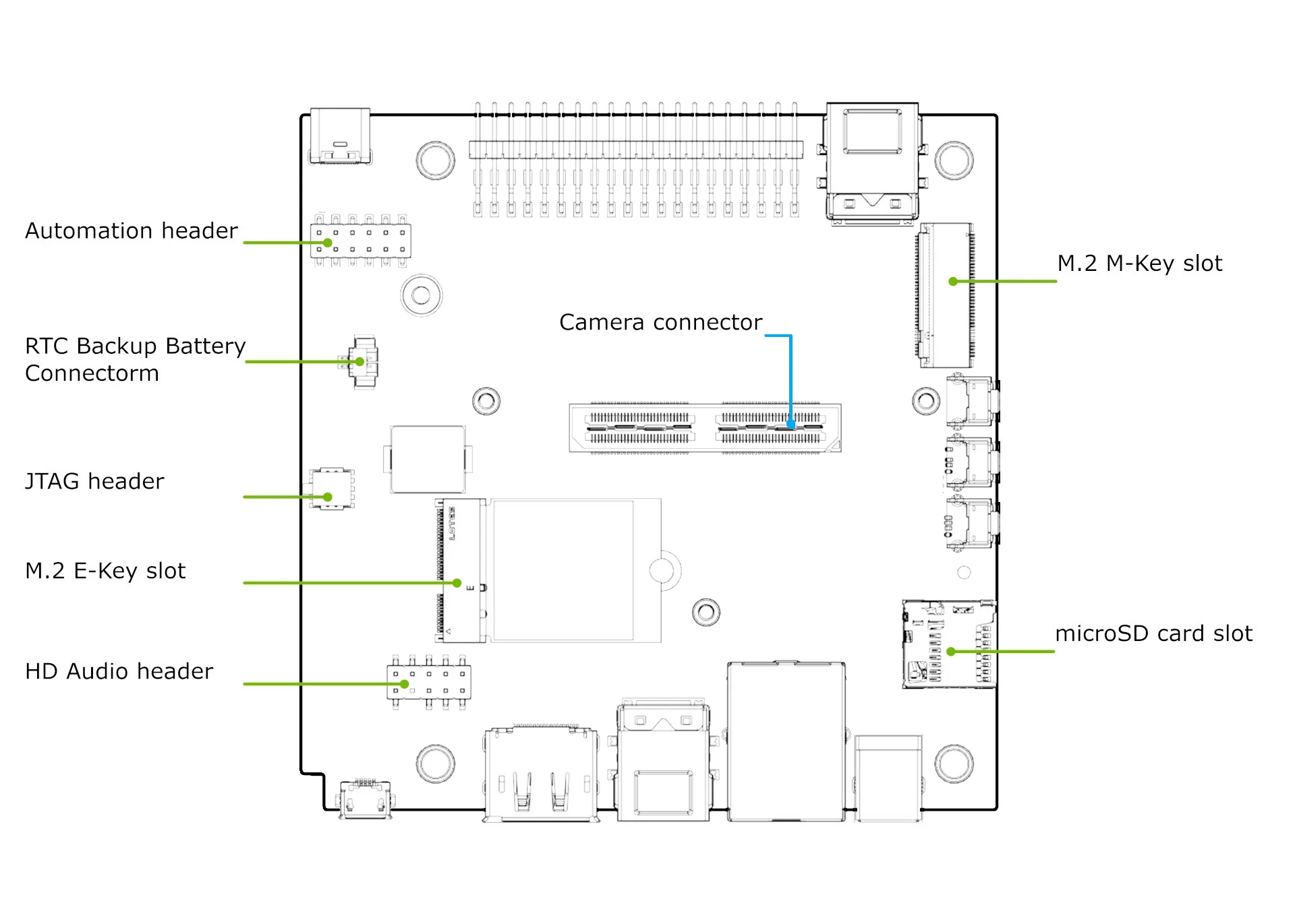

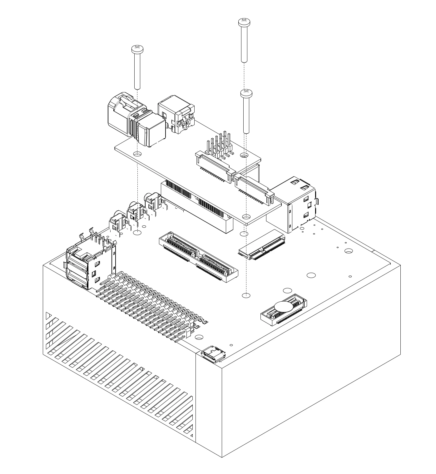

Plug in the capture card in the ‘Camera connector’ slot and fix it by using the three provided screws, as shown in the following diagrams:
AGX Orin bottom view
AGX Orin capture card installation

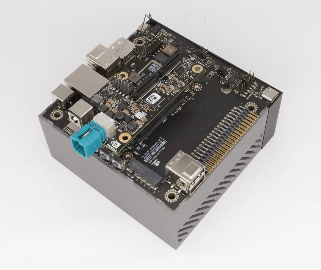

The capture card is powered by the Dev Kit, therefore you do not need to use an additional power supply for the card.
Capture card on AGX

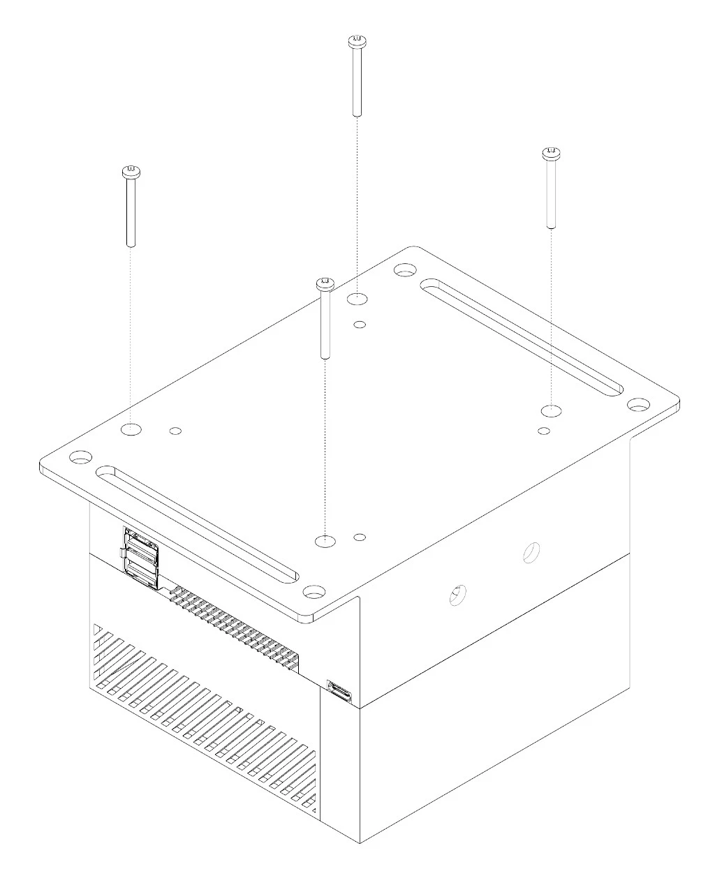

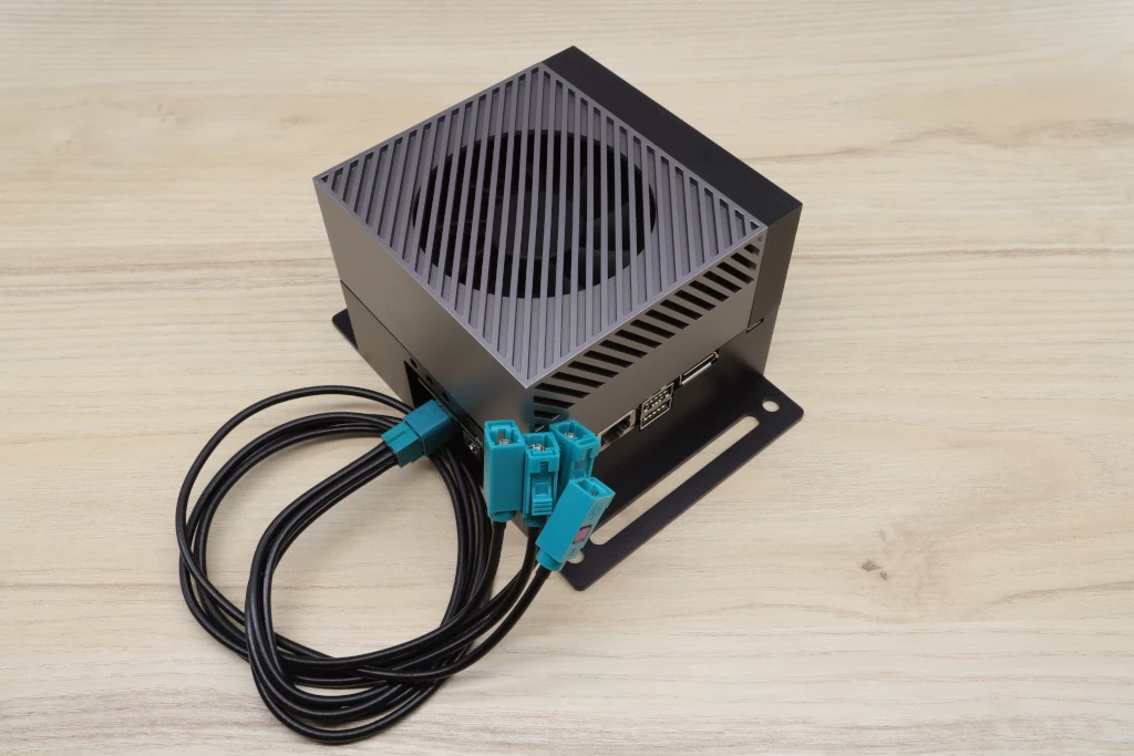

If you are using an AGX Orin Developer Kit, we recommend you use the Enclosure for the AGX Orin Developer Kit available for purchase on the StereoLabs store, to securely integrate our GMSL2 Capture Card while keeping the electronics safe. It also allows you to mount the Dev Kit on any surface using VESA 75x75, and gives the possibility to add WiFi antennas to boost your AGX Orin wireless transmissions.
AGX Orin with enclosure
AGX Orin enclosure installation

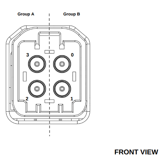

ZED Link Duo connections
Camera TypeCamera ModelMax number of cameras per GroupMax Resolution/FPS per Group
MonocularZED X One GS / ZED X One SUp to 2 camerasHD1200@60fps / HD1080@60fps / SVGA@120fps
MonocularZED X One 4k1 camera (only to port #0, #2)4k@15fps / HD1080@60fps / SVGA@60fps
StereoZED X / ZED X Mini1 CameraHD1200@60fps / HD1080@60fps / SVGA@120fps
StereoZED X / ZED X MiniUp to 2 CamerasHD1200@30fps / HD1080@30fps / SVGA@60fps
MixedZED X One GS/ZED X One S + ZED X/ZED X Mini1 ZED X One GS/S + 1 ZED X/MiniHD1200@60fps / HD1080@60fps / SVGA@120fps
