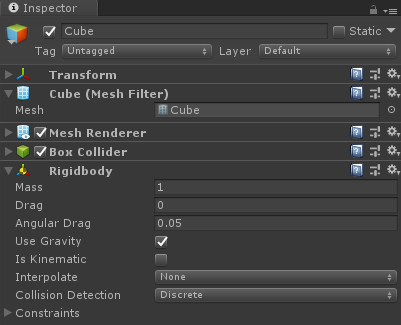

  • Add a RigidBody component to the cube.
The RigidBody component adds gravity. When you add it, it’ll fall down and land on your real-world floor.

  • Add the RigidBody component to the cube again.
