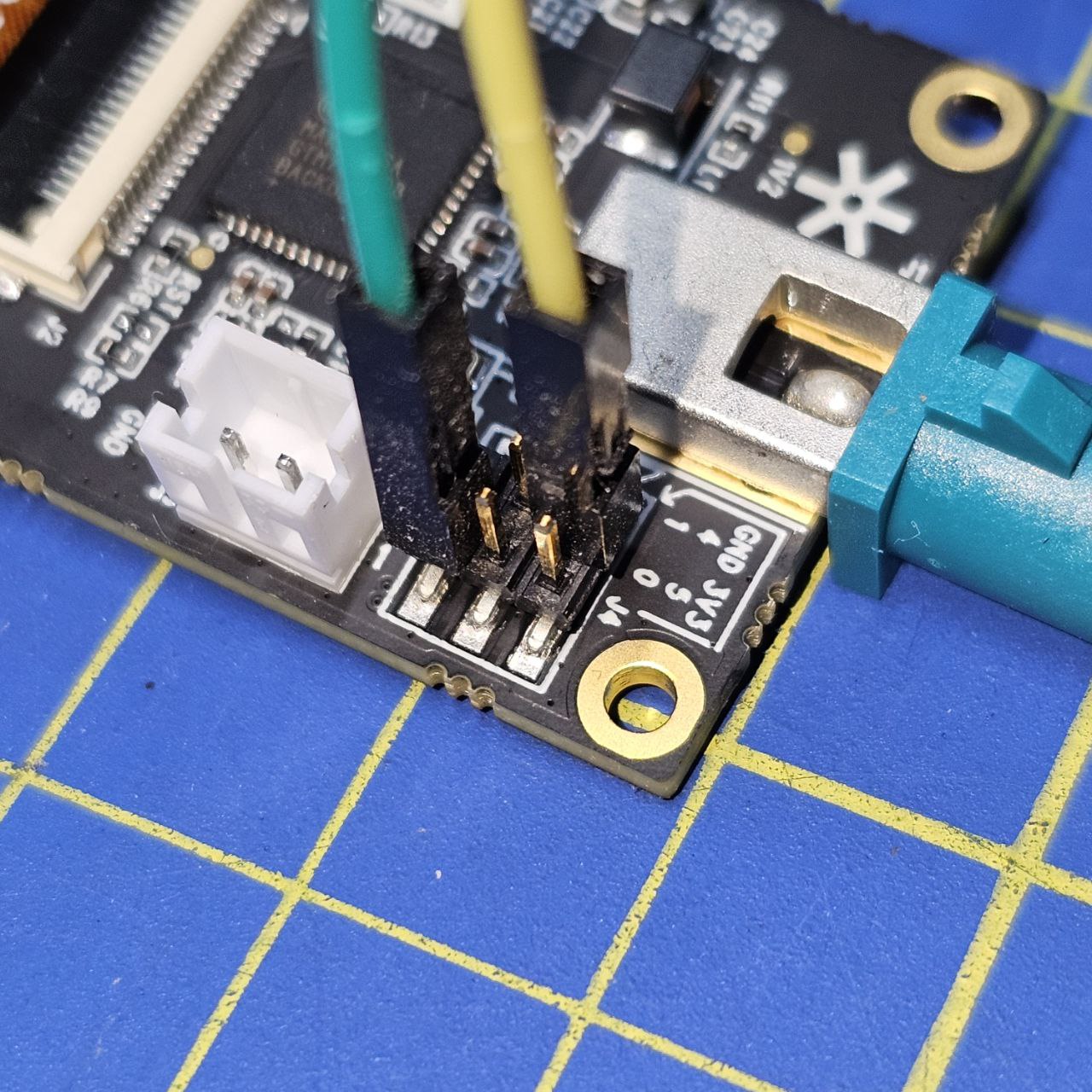

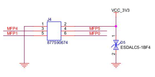

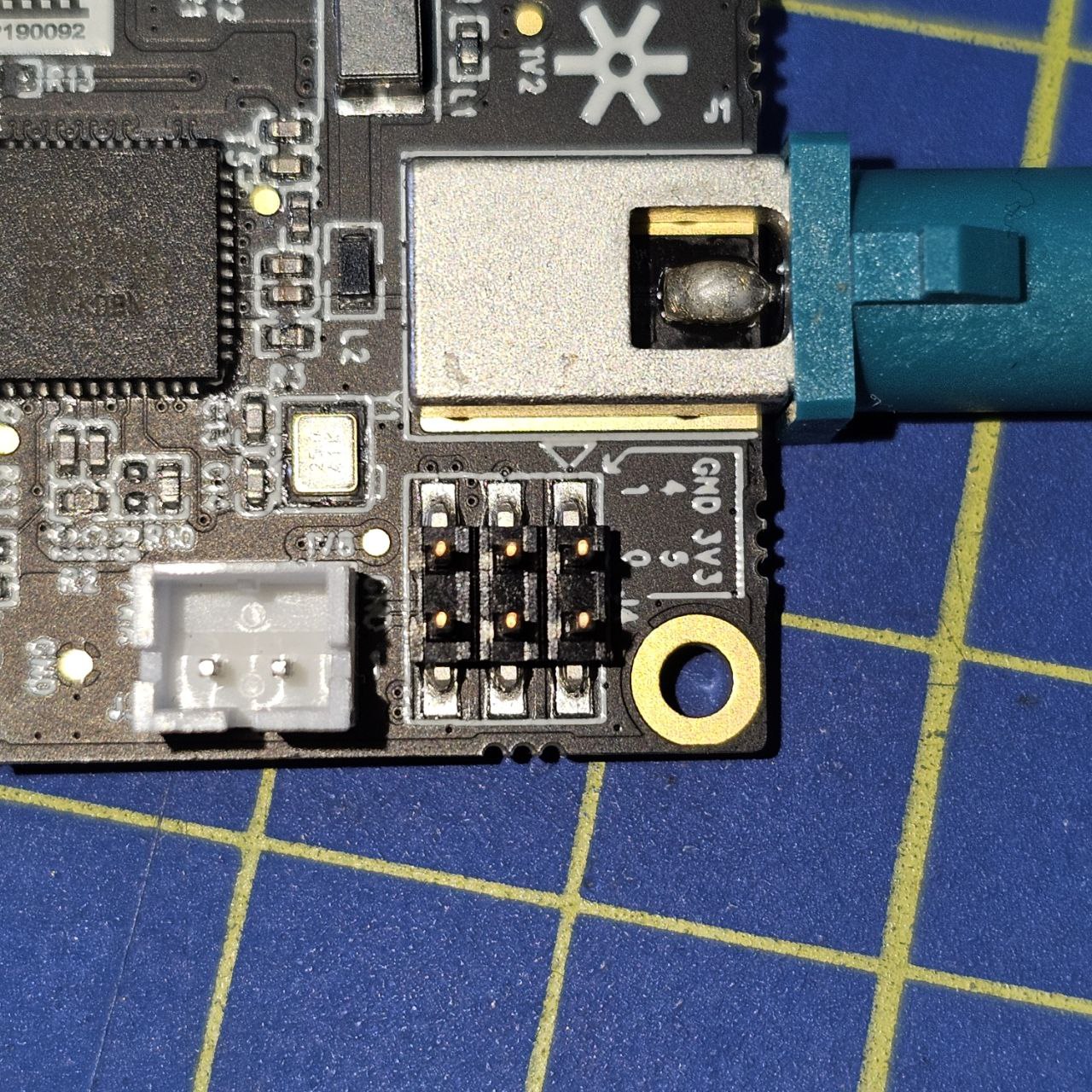

The output synchronization signal is available on pin #6 of the GPIO connector J4 as soon as the Jetson™ device boots and the ZED Link GMSL2 driver is installed.
  • Connect the ground signal (Yellow - GND) to pin #1.
  • Connect the trigger out signal (Green - MFP0) to pin #6.

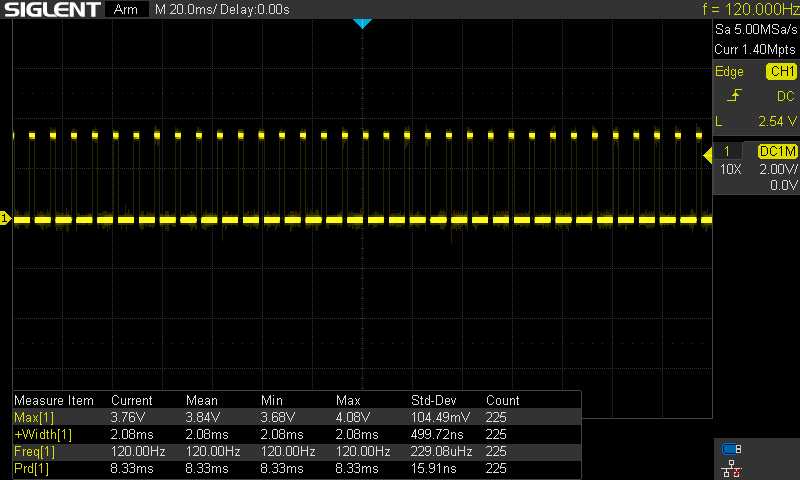

The output trigger signal is a square wave, with its rising edge synchronized with the end of the exposure phase of the CMOS sensor.
The signal has a fixed Amplitude of 3.75V +/- 12%, while Width and Frequency change according to the frame rate setting of the camera.
Frame rate: 120 FPS - ZED X / ZED X Mini / ZED X Nano / ZED X One GS / ZED X One S
  • Amplitude: 3.75V +/- 12%
  • Width: 2.08 msec
  • Frequency: 120 Hz
  • Period: 8.33 msec

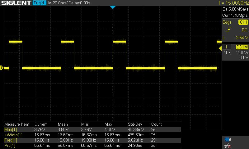

Frame rate: 15 FPS - ZED X / ZED X Mini / ZED X Nano / ZED X One GS / ZED X One S / ZED X One 4K
  • Width: 16.67 msec
  • Frequency: 15 Hz
  • Period: 66.67 msec

  3. Connect PIN #1 (GND) to the ground signal of the trigger source.
  4. Connect PIN #5 (TRIG_IN - MFP1) to the trigger input signal, i.e., a 3.3V square wave signal.

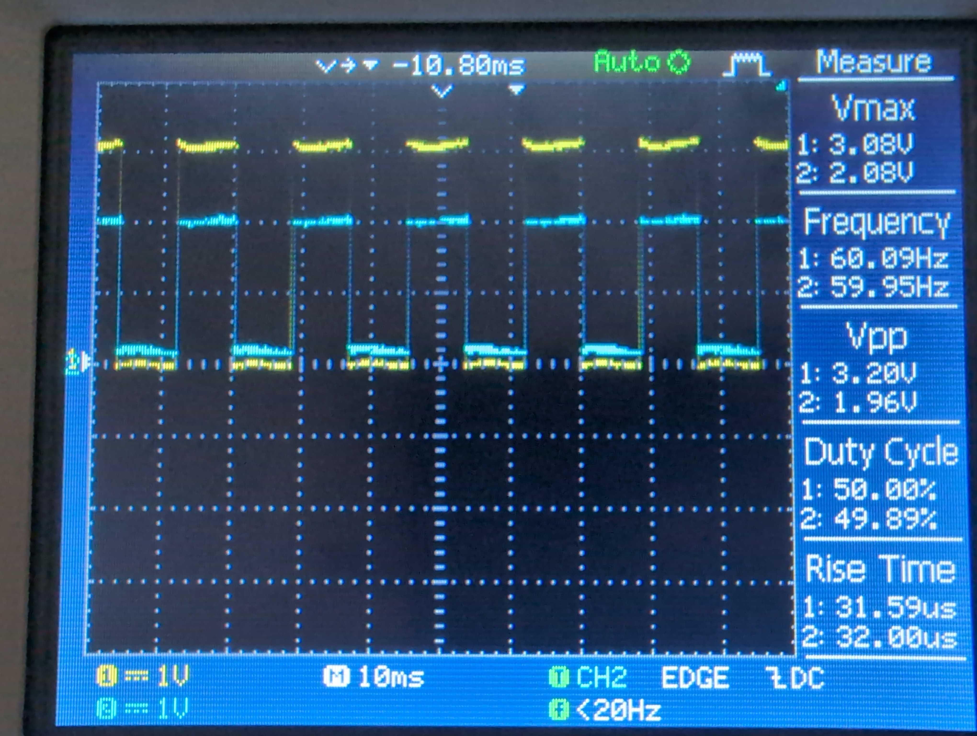

When using multiple ZED Link Mono capture cards on the same NVIDIA® Jetson platform (i.e., 2x ZED Link Mono on an NVIDIA® Jetson Orin Nano), it’s possible to synchronize them together by using the trigger out signal of one card as the trigger in signal for the other card.
The first GMSL2 deserializer will automatically be configured as master, while the second one will operate in slave mode.
  1. Set sync_mode=1 in the file /etc/systemd/system/zed_x_daemon.service to enable the external trigger input.
    $sudo sed -i 's/^sync_mode=./sync_mode=1/' /etc/systemd/system/zed_x_daemon.service
  2. Reload the systemd configuration:
    $sudo systemctl daemon-reload
  3. Connect together the PIN #1 (GND) of both ZED Link Mono cards.
  4. Connect the PIN #6 (TRIG_OUT - MFP0) of the first card to the trigger input signal PIN #5 (TRIG_IN - MFP1) of the second card.
