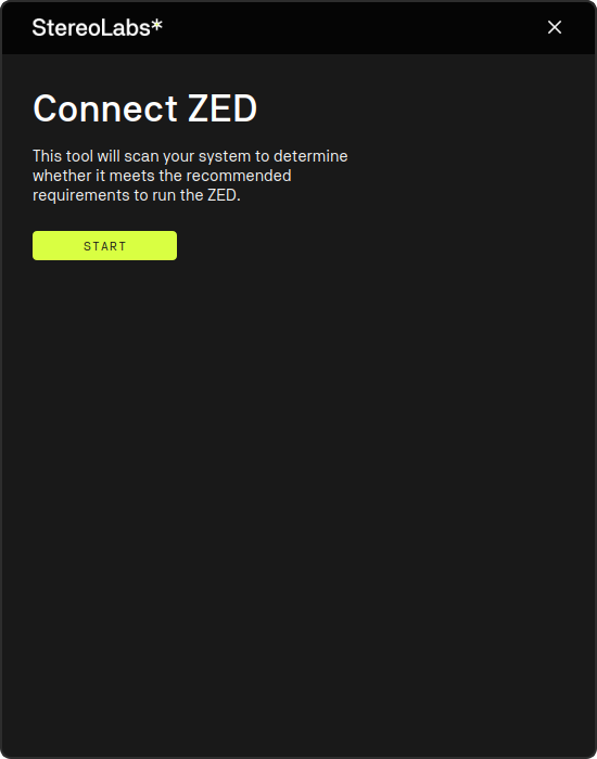

Connect your ZED camera to your computer and launch the ZED Diagnostic tool from the ZED SDK installation directory or through the Start menu (Windows) or terminal (Linux).
  • Under Windows, you can find ZED Diagnostic in the Start menu under the ZED SDK folder. You can also run it from the command line by navigating to the ZED SDK installation directory: C:\Program Files (x86)\ZED SDK\tools\ZED Diagnostic.exe
  • Under Ubuntu, you can run ZED Diagnostic from the terminal by typing ZED_Diagnostic or by navigating to the ZED SDK installation directory: /usr/local/zed/tools/ZED_Diagnostic.
After pressing the Start button, the tool will automatically detect the connected ZED camera and starts gathering diagnostic information.

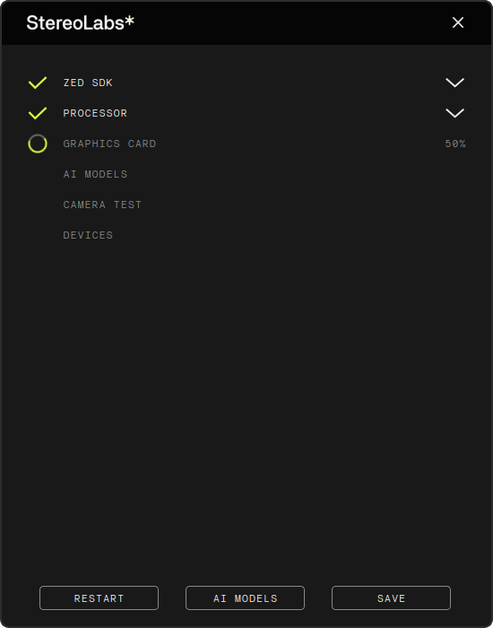

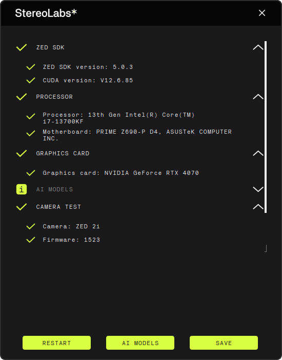

You can monitor the progress of the diagnostic tests in real-time. The tool will perform various checks, including:
  • ZED SDK: SDK and CUDA versions.
  • PROCESSOR: CPU processor model and motherboard information.
  • GRAPHIC CARD: GPU model.
  • AI MODELS: Available AI models and optimization status.
  • CAMERA TEST: Camera hardware tests, including model and firmware version.
  • DEVICES: Connectivity status.

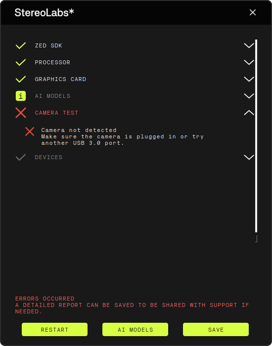

Once the diagnostic process is complete, the tool will display a summary of the results, indicating whether the camera and system are functioning correctly.
In case of any issues, the tool will display error messages and clear diagnostic information.
After the diagnostic process completes with failures, press the Save button to export the diagnostic report as a JSON file. You can share this file with the Stereolabs support team for further assistance. Please email it to support@stereolabs.com and include a detailed description of the issue you are experiencing.

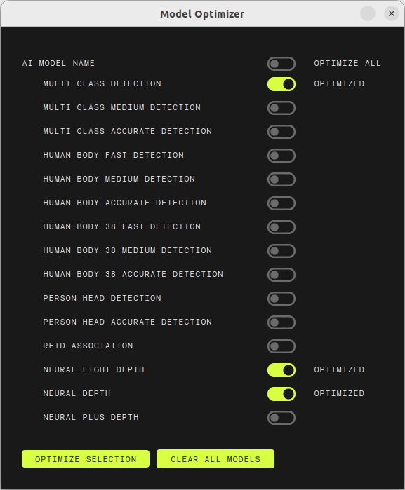

The ZED Diagnostic tool can also help you optimize the AI models used by the ZED camera. This is particularly useful if you have recently updated the ZED SDK or if you want to ensure that the AI models are already optimized before using them with a ZED SDK application.
Click on the AI MODELS button to view the status of the AI models. The tool will display a list of available models and their optimization status.
📌 Note: The AI MODELS button will only be enabled after completing a diagnostic tests.
Once you have selected the AI models you want to optimize, click on the Optimize Selection button. The tool will automatically download and optimize the selected models, ensuring that they are ready for use with the ZED SDK.
You can also click on CLEAR ALL MODELS to remove all downloaded and optimized AI models. This is useful if you want to free up space or reset the optimizations if something is not working properly.
