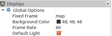

Global options
To be able to visualize the information published by the ZED camera, it is necessary to correctly configure the Global Options:
Key parameters:
Fixed frame: Indicates the name of the frame used as reference for all the other frames. You can select every frame available in the combo box.maporodomare the best choices.Frame rate: The maximum frequency used to update the 3D view.30or60FPS are good values. Available computational power should guide your decision.

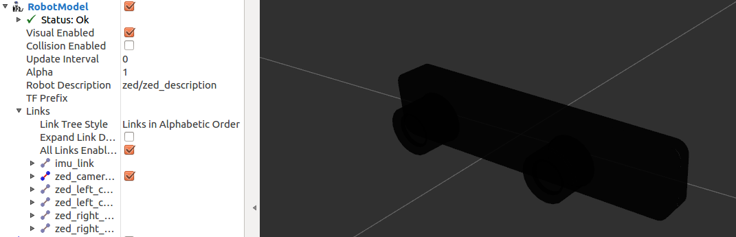

Robot model
This plugin allows you to visualize the Robot Model according to its description from the URDF model.
With the ZED wrapper, you can load two Robot/Camera models for the two StereoLabs cameras: zed.urdf and zedm.urdf
Key parameters:
Visual enabled: Enable/disable the 3D visualization of the modelRobot description: The topic on which the robot description is published. Fromzed_camera.launch:<remap from="robot_description" to="zed_description" />
By expanding the Links item, you can see the whole model tree, with all the joints and the links available and the relative position and orientation in the space relative to the fixed frame.

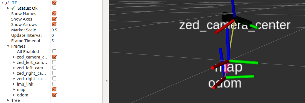

TF
This plugins allows you to visualize the position and the orientation of all the frames that compose the TF Hierarchy.
Key parameters:
Show names: Enable/disable the 3D visualization of name of the linksShow axes: Enable/disable the 3D visualization of the axes of the framesShow arrows: Enable/disable the 3D visualization of the arrows that connect the various framesUpdate interval: The update time in seconds. Leave at0to see each update
Critical to using this plugin is the ability to enable/disable visualizing individual frames. This allows you to concentrate only on the parts that are most important for your current task.
