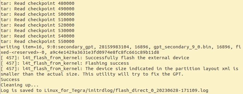

  5. Wait for the operation to complete. You will see the following output if the flash is successful: image

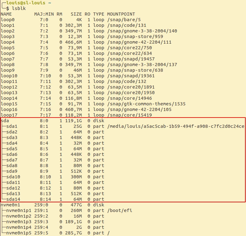

  • Use lsblk to identify the USB disk you want to flash. In the caption below, we can identify that the USB disk ID is sda: image
    Please be careful and use the name of the drive and not the name of a partition. For instance, use sda instead of sda1.
