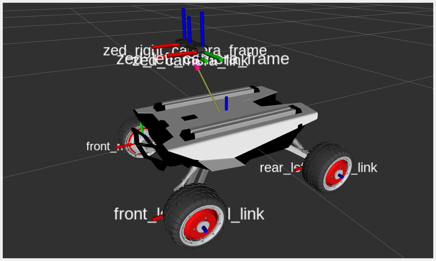

Mono-Camera Configuration
The xacro file urdf/zed_robot_mono.urdf.xacro defines the robot configuration required to obtain the result of the following picture.

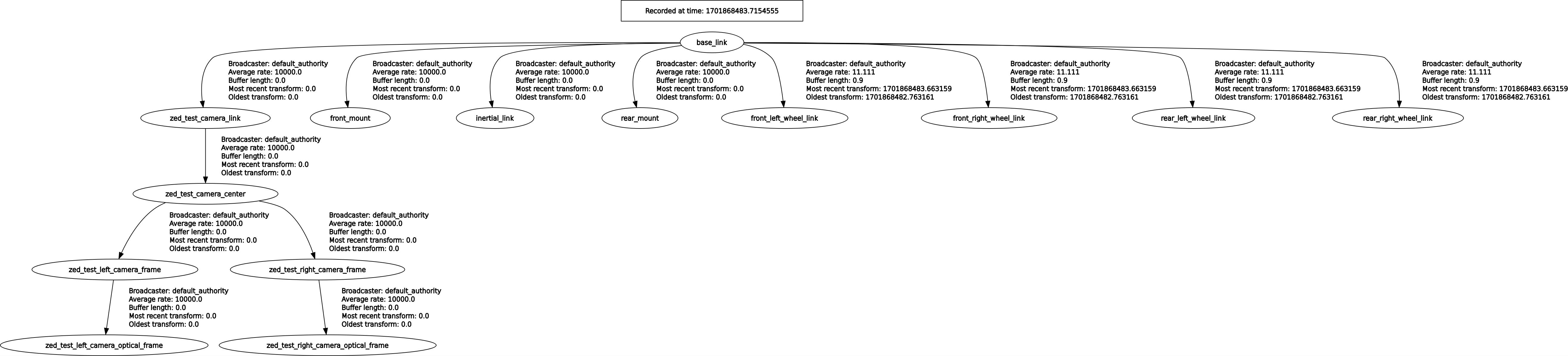

If the parameter use_zed_localization is true, then the frame <camera_name>_camera_link is a parent link, while base_link is a child, and the origin transform reflects this convention.
In this case, the camera is positioned 12 cm ahead of the center of the robot and 25 cm above it, using a camera mount not described in the URDF.
This is the TF tree generated when use_zed_localization is enabled:

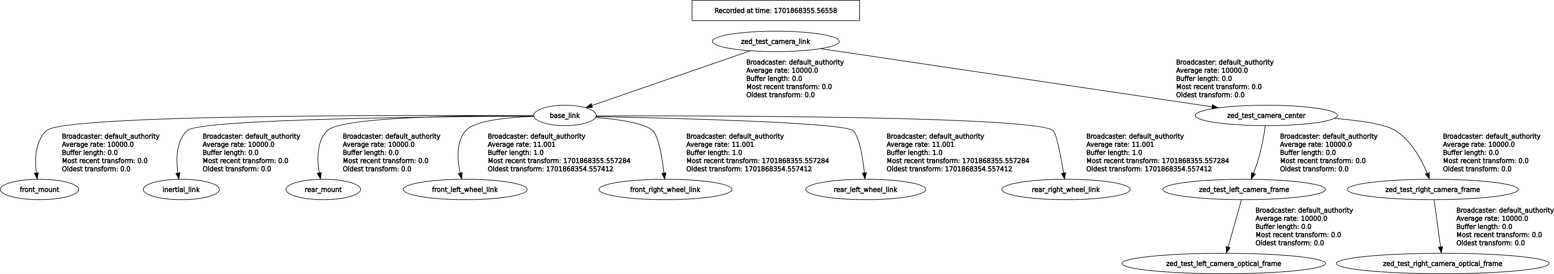

If the parameter use_zed_localization is false, then the frame base_link is a parent link, while <camera_name>_camera_link is a child, and the origin transform is the inverse with respect to the one set in the previous condition.
This is the TF tree generated when use_zed_localization is disabled:

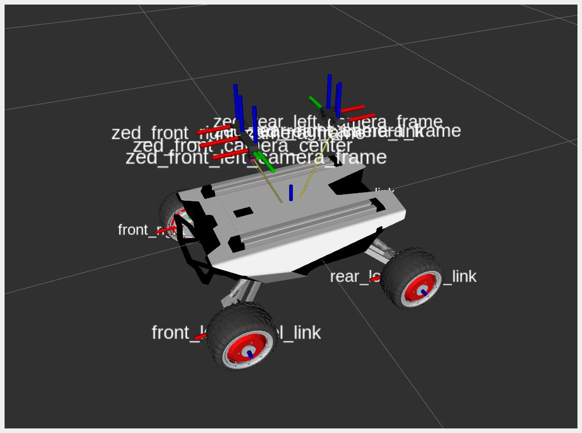

Multi-Camera Configuration
The xacro file urdf/zed_robot_dual.urdf.xacro defines the robot configuration to obtain the result of the following picture in a dual-camera configuration.

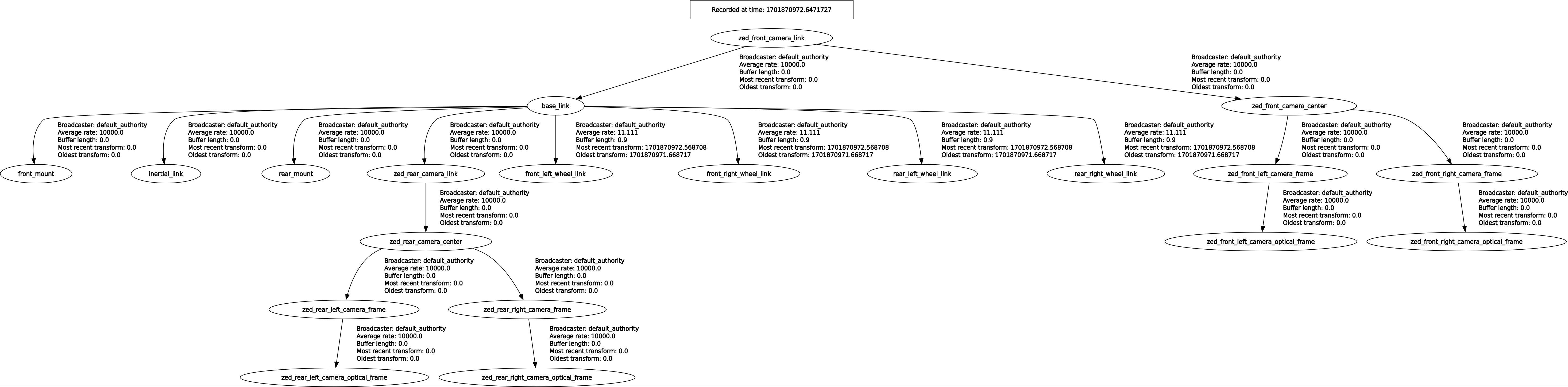

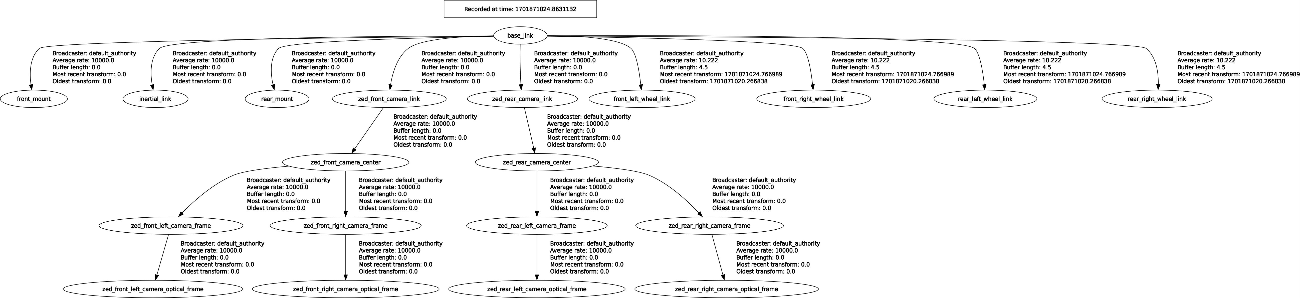

if use_zed_localization is true, only the node of the camera #1 must broadcast the TF and it must set the parameter pos_tracking.publish_tf:=true. The other ZED nodes must disable the TF broadcasting: pos_tracking.publish_tf:=false to avoid conflicts and eventual chaotic behaviors.
This is the TF tree when use_zed_localization is enabled:
This is the TF tree when use_zed_localization is disabled:
