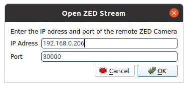

Now that the device is streaming data, you can visualize it live using the ZED SDK tools. Let’s run ZED_Depth_Viewer:
In the top left corner, click on the icon:
The following window will open. Enter the IP of the NVIDIA® Jetson™ device, as well as the port used by the sender (by default: 34000).
After a few moments, you should have a live view of the ZED X One Core cameras streaming from the device!
