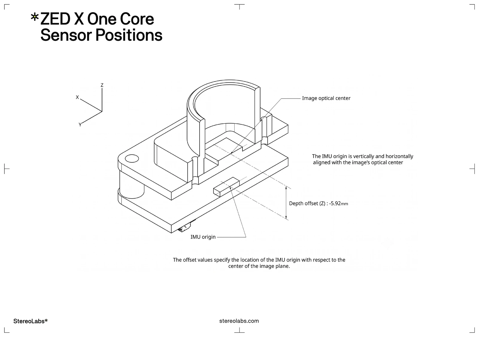

Sensor positions
The IMU origin is vertically and horizontally aligned with the optical center of the image, with a depth offset of -5.92 mm along the Z axis. The offset specifies the location of the IMU origin with respect to the center of the image plane.
ZED X One Core sensor positions

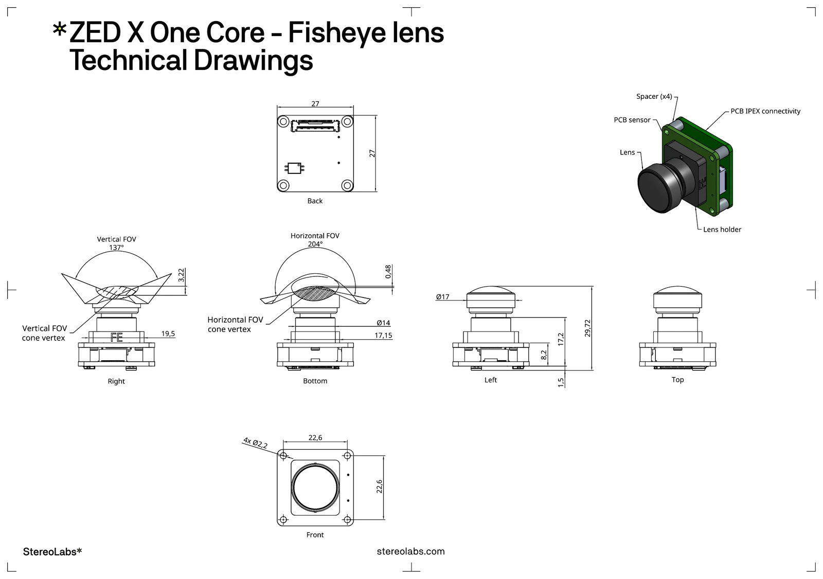

Technical drawings
ZED X One Core fisheye lens technical drawings
